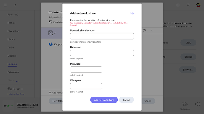

Hi, and thanks! Roon Server is on separate sonictransport, so I Add network Share.
I don’t know what to type in the top line. Can you guide me? Thx.

The folder share settings will tell you the path you have to enter in Network Share Location. Not sure if it makes a difference whether you use the smb:// or \\host format, but as the Sonictransporter runs on Linux (I think) I‘d try smb://. „Host“ is the network name or local IP address of the Windows machine, „Share“ is the shared folder from the Windows machine.

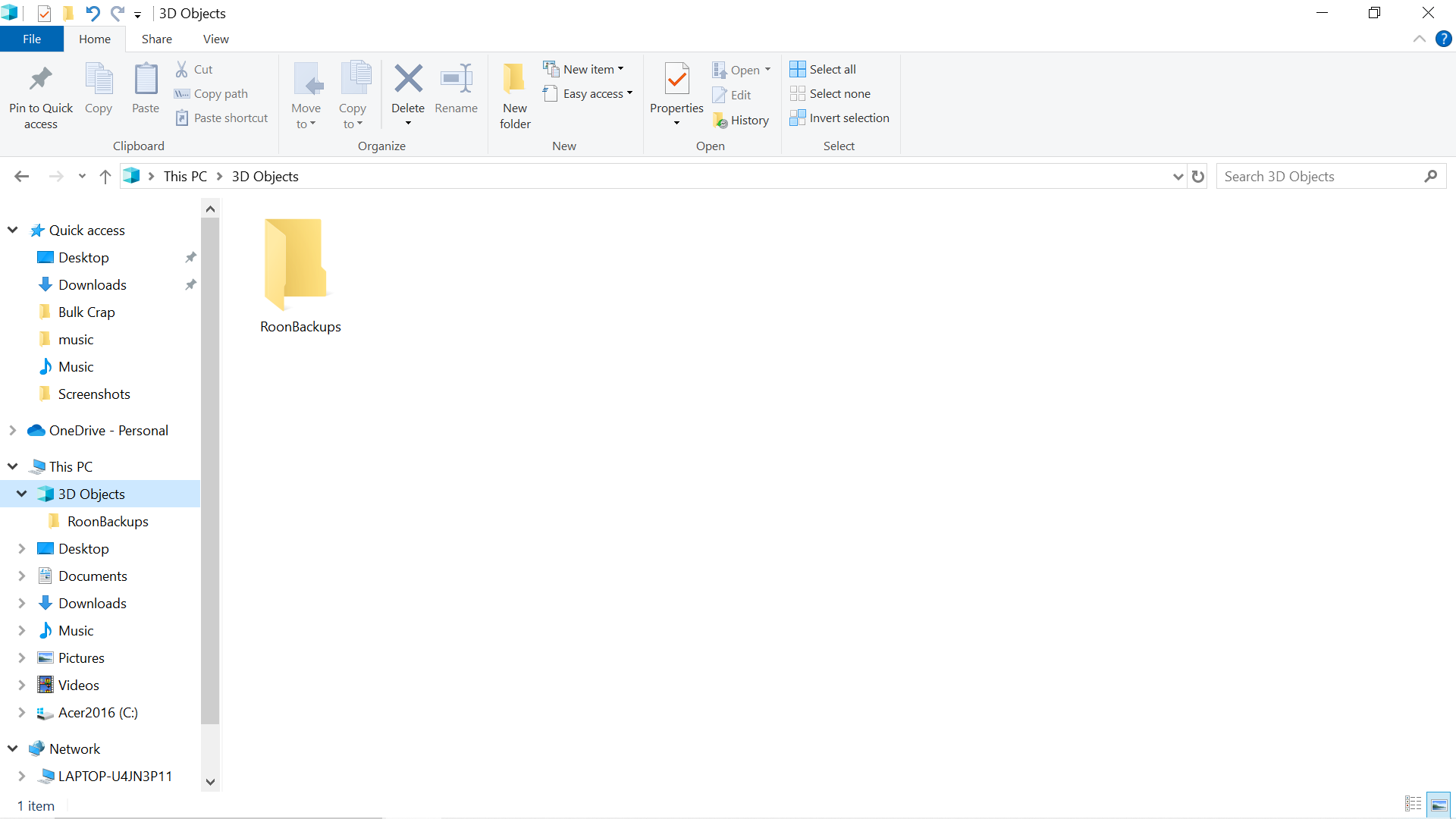

I created a RoonBackups folder and allowed sharing; put the path in the line with and without smb but no backup folder is created.

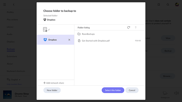

Yes, I used Backup Now to Dropbox yesterday; created a shareable folder, but I failed at filling in the Add Network Share properly. I’ll maybe try it later and be content for the time being with only Dropbox backups.

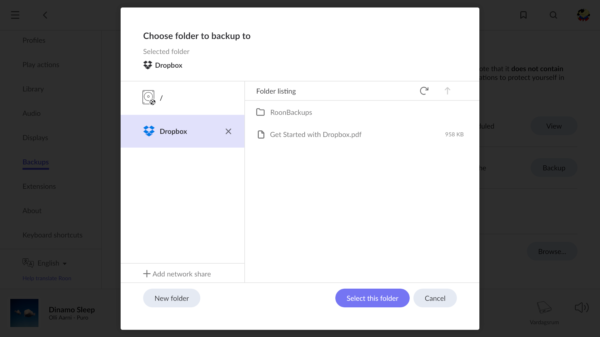

Hi, thanks. So, I should see a new “share” folder on this view, right? Under Dropbox?
If so, then I can’t seem to create it.

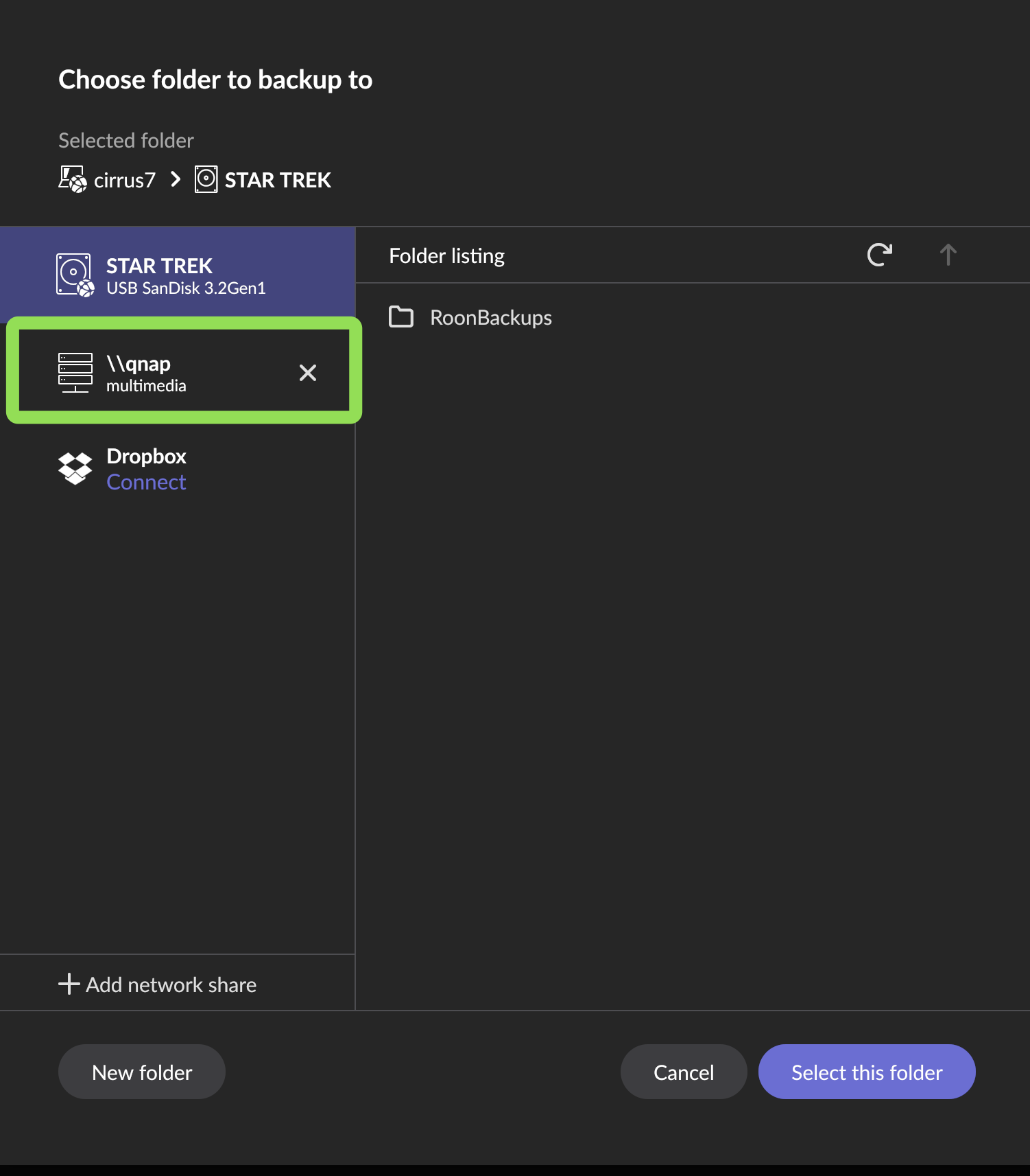

Yes, the shared folder that you created previously on Windows should show up there. This is what I see after Backup Now > Select Location; the \\qnap one is the share from my QNAP NAS:
Did you already try clicking the “+ Add Network Share” in this view?

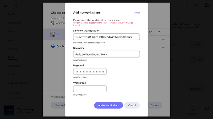

Got it. As said, I failed. Thanks anyway.
I see, missed that. Did you try with the user/password login configuration in Windows as recommended?
These credentials didn’t work. I don’t know what is required in this form.

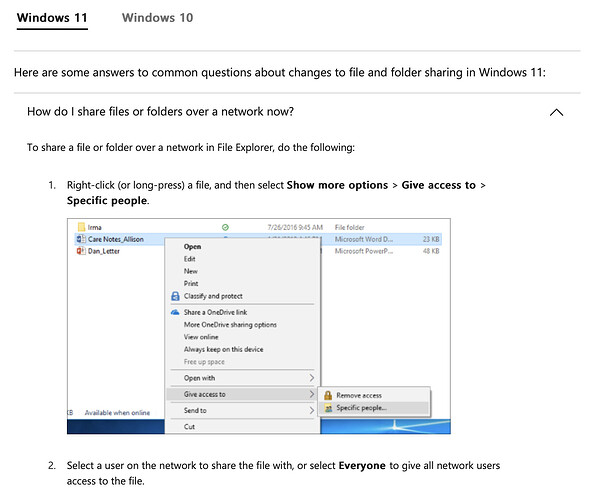

I’m sorry, I am a bit at a loss for what else to tell you… :slight_smile: Let me try again:

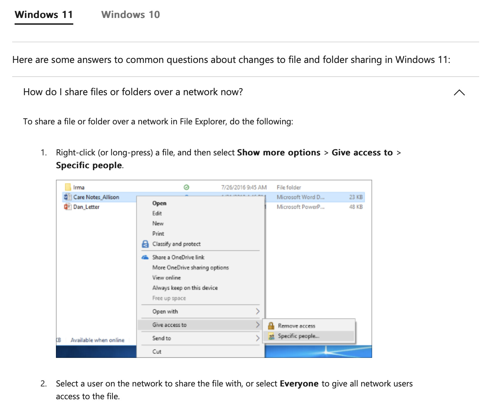

You wrote that you had configured access “for Everyone”. I replied that I don’t think this is a good idea, although Microsoft mentions the possibility on their documentation page, because Microsoft keeps restricting the “for Everyone” access and this keeps causing problems. Therefore, I’d recommended configuring access only for “specific people”. On the Microsoft documentation page, this is this step where it says Show more options > Give access to > Specific people:
You can then probably choose your own Windows username. Then use the same username and password when you do the “Add Network Share” in Roon.

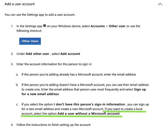

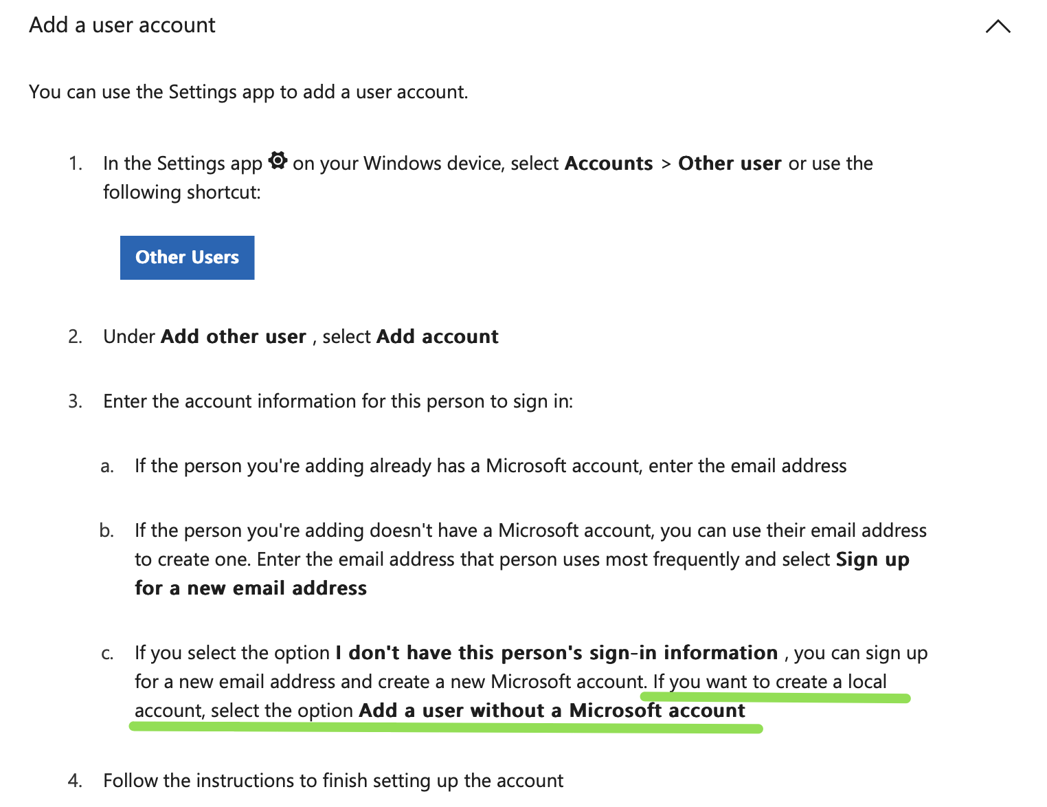

However, note: It is possible that you only created a “Microsoft account” (aka "online account) for yourself in Windows. The username of a Microsoft account is an email address. It is possible (not 100% sure but I believe so) that this does not work as a user account for SMB. In this case, you may have to create a “local account” in Windows. This is described here:
That is, the part that I underlined in green here:
The local account will have just a normal username (no email address). This one should definitely work for SMB access.

As @Suedkiez said, you can’t use a Microsoft Account (which has the format of an email address) to access a Windows Shared Folder via SMB.
You need to use either your local Windows user account as the username, or do as I did - create a local Windows account specifically for Roon.
To find out what your local Windows user account is, open the Command Prompt app and type whoami at the prompt and press Enter. The result will be:
your computer name\your local account name
The use your local account name together with your Microsoft Account password in the Add Network Share fields in the Roon screen.

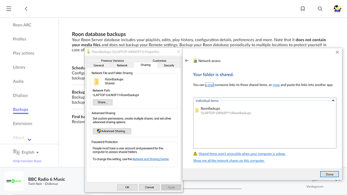

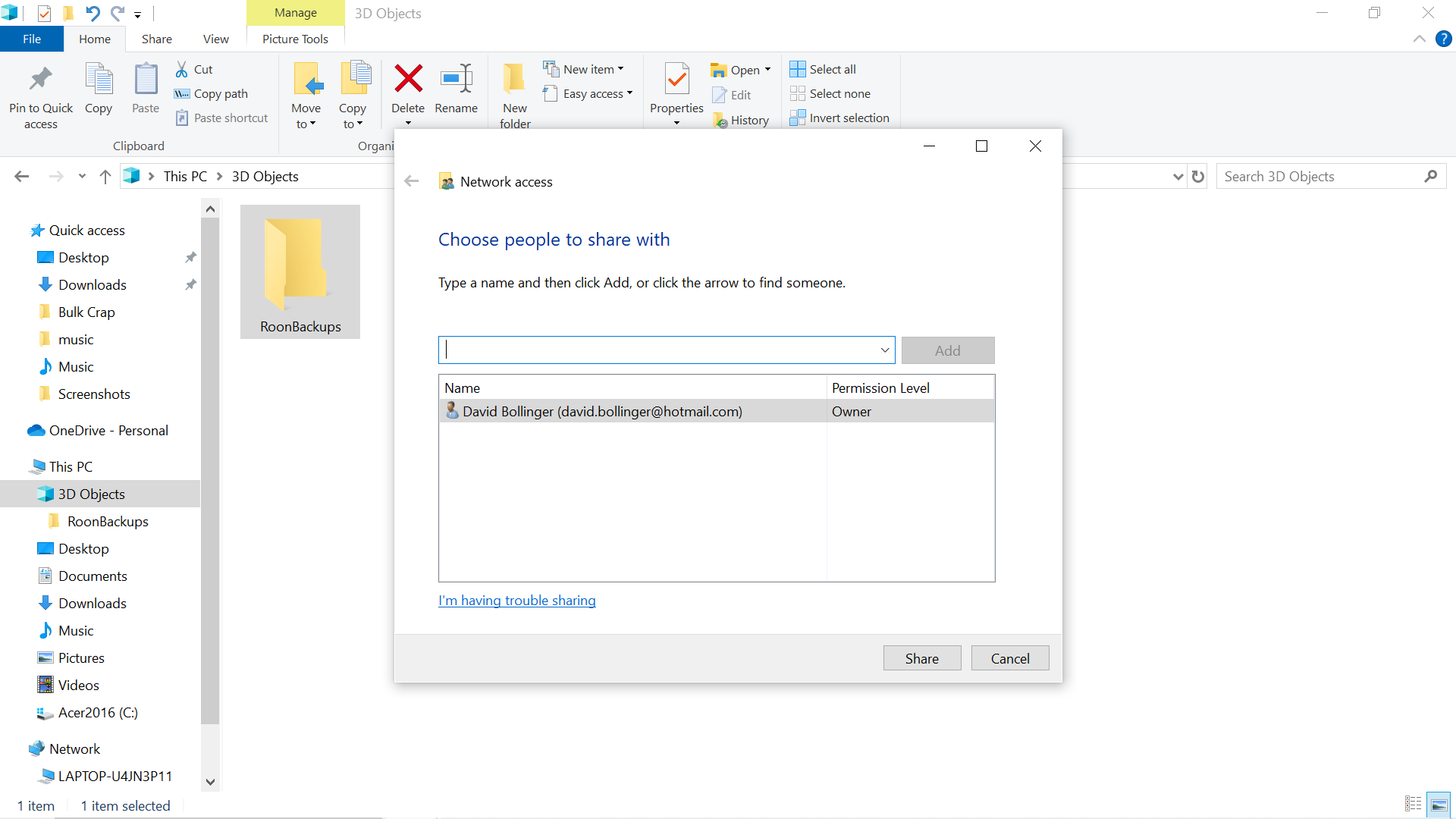

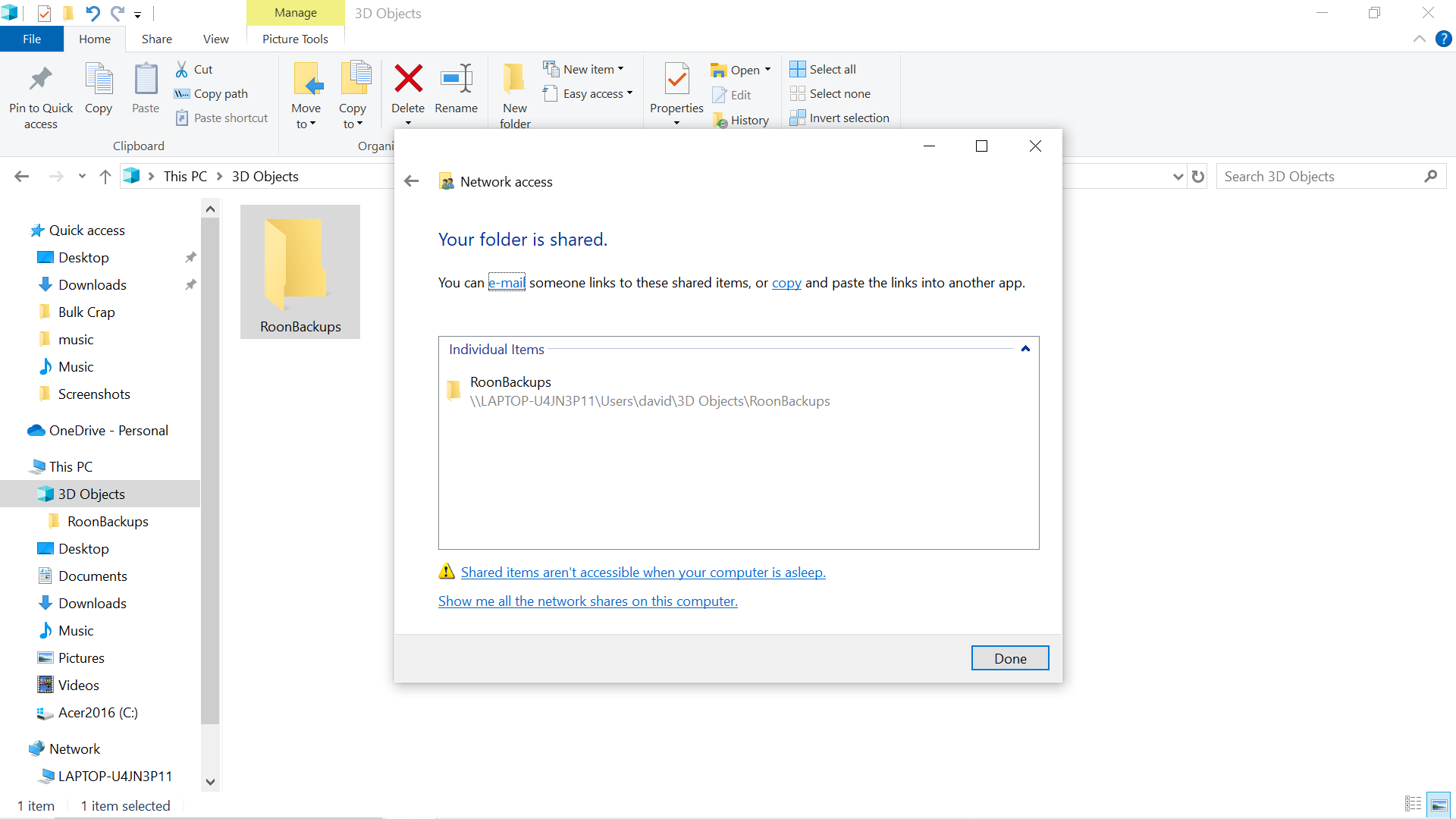

Thanks all. I have a piece of brain stuck in my head. Here’s what I’ve done so far:
  1. Created a folder
  2. Given access to myself
  3. There’s the path

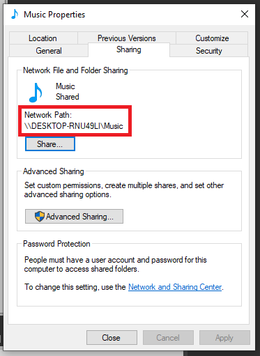

Now I go to add network share and…what do I type in Network Share Location? Username? Password?
Windows credential?
The network share location is given in the properties of the shared folder in Windows:
(Screenshot from https://help.roonlabs.com/portal/en/kb/articles/faq-how-do-i-create-a-shared-folder-on-windows-and-add-it-as-a-watched-folder-in-roon )
The username and password are the Windows username and password of the Windows user to whom you have given access rights in the shared folder configuration.
Don’t forget that you need to use the username of your local Windows account - not your Microsoft Account…
