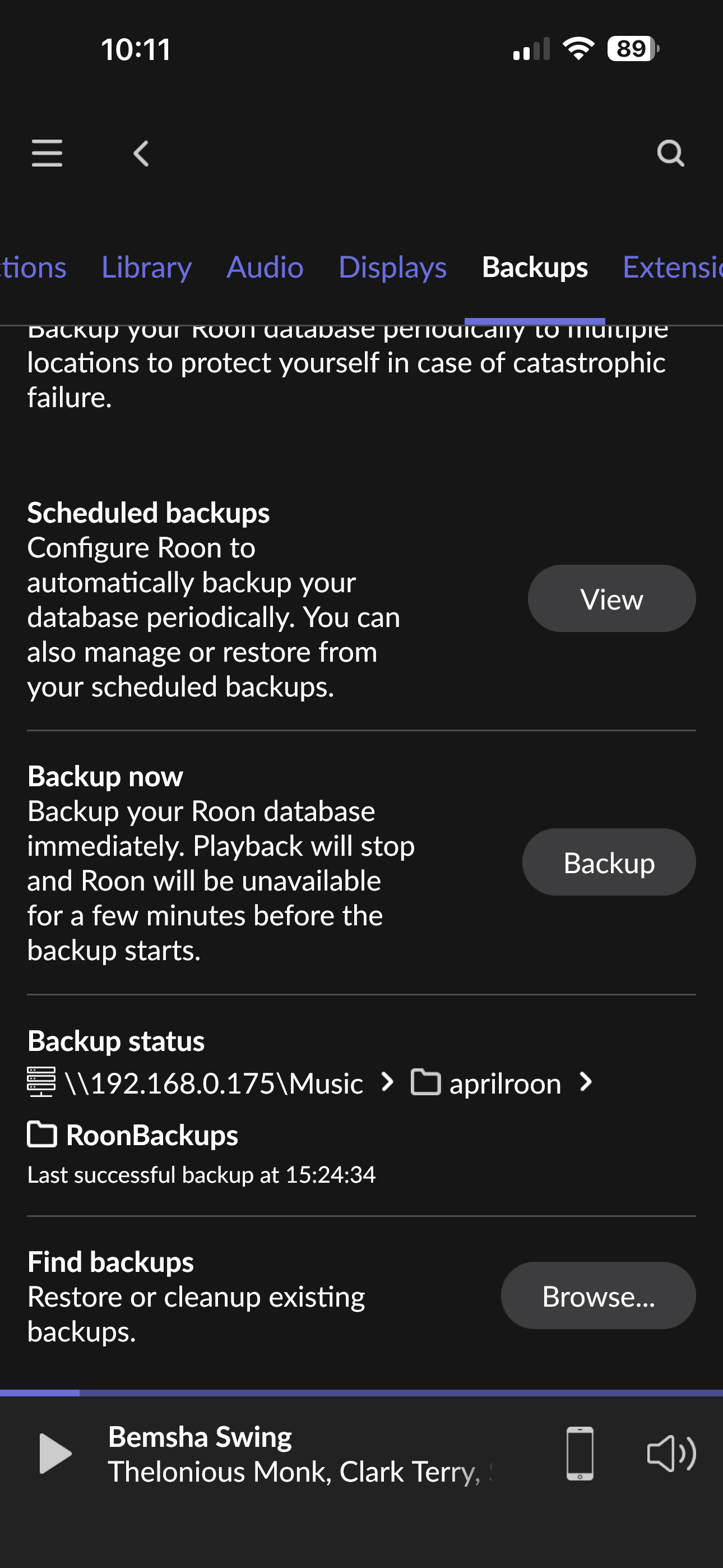

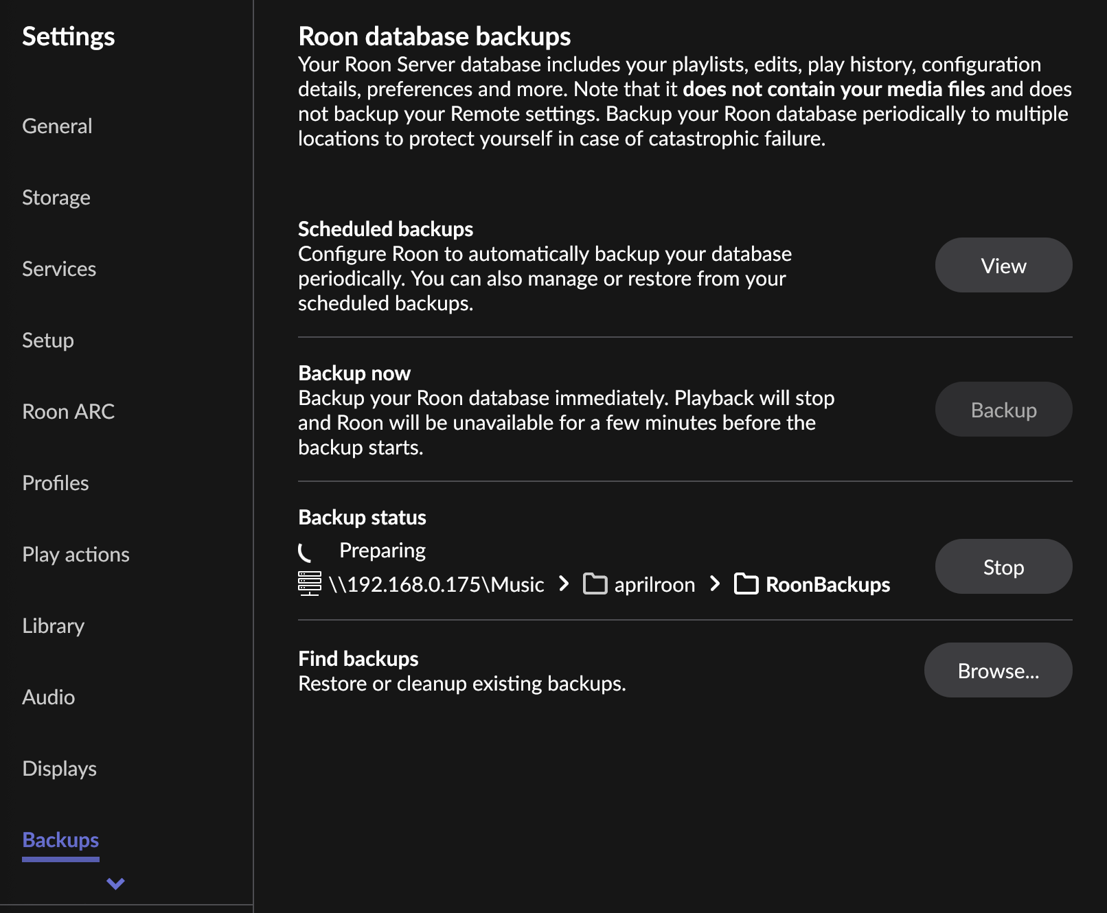

Interesting that you say that ….. my drives are Seagate Iron Wolf 12 TB 3.5” Internal HDD’s. The ironic thing is that on my Mac Book where I set this all up it shows that wheel spinning. If I look on phone it says the last backup to this newly created file was yesterday at 3:24 PM.
Top pic MacBook currently. Bottom pic iphone currently.

Hmmm, I don’t know. It’s weird that it shows two different states on the two remotes. There is a strong recommendation to have the Roon database on an SSD, not spinning drives, but I don’t know what kind of effect this has on backup preparation times.

I just called Synology and took them through this. He said that the discrepancy is due to the different devices. Basically, the iPhone is telling me that I did back it up yesterday at 3:30. The MacBook, being more detailed, is telling me that it is still backing up. He said it is normal for a backup like this to take a day or so. So far I have about 1.74 GB backed up and 7000 files/folders. There really is no meter to tell me when it is 100% backed up, and he said to check back in several hours to see how much is backed up and if it is stuck there, give them a call back. Thanks for your help again. @Suedkiez
I doubt that. Everything happens on the server and the phone and Mac apps are just remotes. They should be getting the same state to display sent from server, I would think.
