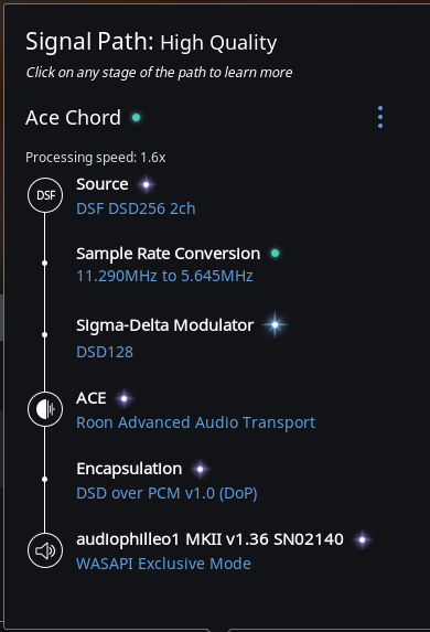

Windows 10 -> WSAPI -> Audiophilleo 1 MkII -> Chord Hugo
Still it shows unidentified device and all available options are same as Setup 1.
I wonder is there anyway to enable those “hidden” option manually in order to make these “unidentified” devices are working on their full capabilities?
This is the signal path from my Setup 2 and basically Setup 1 is similar to this.
Sorry I just realized that my Setup 2 should be good now because both my audiophilleo1 and hugo are supporting up to DSD128 now. But the Setup 1 is still a question mark.
