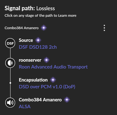

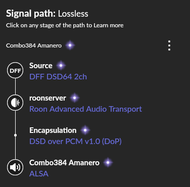

Please share the signal path.

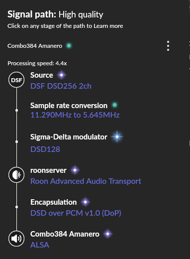

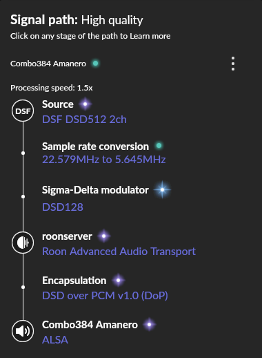

Here you go.
======Normal lossless playing======
截屏2023-03-29 11.40.33
截屏2023-03-29 11.40.50

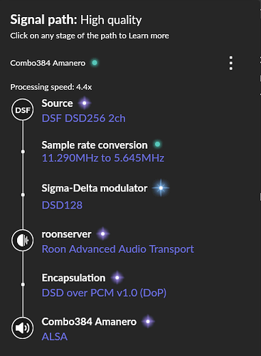

======High Quality Playing (Down-streaming)======

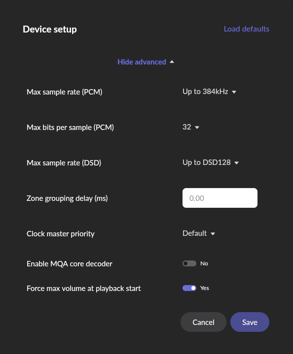

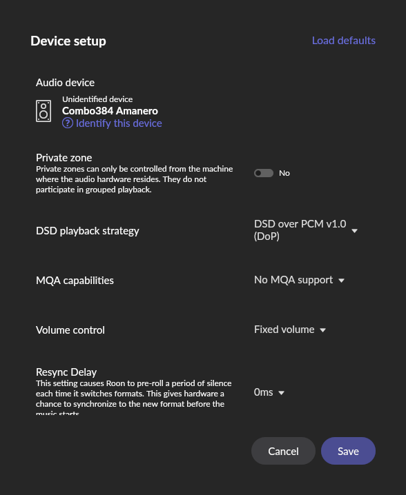

======Device Setup======

Hi @alon_cheng, sorry if get in.

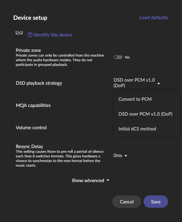

Screenshot 2023-03-29 at 09.16.00
Why do you have selected DoP and not Native?
Because there is no such option. The last one “Initial dCS method” doesn’t work when I selected it.

As @Traian_Boldea says, you’re limited to DSD128 because you’re using DoP, i.e., there isn’t sufficient bandwidth over PCM for anything higher.
On Windows, there is driver support for native DSD. However, I suspect the DAC converts DSD to PCM anyway, so I wouldn’t be overly concerned.

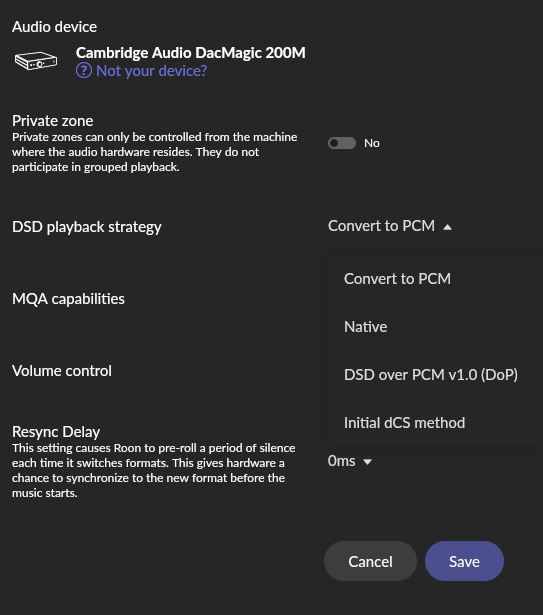

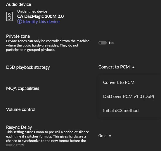

So I did a bit of research. Not for your dac as I do not have how to test. For my 200M that with default ubuntu install only works on DoP. Reading around I’ve found that volumio might have the right kernel installed by default for the CA 200M. So pulled out my old old white MacBook that now has volumio on it.
And on volumio with roon bridge I have full specs for 200M
Screenshot 2023-03-29 at 22.57.25
