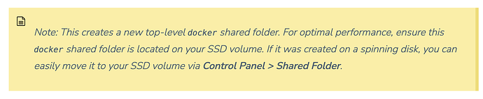

Step 1: Installing Container Manager

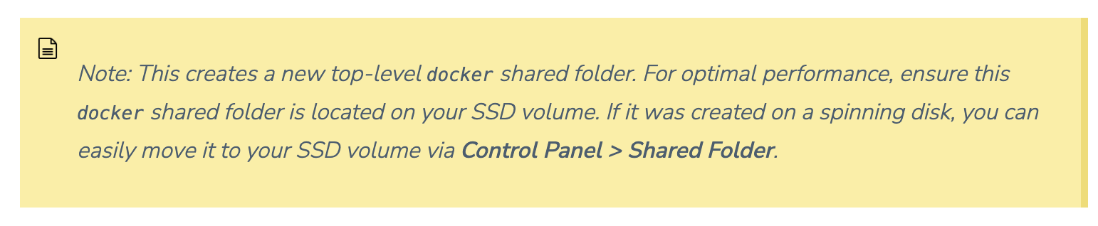

When installing Synology Container Manager, accept all the defaults.
This creates a new top level “docker” shared folder. You will not be employing this folder at all in the setup I am about to describe.

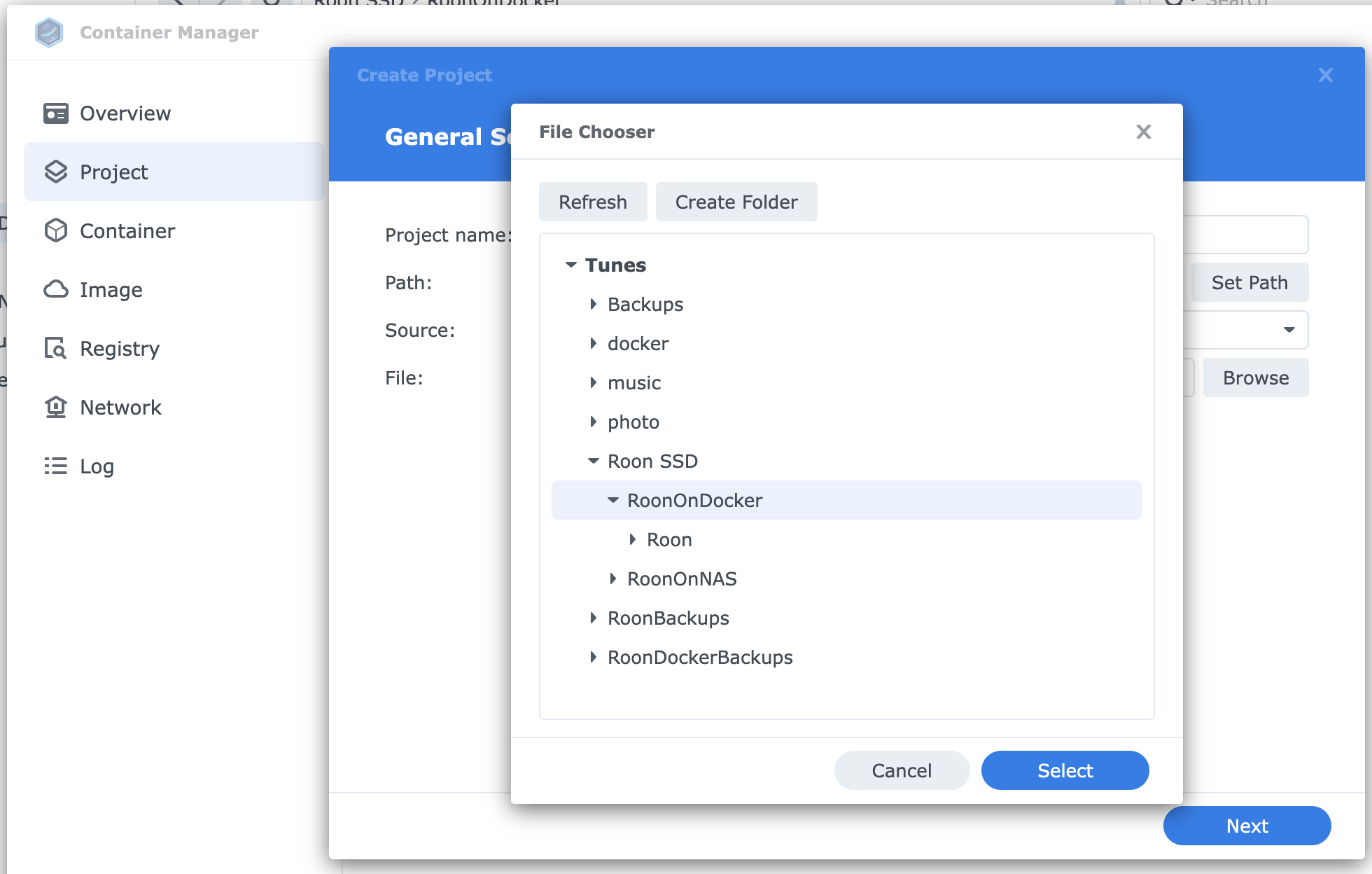

The instructions at Method 1: DSM 7.2 or later (Using Container Manager Projects) don’t specify the following, but in the defaults on RoonServer Docker Configuration Generator, the setting for /Roon will map to /volume1, which is likely not your separate SSD.
So, in File Station, create another folder on your SSD volume that is a peer of your existing RoonOnNAS folder. Call it something like RoonOnDocker. In there, create a subfolder called Roon. Then change your setting in the configurator to point to this folder, e.g.:
/volume2/Roon SSD/RoonOnDocker/Roon
This will create a setting on the right that looks like this (if you have spaces in any of your volume names, like I do, it will add quotes around things):
“/volume2/Roon SSD/RoonOnDocker/Roon:/Roon”
Note that it will still need the Shared Folder to be referenced (in this case Roon SSD) in addition to the subfolders you’ve created.

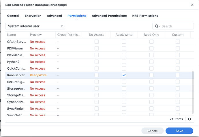

Step 4: Pre-setting your new backups folder
You probably have a dedicated shared folder where your Roon backups live. On mine, this was a shared folder called RoonBackups. Because most of your old backups will not be useful in your new environment, create a new shared folder for your new backups (this is where the backup you create in step 2 of Migrating from a Native Installation will go).
I called mine RoonDockerBackups. It is also a top-level shared folder off of /volume1.
You must configure this so that RoonOnNAS can write its final backup to this folder: In File Station, select this new share, click the “Edit” button, click on the “Permissions” tab. Then, under the dropdown that defaults to “Local Users,” select “System Internal User.” Scroll down to where you see “RoonServer” and click the “Read/Write” checkbox, then hit “Save.”

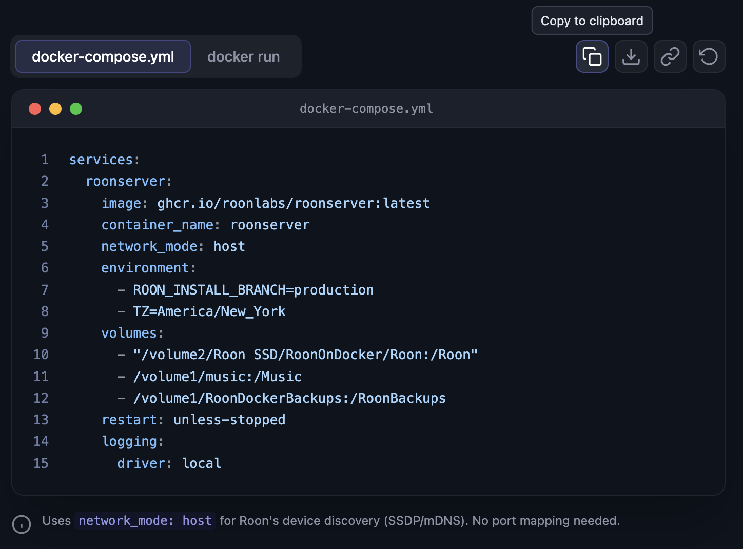

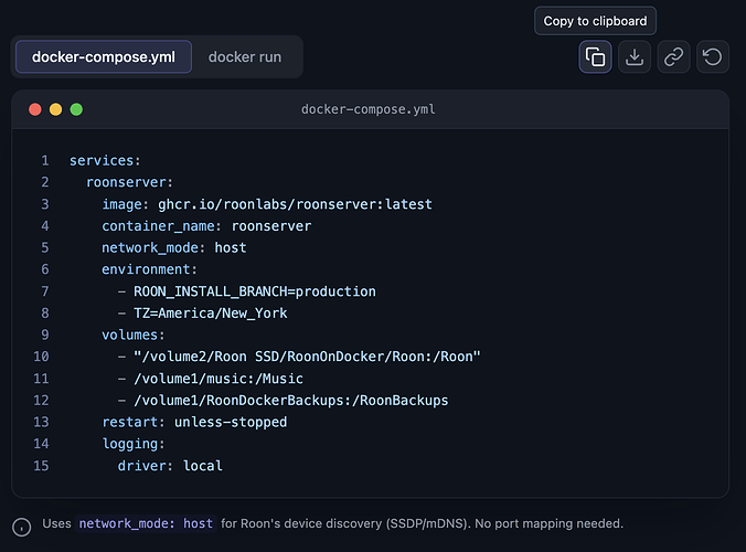

Step 5: Create your “docker-compose.yml” file using RoonServer Docker Configuration Generator
Follow the basic steps for creating the configuration file for your Roon-on-Docker installation. You will use RoonServer Docker Configuration Generator per the instructions at Installing RoonServer on Synology with Docker under the heading “Method 1: DSM 7.2 or later (Using Container Manager Projects)”

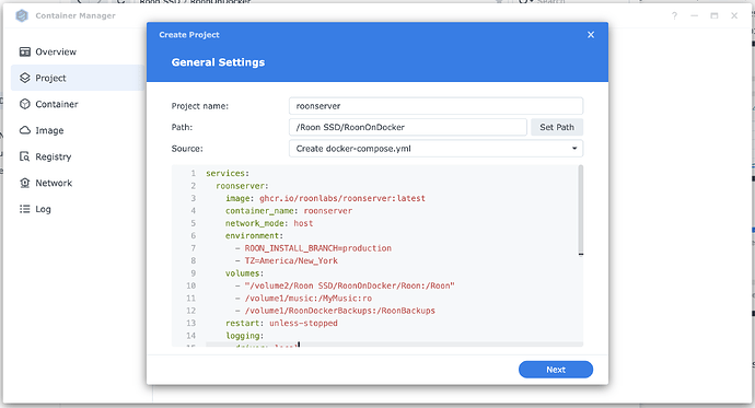

Step 6: Create Your Docker “Project” and Get Roon Server Running

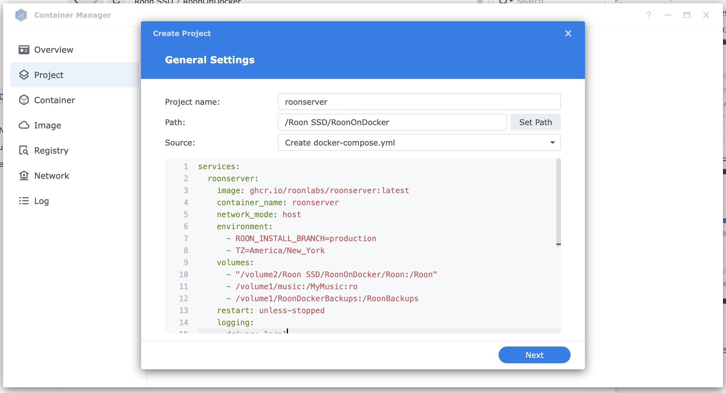

In Container Manager, after selecting Create Project and giving it a name (e.g., roonserver), you must select the outer folder (e.g., RoonOnDocker) you created on your SSD volume using the Set Path button.
Once you have copied the docker-compose.yml contents that you created in Step 5 to your computer’s clipboard…
…go back to “Create Project” and switch “Source” from “Upload docker-compose.yml” to “Create docker-compose.yml” which will enable pasting per the instructions.
Next, paste the contents of your clipboard into the little text field as follows:
IMPORTANT — MEGA IMPORTANT — and illustrated above:
Modify this line:
- /volume1/music:/Music
So that it looks like this:
- /volume1/music:/MyMusic
If you really don’t want to use the one or two Roon features that allow you to make modifications to your music collection, append “:ro” to the end of that line to make this directory “read only”:
- /volume1/music:/MyMusic:ro
Skip the “Web Portal Settings” screen - simply hit “Next”
On the last screen, hit “Done.”

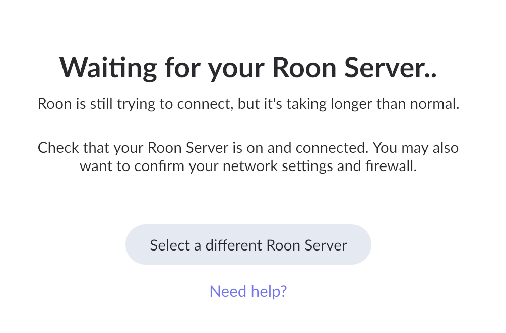

Once your Docker container is running, launch your Roon desktop application, which will likely have a screen reporting that it’s Waiting for Roon Server, like this:
Press “Select a different Roon Server” - it should bring you to a place with a green “Ready” icon once your new Docker-based install is ready.
Press "Connect.”
Unfortunately, you may have to quit the application and relaunch it a few times and hit Connect each time until you get to the next part…

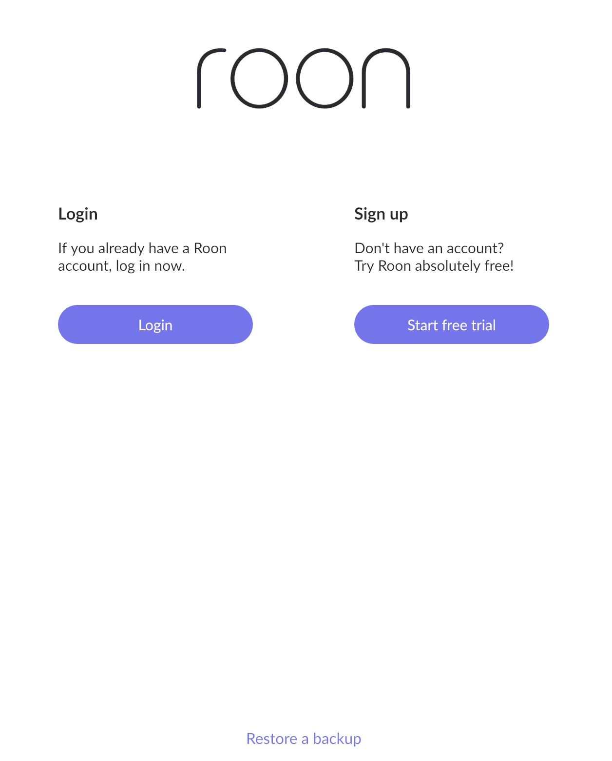

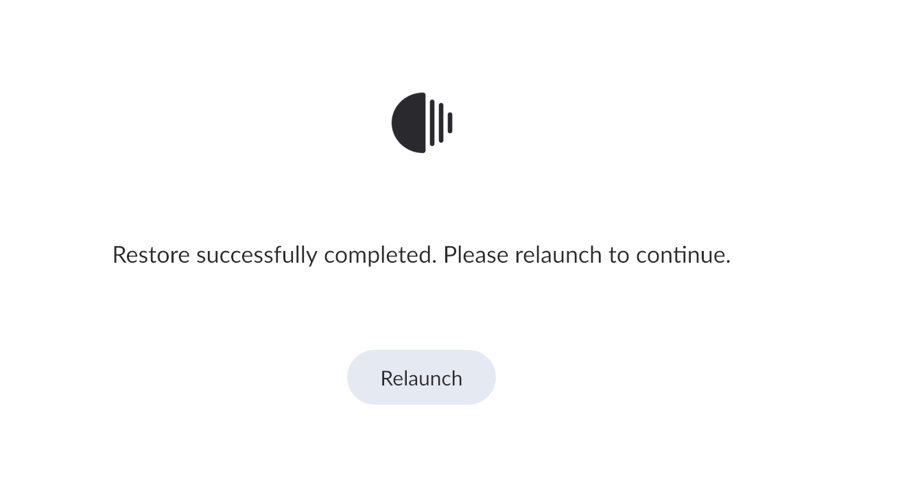

Eventually after you hit connect, you should get a screen that has a “Restore a backup” link at the bottom, almost hidden. Select this.
After that, you will have to hit Relaunch to continue:
This may seem to bring you to a dead-end, so just be patient. You may watch your server status turn red and green for a bit.
If you get into a cycle, just quit and restart the desktop application until you see this screen again:

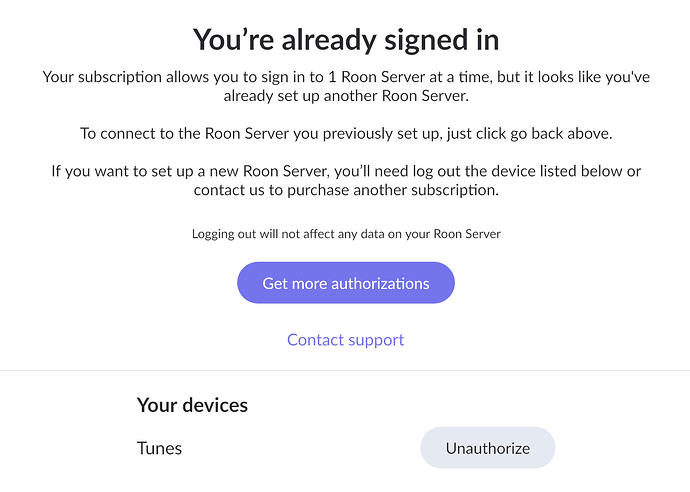

This time, though, instead of selecting "Restore a backup,” select "Login.”
After you finish logging in via your web browser, there is a button to go back to the Roon desktop application. When you do, you may find the jellyfish spinning. That’s OK. Be patient. After a few minutes, you should get the “You’re already signed in” screen you see below.
Hit “Unauthorize” for your old Roon Server.

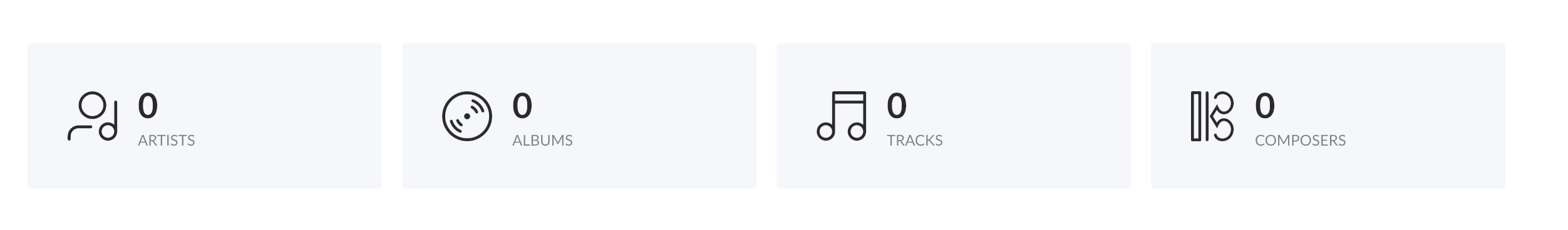

Now, you will get the screen showing you have nothing in your collection
DO NOT FRET. The magic happens in the next step.

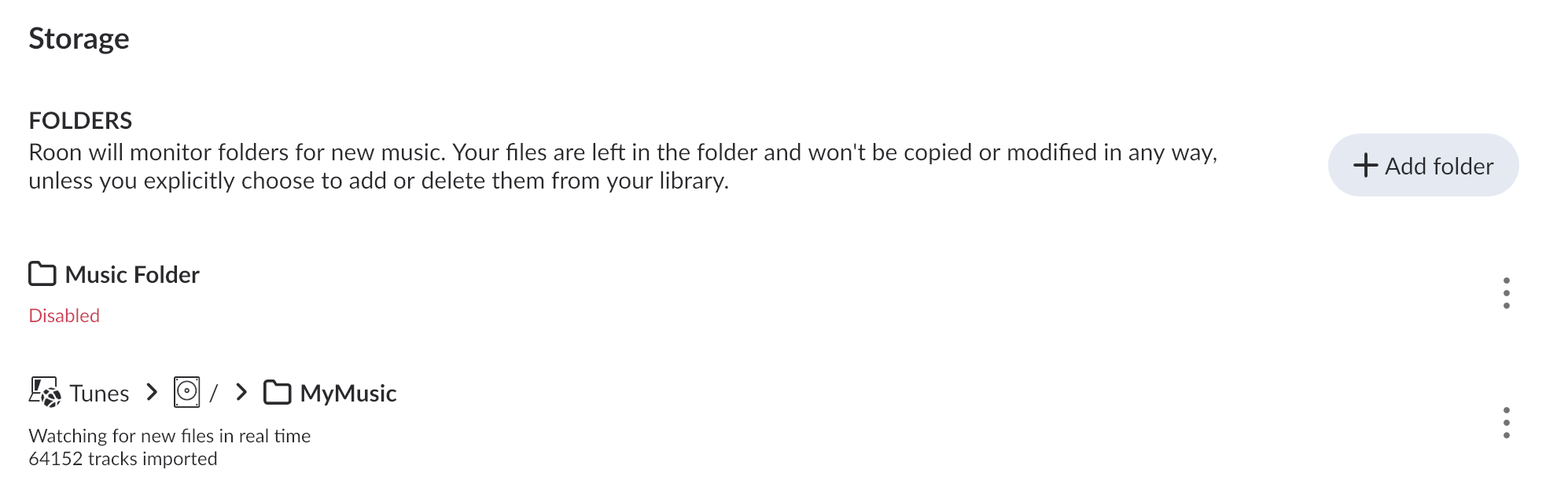

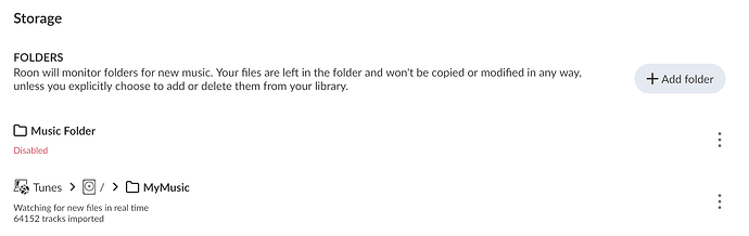

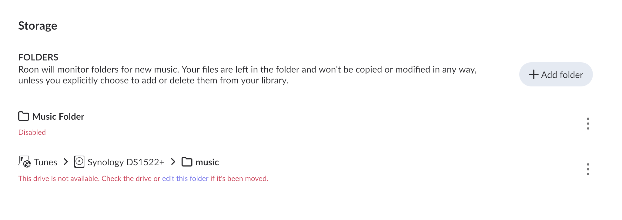

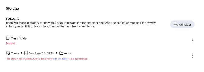

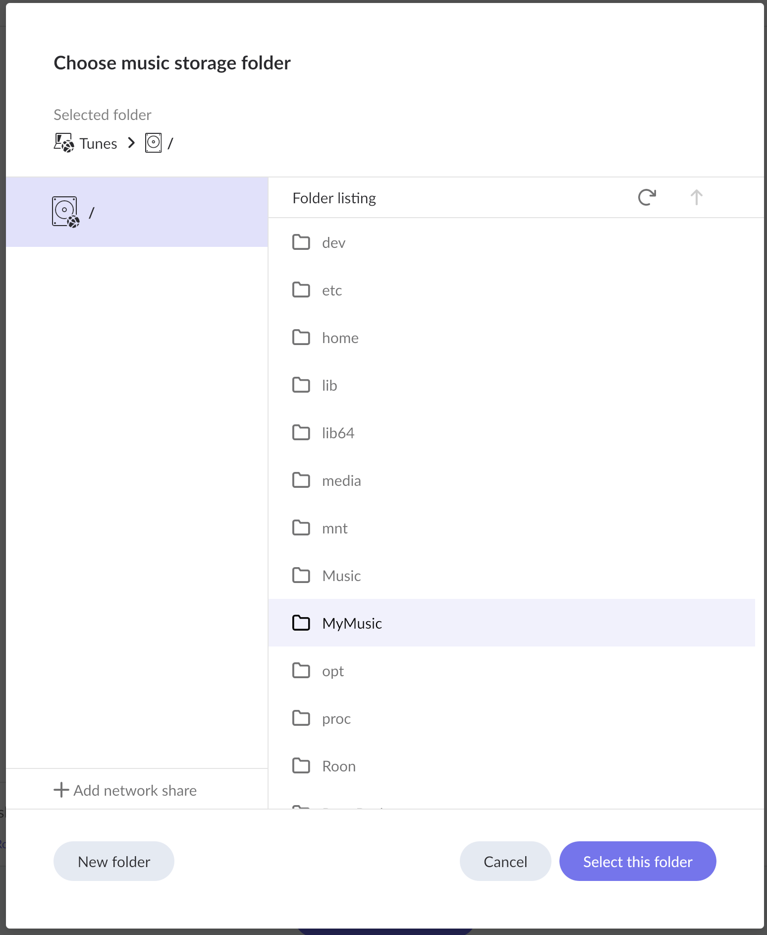

Go to Settings > Storage, and go to your previously disabled storage location. Press the three dots icon to the right, and select “Enable.”
From there, you will see a notice that the drive is not available, with a link to “edit this folder”.

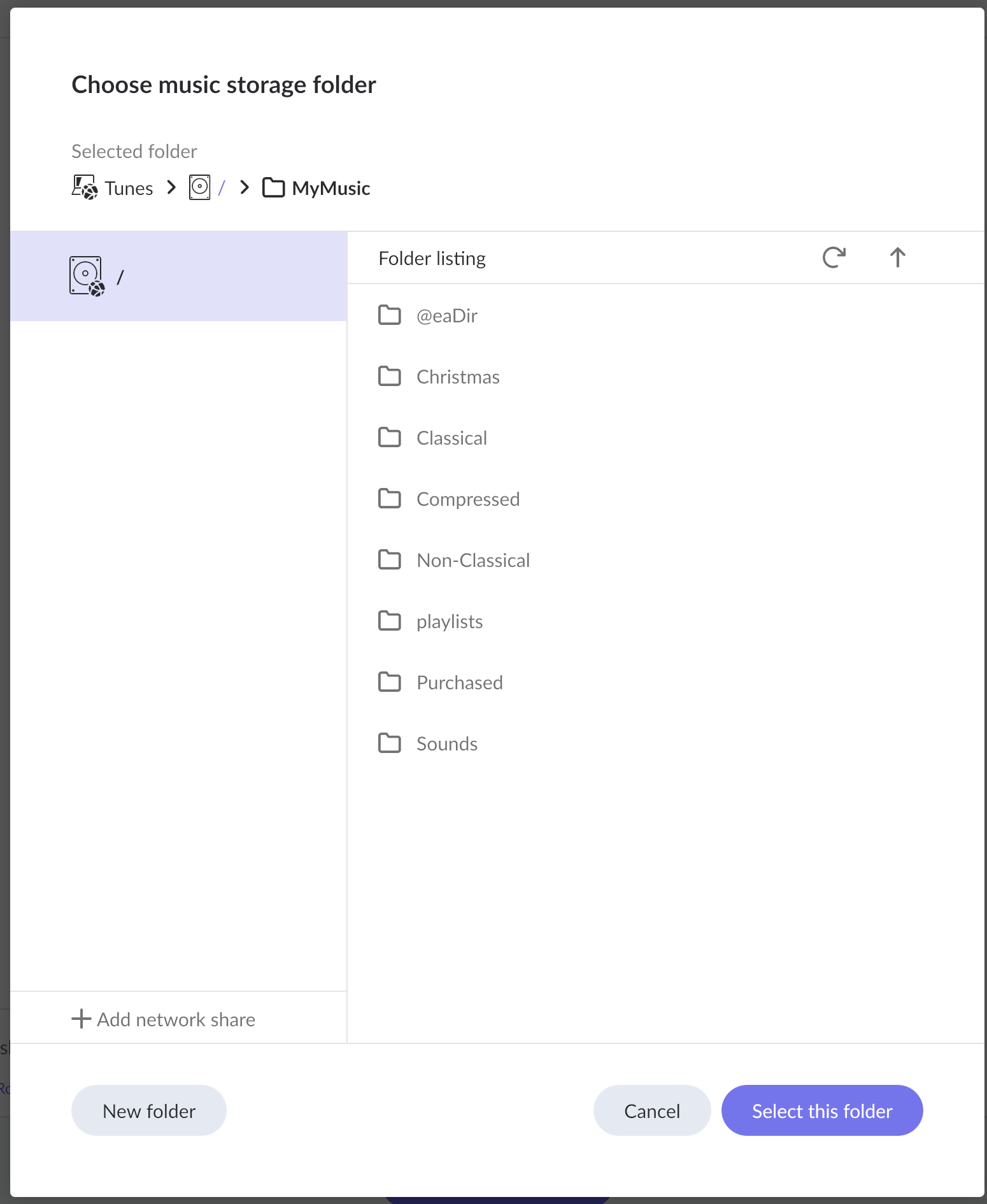

Click “edit this folder” and then in the dialog box that appears, select “Browse…”
Find “MyMusic” and click on that.
You should see your music folder in there! Hit “Select this folder” then on the next box that appears, hit Save.
Then Roon will begin to scan your music collection just like it does with a normal reboot.
There will be a music location in Settings > Storage called “Music Folder” - use the … menu to set it to “Disabled” - it plays no role in this sort of environment.

Appendix: Here is my YAML file, for reference
services:
  roonserver:
    image: ghcr.io/roonlabs/roonserver:latest
    container_name: roonserver
    network_mode: host
    environment:
      - ROON_INSTALL_BRANCH=production
      - TZ=America/New_York
    volumes:
      - "/volume2/Roon SSD/RoonOnDocker/Roon:/Roon"
      - /volume1/RoonDockerBackups:/RoonBackups
    restart: unless-stopped
    logging:
      driver: local

  1. Folder Renaming: Great question. The container’s built-in “Music Folder” storage area seems to have some logic baked in to associate with a mapped folder called “Music.” The problem is, when trying to use this mapping after restoring from a backup, it scans the user’s music collection as if it’s all-new. After playing around for a bit, @gTunes came up with an idea to use a folder name other than “Music” to avoid any potential of conflicting with the baked-in logic. In theory, pointing my Step 7 to the Music folder — if that was specified in the YAML mapping — should work, but we wanted to avoid messing with any of the built-in logic.
    I suggest that having the baked-in “Music Folder” in the package is great for new Roon users, but not a great idea for people migrating. It would be great for the configurator to offer some options on this front if possible, although I know it might be a stretch…

I’m guilty as charged, and did install container manager on my volume2 SSD - it seems to be fine, but would it be recommended to move it to volume1 (spinning disks ) and start over? If Roon is the only container being used with it, does it matter?

I opted for installing the complete container on a solid-state volume, separated from the standard /Container/ folder, which worked well with the correct share path in docker generator.

Per above, this cannot be moved after install. There is no reason to worry about it. Just install Container Manager on /volume1, leave the /docker share empty and then just define the SSD paths in the configuration utility.
Second, I recommend doing a bit of URL handholding in your links - the configurator, if I can call it that, accepts parameters, so send Synology users to RoonServer Docker Configuration Generator.
Third, the instructions are still missing the step to switch “Source” from “Upload docker-compose.yml” to “Create docker-compose.yml”
Other than that, at first glance, it seems you have put in some very useful items from my instructions, but I don’t have the luxury today or in the foreseeable future to test these revised instructions first-hand (not to mention that I am all set for now and after doing 6 or so full migrations yesterday, I am ready to let my music play…) My recommendation is to get a Synology unit and walk through this yourselves, most especially testing the path I have to migrate from Roon on NAS, which seems to present unique challenges that I think our combined instructions manage to cover for now. Thanks for doing this.

You found a YAML bug! Nice! :slight_smile:
