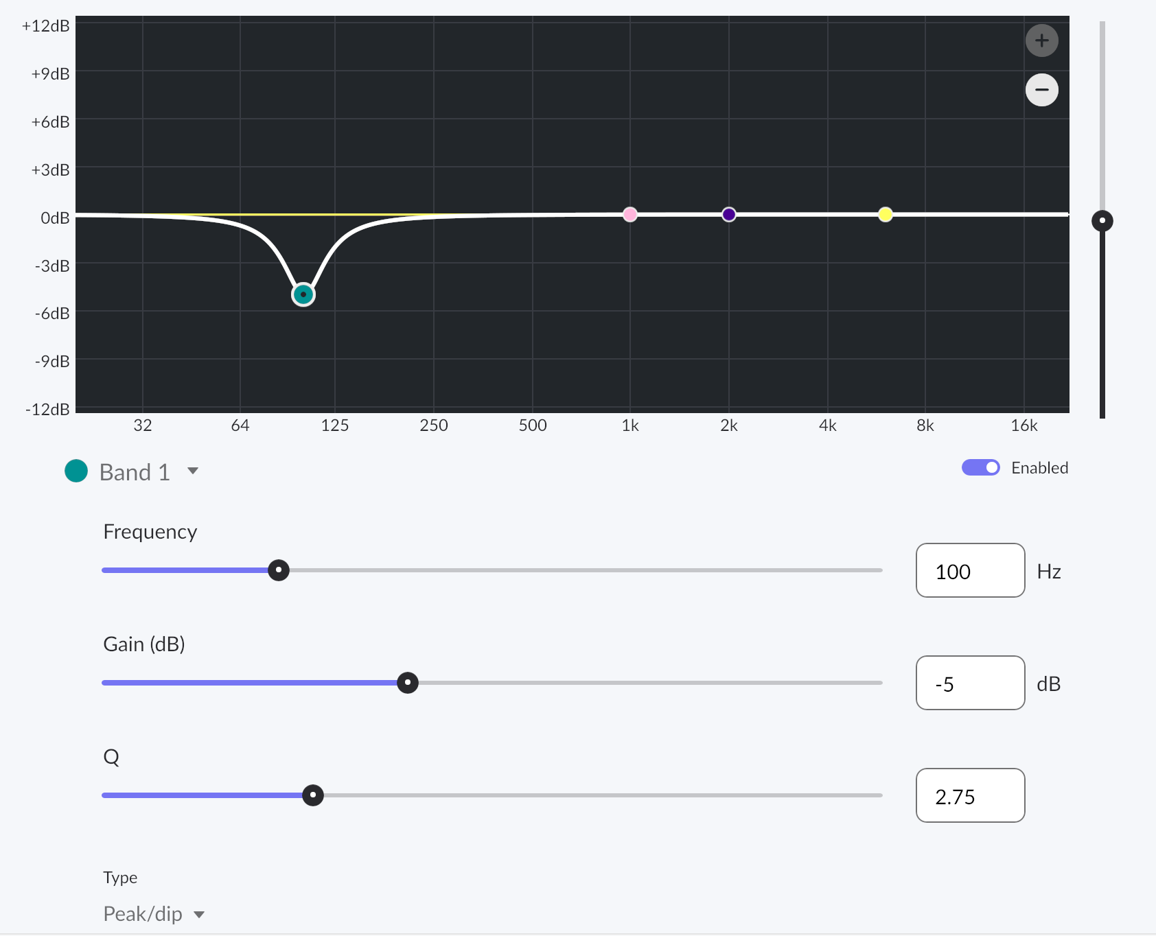

I will try to use a Low Shelf with attenuation of 5db below 150Hz and another Low Shelf with gain of 5db below 60Hz in order to cancel attenuation below 60Hz.
I tried as well a parametric filter centered at 105Hz with Q=0.67 but it looks less efficient.
Hey @Sylvain74, as others have shared, EQ can be a tricky. What your room measurements show is needed may not sound appealing once it’s dialed in. So, it takes a bit of experimentation to get things right. Try the shelf EQ you’ve proposed and then consider working with a peak/dip filter like the one I set up below.
