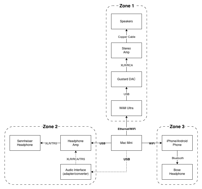

@Dennis_Laslo1 Could you or would you want to do something like the following to have separate end points and gain the ability to have MUSE DSP per zone?
The Mac Mini and Roon - not the WiiM Ultra - would become the central hub.
Yep…I could do that except the headphone amp input is the line out of the DAC. THere is no USB input. I used to use the Mac to feed the bluetooth headphones but I suspect the Mac DAC is not the best. I didn’t need the iphone…I just went straight from the Mac to the Bose 700’s.

PS: How did you generate that diagram so quick…? I’ve been fiddling with Visio for the last hour.

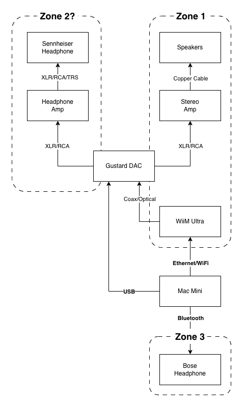

I put a question mark after Zone 2 below because I’m assuming - haven’t done this myself - it’ll show up as a different zone since Roon sees WiiM Ultra (network) and Gustard DAC (USB).
If I were setting this up for myself, I would consider…
  • The measured and audible differences in diagram 1 above and diagram 2 below. The differences would likely be subtle and possibly inaudible (or irrelevant with headphones).
  • Convenience switching between sources (controlled within Roon only).
  • Physical length of cables needed to connect devices.
The Bose headphone is handling the digital to audio conversion. The limitation to think about is bluetooth.
  • Similar to the bullet points above, I would choose simplicity and configurability.
  • Roon may treat audio output from the Mac Mini as a single zone - something to consider if you plan to use analog output or bluetooth speakers from the Mac.
For the diagrams I used draw.io
