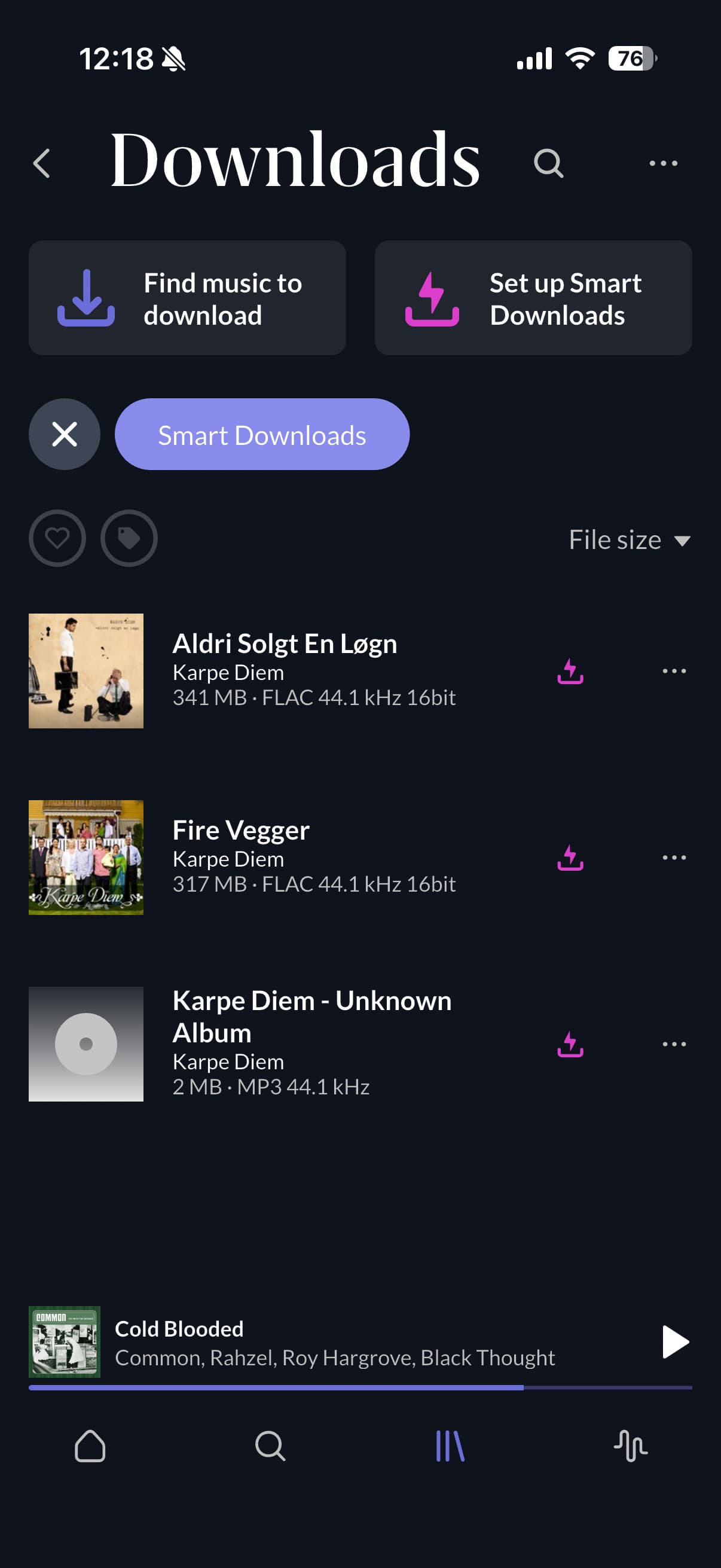

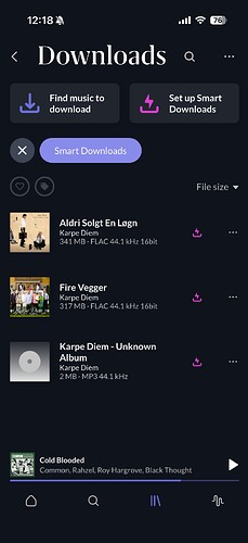

I have a problem where I only see 3 albums in my smart downloads.
I know there are more music downloaded to my device, but i can not find a way to browse only my downloaded music. Its like all the downloaded music is missing some metadata or tags to tell roon arc it is actually downloaded. I have tried to delete all and re-downlod, only to find the same 3 albums available in smart downloads..

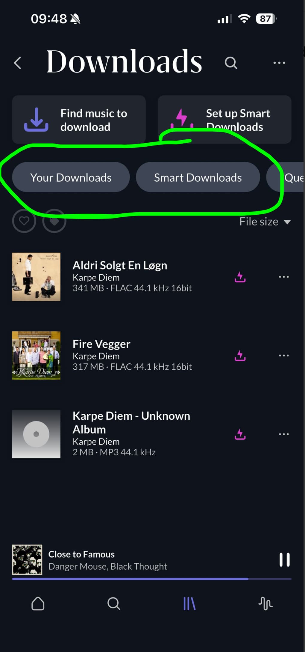

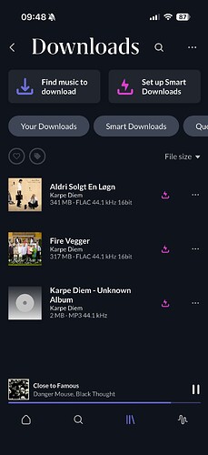

You are already looking at just the downloads in your screenshot and you can limit further with these buttons:
I know,
I still think there is a bug.

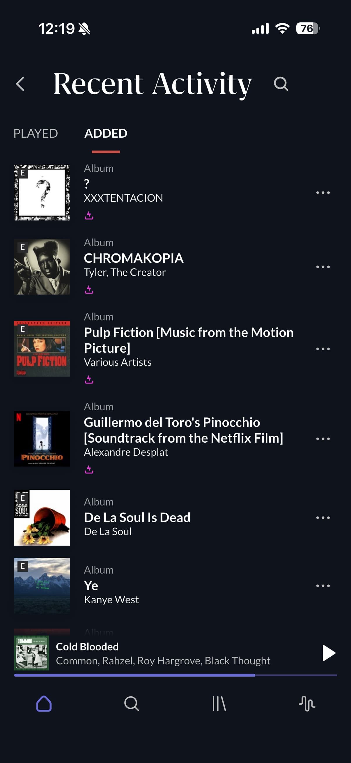

I am able to play other albums with my phone in fligt mode, and they have the smart downloads purple icon on them. They just dont show up in my download folder, neither in your downloads», «smart downloads» or «queued downloads»

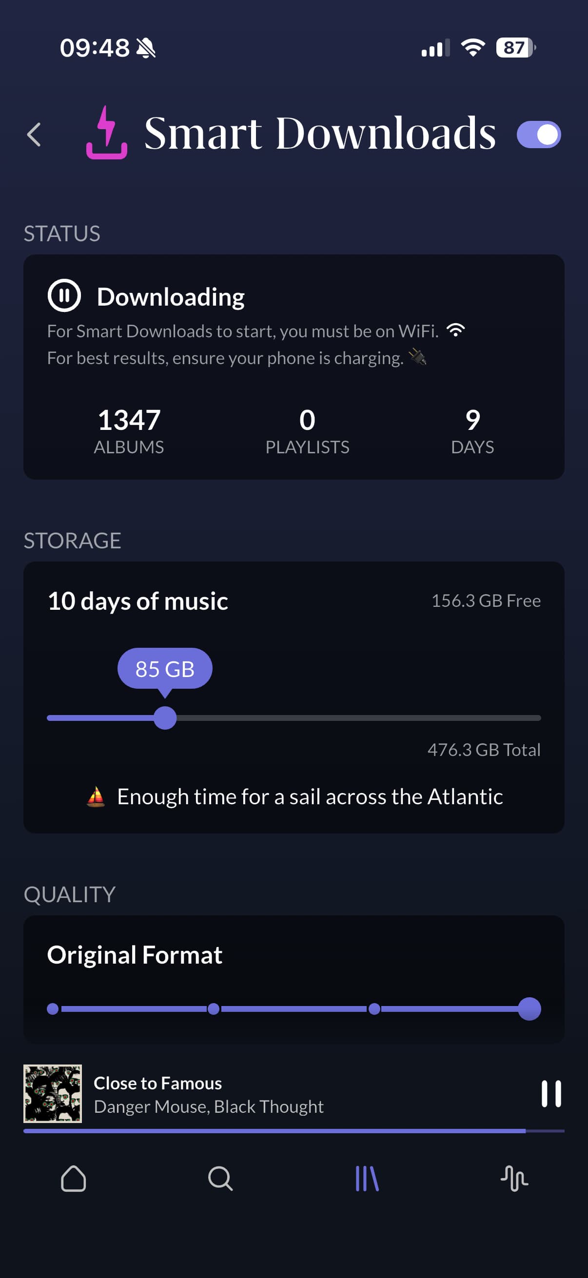

I also think that there might be a bug with the visibility of all downloads (or the fact that it should be downloading more than three), but my comment only addressed the thing that you had said you didn’t know/find:
