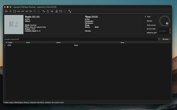

I’ve recently purchased a M4 Mac Mini Pro and wanted to to try running HQPlayer from it. My Roon library is on a remote Synology NAS and I’ve selected the output as my Holo Red. All of which are visible from Network and HQPlayer desktop.
However, I’m getting the error message that there is no route to the host and cant assign requested address.

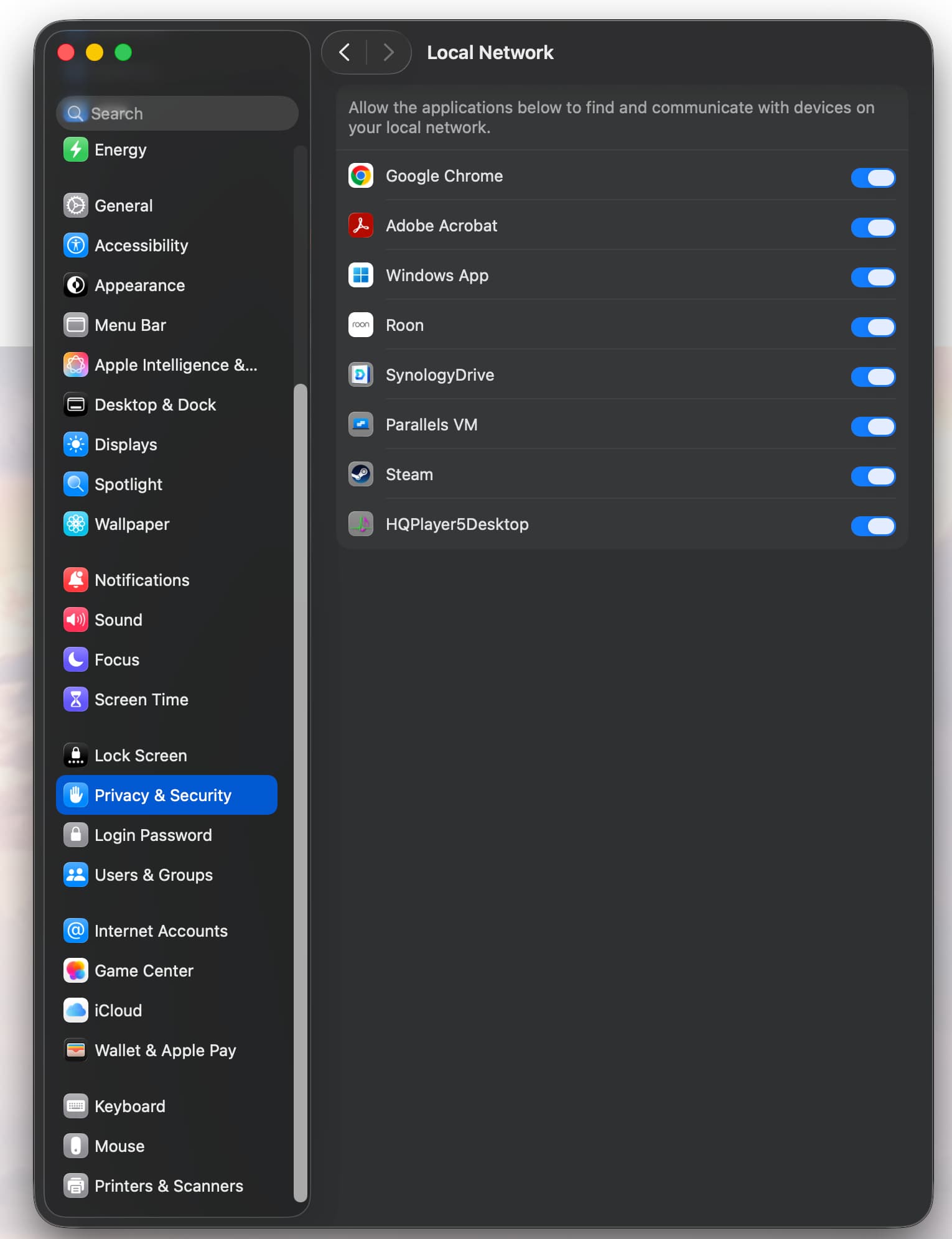

Recent macOS has a really paranoid approach to local network access. You’ll need to go to Settings>Security & Privacy>Local Network and add HQPlayer as allowed to access other IP addresses on your local network.
Thats what I thought too but its already approved.

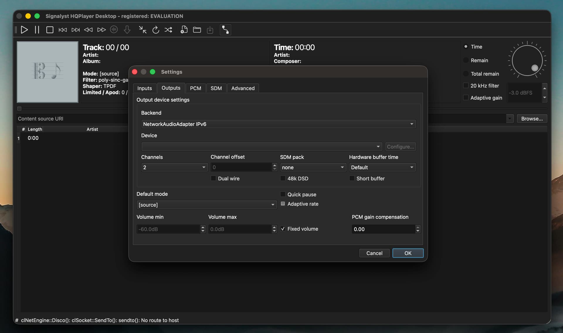

You can ignore this if the connection actually succeeds. HQPlayer has support for both IPv4 and IPv6. Depending on the network, IPv6 may fail and in such case HQPlayer falls back to IPv4-only mode.
If you see the NAA in HQPlayer settings, then it is fine.

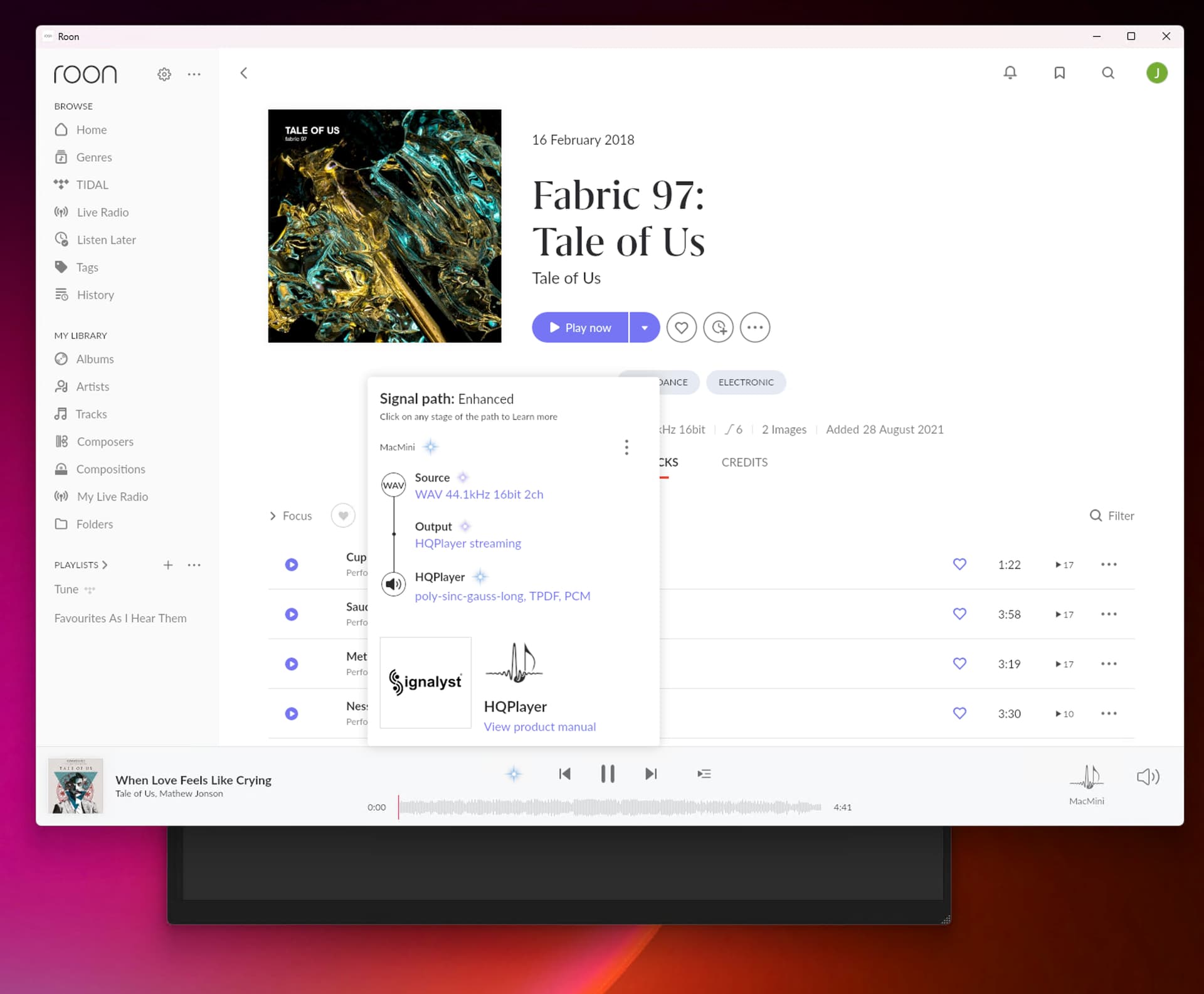

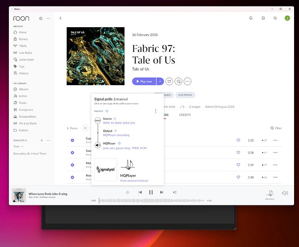

Roon can see and connect to HQ player on the network:
HQ receives the signal from the windows PC on the macmini and attempts to output the stream:

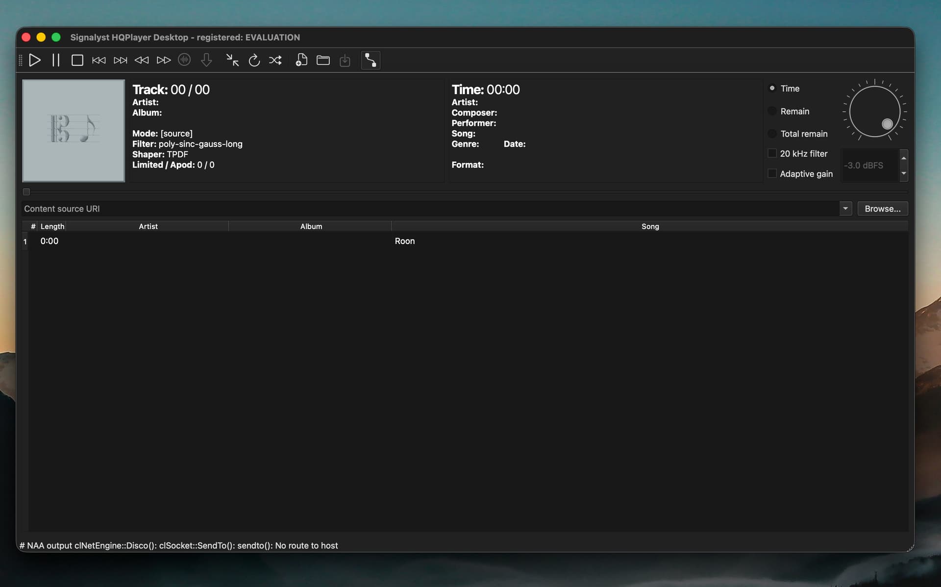

So communication between these two is okay. However, HQ cannot see the Holo Red:
But if I run HQ on the windows PC, it CAN see the Holo Red:
