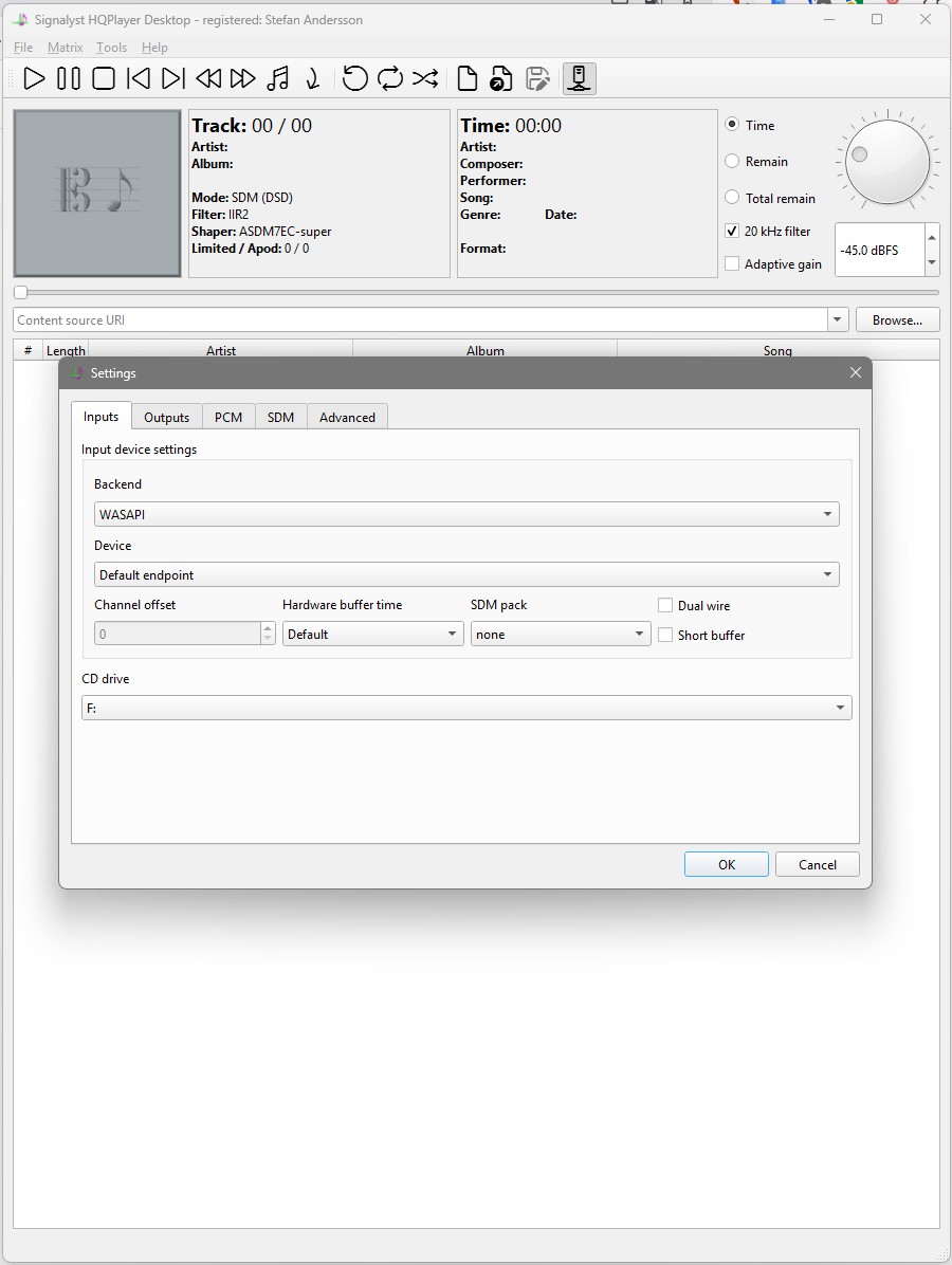

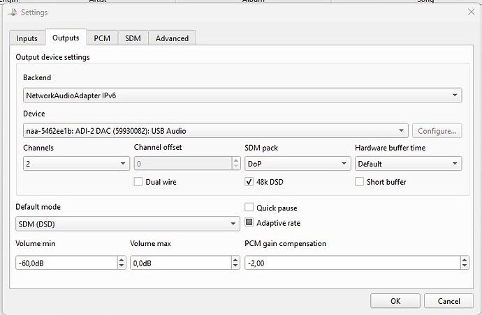

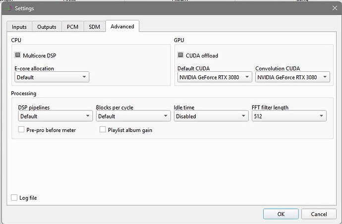

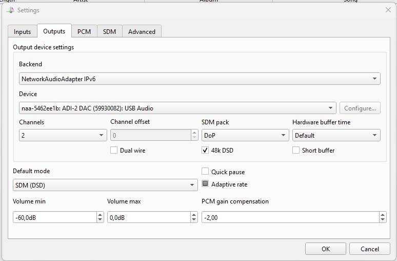

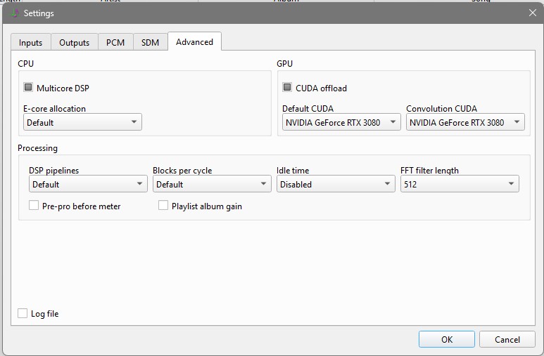

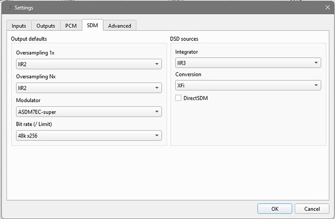

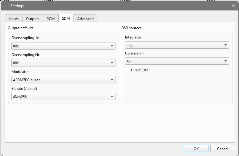

@Stefan_Jorma could you provide me your HQP settings please for DSD?

Do you mean all of tem, page by page? If so, I will post captures of them tomorrow here, if OK?

NAA is by no means required. It is an option. You can as well use local USB connection for playback if you like.
Depending on DAC there are benefits of using NAA though. Since macOS CoreAudio doesn’t support DSD natively, DoP is needed to pass it through the USB connected DAC. This can impose some output rate limitations. While when using a suitable NAA for output, native DSD (without DoP) can be sent to the DAC, lifting this limitation. Because then the macOS CoreAudio is not involved in the audio.

Settings according to my wish to have fast transients. While this was impossible to listen to in the earlier reinkarnation of my gear, the mains, ground and network mods and consequential naked and non-sibilent sound makes me just wish for more and more rapid transient response filters. It makes all music sound realistic, there is no longer any typical music for my settings. Even contemporary sh*t masters is possible to enjoy even if there is no doubt it is sloppy craftmanship. This is the most honest setting I have found so far, in my rig and thankfully it does give the impression of having a life of its own, finally. Love it, in sickness and health, for better and for worse … :wink:
Thank you very much!! As you’re using NAA, why do have DoP enables? I understood the NAA allows you to use DSD direct, in cotract to me using an direct USB-link.
And how does the IIR filter relates relate to the poly-sinc-gauss-xla (and similar) filters?
The DAC is not compatible with DSD256 native source.
Poly-sinc-guass-xla was my former choice. But then I started to feel that the notes were smeared and softened. It played a role at the introduction of the filter, but when I later felt the lack of transients, especially drums and percussion, I started to listen to short minimum phase filters and FIR and the pace and beat started to make sense again. Again, suggested from the friends here, off course also Jussi. The IIR2 choice, came out of reading the manual and filter descriptions. I tried short-mp, FIR filters and the IIR2 back and forth several times and decided that the latter offered best overall SQ. I would not have chosen this say one year ago. The sibilence would have killed the joy of music, with harsch high mids on bad productions. But having paid a lot of attention to the details mentioned before, I no longer need a sonic “brake”. Most music, except really good classical, jazz and some contemporary genres almost “needs” apodizing filters. When listening to much music, from various genres, one soon realizes how good British Decca was, especially their talented staff and master techs. You don’t even notice the sonic traces of valve tube sound when done by these guys, even though the recordings are old. Talent and quality does not age, once done it will be for ever green… :wink:
RME ADI-2 only supports DoP, there’s no native DSD support there in the hardware. OTOH, it works the same 705.6/768k PCM and DSD256 on any hardware and OS…
