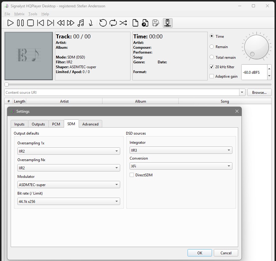

do you try multi core and cuda checked?
I thought they were checked if grey? There are three steps, one blank, one with a check sign and third grey. I will make the check visable to see what happens, if anything.
Thanks :heart:
No difference
heulo
ok iir2 is very heavy so it may not make difference with that one
but all else checked should always give best result as you have multicore cpu
if 48 do not play then check 48k dsd and check adaptive
and set bit rate in desktop settings for dsd to 48 x 256
this play for me

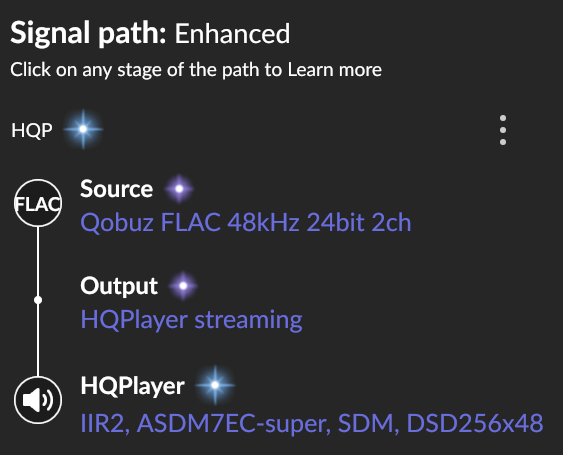

The DAC in questions is not compatible with 48k base rate and its multipel rates. So it will not work. I will return to my RME and appoint that to be an endgame device and make best possible conditions for that. The best decription to RME is, that it is nothing. I perceive the DAC as nothing in the chain of devices. And there it is, the magic. No warmth, no chill, no hype, nothing. I will stay with that, and instead listen to the music coming out just as realistic to me as the real thing.

IIR2 cannot convert between rate families, thatā€™s why 48k-base sources donā€™t work. I know how to make a workaround for that though, but it is not implemented yetā€¦
Please take a look at the filter table in the PDF manual regarding possible conversion ratios.

I did find out the rate family conversion problem, thanks to nice members here. I did try other filters, but was not pleased and has already started the process of returning this DAC and go back to my RME.

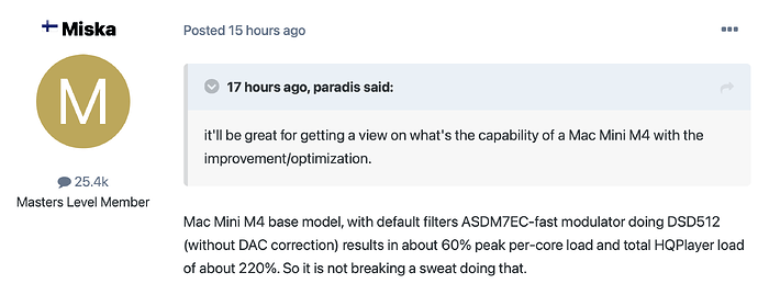

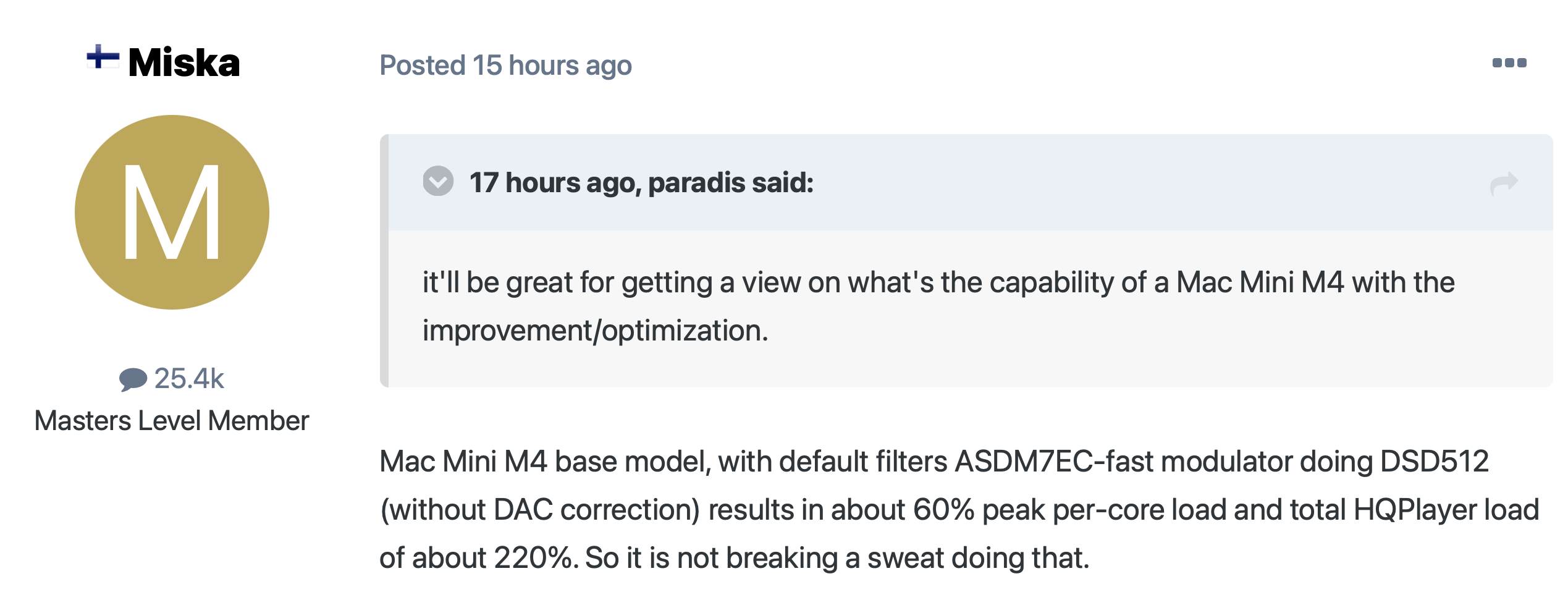

would be great to know what limits of the M4 base 16GB are. Is dsd256 with DAC correction and convolution fine with almost all filters? War begins to break / not be possible with dsd512?
Yes, can you please buy one and let us know? :grinning:
