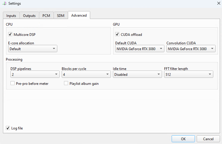

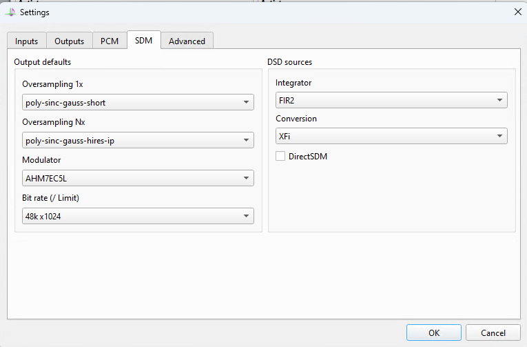

Anyone who successfully made DSD 1024 work, may I seek your advice how should I set mine?
My spec:
  • 12900KF
  • 32GB DDR5 @6000
  • RTX 3080
  • HQP Desktop latest version
  • HPQ operates remotely (Roon is on Nucleus One) on a dedicated PC on gigabit Ethernet
  • Holo May KTE
  • Holo Red NAA with latest HQP NAA OS
  • Dac Correction Enabled
I tried AHM7EC5L @48K x 1024 and really like the sound. This setup, however, almost worked, as I could get almost stutter free playback. However, sometimes (1-2 times per song) I got a short pause, indicating that my setup can’t quite make it.
Here are settings. I tried various different Blocks per cycle and pipelines settings but no avail.

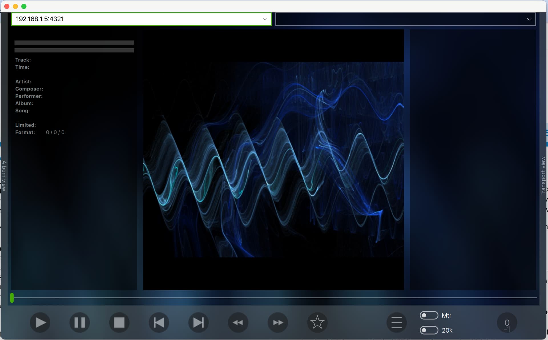

Quick question. Just subscribed to desktop, running it on my Mac 4 Mini - it’s chugging along doing great on 192 PCM while I wait for my Holo Cyan 2 to be built and arrive. I’m controlling it very happily with HQPDcontroller on my iPhone as well as Roon, and it’s terrific. All the usual playing with stuff.
But… I can’t get HQPDesktop client on my laptop to connect to the server with all the same details.
Here’s what I’ve done:
  • Started Client and typed the same exact address (tried both 192.168.1.5 and 192.168.1.5:4321 in the address bar. I know this works because both Roon and the iOS app connect just fine. The Mac Mini does have both ethernet (that’s the 192.168.1.5 address) and WiFi (doesn’t matter what it is I think) and I know it’s accessible.
  • I’ve run nc -zv 192.168.1.5 4321 on the laptop, works fine as expected
  • On the Mac Mini ran lsof -i :4321 and it’s listening on TCP and UDP on both the IPv4 and IPv6 address
  • Checked in System Settings on both computers that both are allowed access to the local network, which they must be for HQPDcontroller to work, which it does.
  • Input the IPv4 address with both the port (192.168.1.5:4321) and without the port (192.168.1.5)) in the top left drop-down looking area of the Client (see picture below). I also tried the IPv6 address listed in my with and without the port, and same behavior.
Whenever I type it in, and hit enter it disappears (the drop-down goes back into the same state it was in before). If I click somewhere else it’s persistent, but nothing happens.
Any ideas? I saw a thread on AudiophileStyle where someone had a similar problem. I have multicast enabled in my Unifi router, and all seems to work well on other applications I have.
I'm not sure if the HQPdesktop instance is supposed to be advertising itself and it should be visible in the drop-down, but the only thing in there is localhost, so if there's an advertising action going on it's not working.
Many thanks!

HQP Desktop (server) is running on my Mac 4 mini, and is streaming just fine if I use either Roon, the HQPDcontroller iOS app, or directly access it from the Mac 4 mini itself. So “control from network” is on and everything is hunky dory.
HQPD Client is running on my laptop, and I’m trying to use it to control HQPDesktop.

And wait a second… I just de-installed HQPDesktop Client and reinstalled it, and hey-presto it took the IP address just fine and it works now! Now I can’t see the spectral analyzer/spectrometer/whatever it’s called, but otherwise it seems to work!
Metering can be enabled/disabled using the Mtr switch in the button strip.
Great to hear that and never had an issue like that myself. But at least it is working now. My devices are normally auto discovered, but if not I just use the IPV4 address.
I wonder if IPV6 was getting in the way
