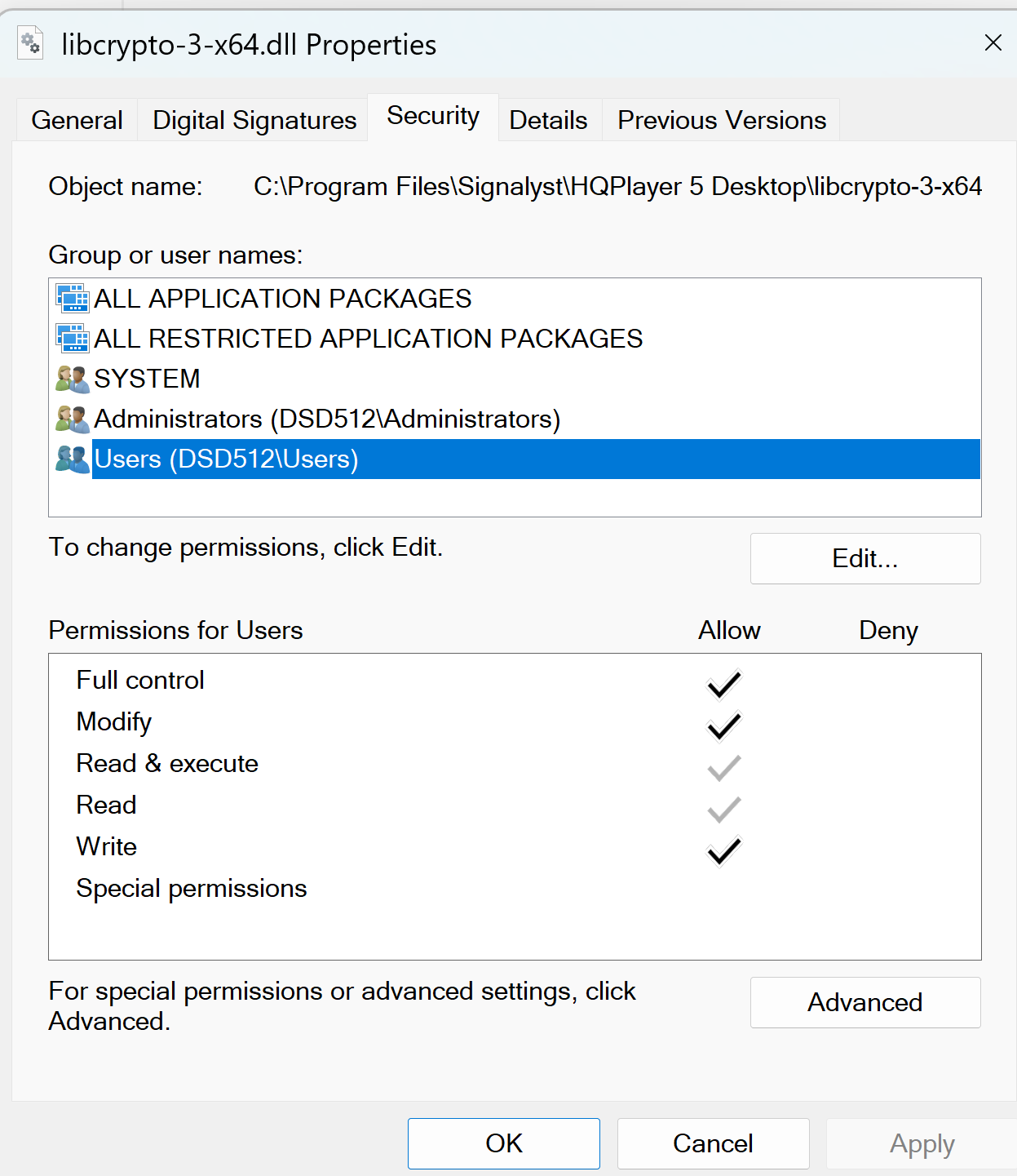

Can't write: C:\Program Files\Signalyst\HQPlayer 5 Desktop\libcrypto-3-x64.dll
Any ideas?
I updated here permissions, but still error
Fixed! somehow it was running on background. After closing it, it was able to install it

That will indeed cause errors writing many of the files. In addition, on Windows it is recommended to uninstall the old version before installing a new one. Please note that this won’t touch your settings, library, or license key file!

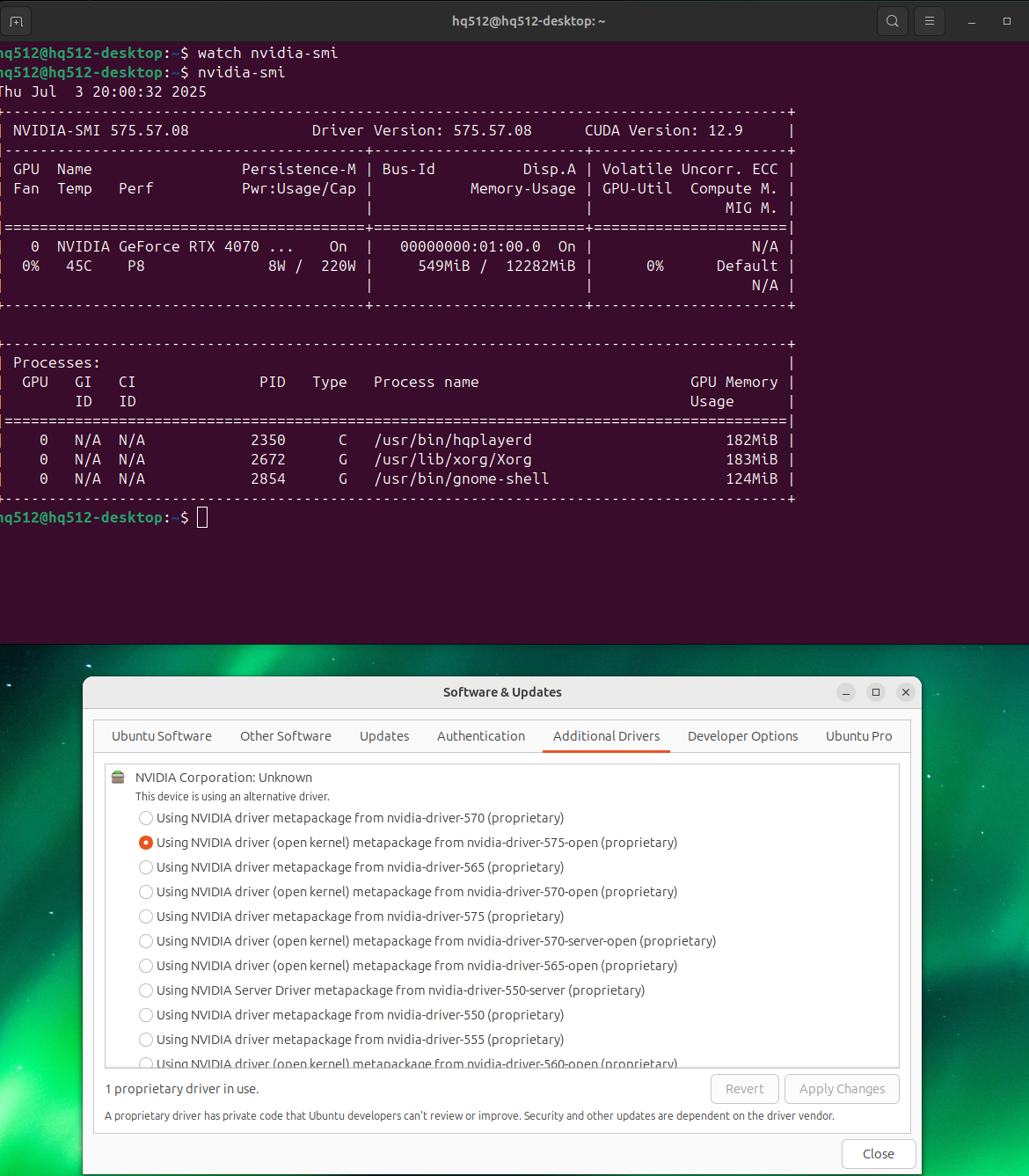

Another question, I recently installed NVIDIA-575-Open driver in Ubuntu, it was done using the “.run” installation. ( before installing I removed and purge previous nvidia drivers). It was working fine but, after running some Ubuntu updates using the updating app it was updated to a repository 570 ver and I had to clean and install it again. Any suggestions of what to update and what not to update so is not affected? Like (unchecked any option)

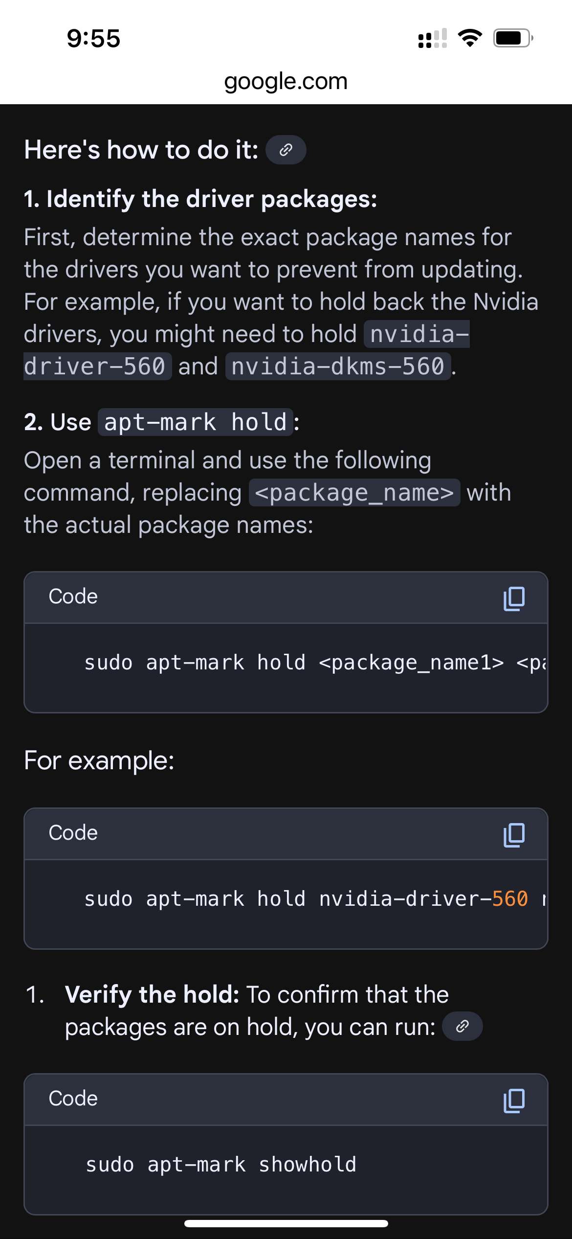

BTW, Is this a good idea:
I recommend to install the drivers as proper packages from Nvidia’s CUDA repository. Then you know you are in sync. Those .run installers are problematic since they mess with the OS configuration outside of the packaging system, which will in turn cause breakage when the packaging system updates packages and doesn’t know about these changes.
So first add the Nvidia repository:
wget https://developer.download.nvidia.com/compute/cuda/repos/ubuntu2404/x86_64/cuda-keyring_1.1-1_all.deb
sudo dpkg -i cuda-keyring_1.1-1_all.deb
sudo apt update
Then if you are on Ubuntu Desktop (IOW, with GUI, which I assume being the case on HQPlayer Desktop thread):
sudo apt install nvidia-open
Then reboot and you should be done. You’ll get driver updates along with the OS updates.

Done! Fully integrated into the Ubuntu Desktop Updater! Many Thanks!

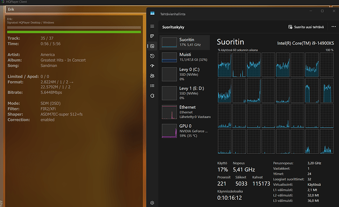

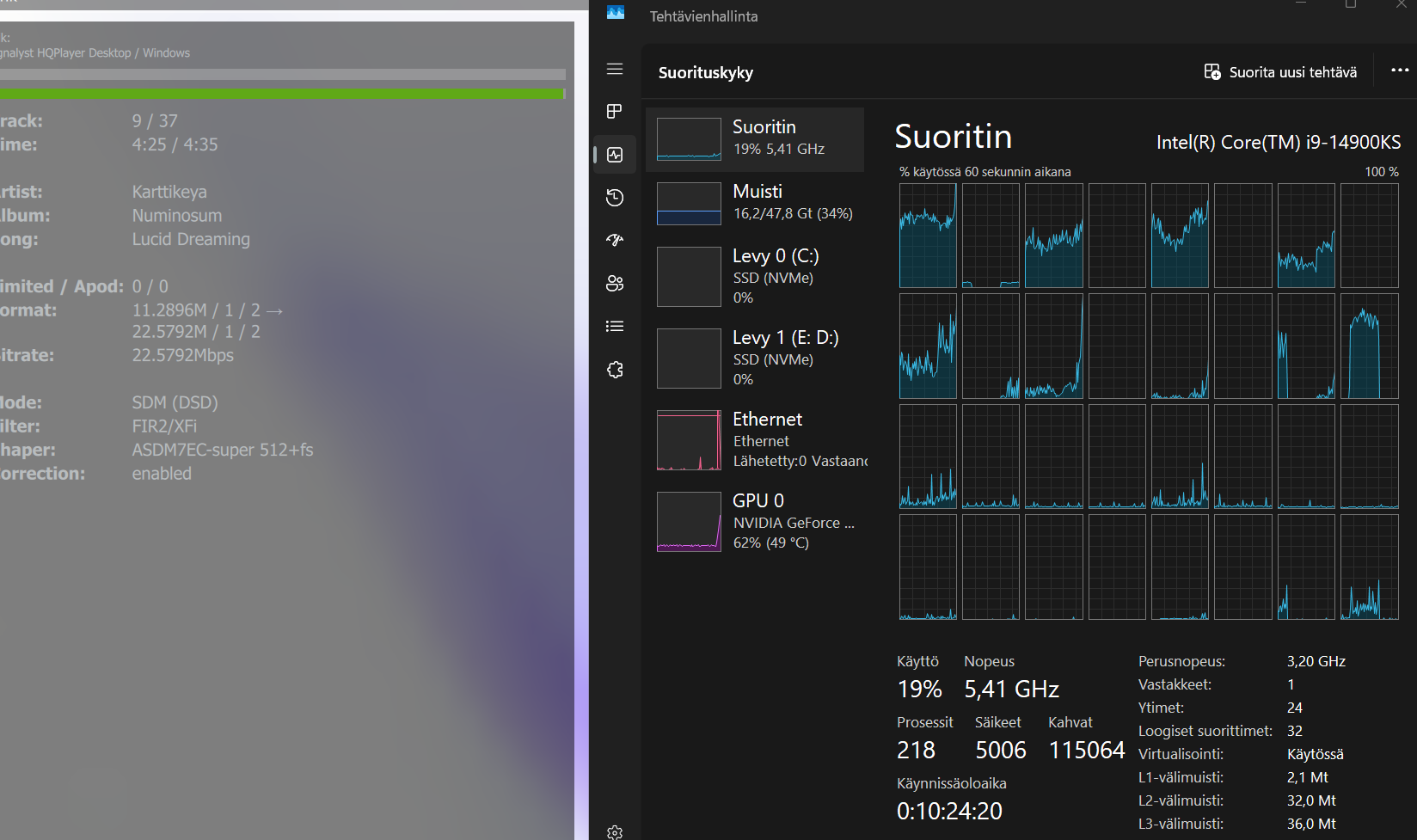

Just wanted to say that I did finally get DSD1024 stable with sincL and asdm7ec-super 512+. Still running same kf-14900 and 4090 on Ubuntu.
It is rather embarrassing - at the end of the day I just asked Claude Code to observe playback for dropouts and design any fixes to configuration apply any tuning it thought reasonable to free up cores 0 and 4. It cooked up a thermal optimization application, some priority stuff, something to do with hugepages - I think 7 distinct changes in total - and this totally gave me stable playback for the first time at this spec.
So to anyone else out there who is stuck and desperate and wants a fresh whack at this - give Claude Code a shot at it. I think some of those adjustments might have helped out with avx handling in particular.
Don’t get me wrong - I still have a tailored overclock and all that. But at the end of the day, it didn’t require any mad stupid GHz or subambient cooling or any such silly business. Though I did try a bit of that.
Running a modest undervolt, 800 vrm, 46 ring ratio, avx offset 2, cores 0 and 4 yoked to 5.9 (down to 5.4 under heavy load). 360 aio cooling running hard.
