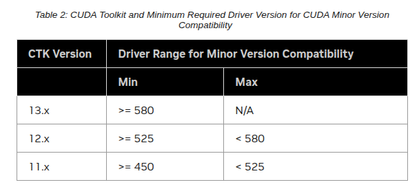

I’m still building a 14900k box, but cuda being deprecated still doesn’t make sense to me as by installing 5.14 offload works, and installing 5.15 offload is broke. Then uninstalling 5.15 and reinstalling 5.14 it’s fixed again.
Isn’t nvidia v580 driver with cuda 13 is still being utilized in both scenarios?
5.14 uses CUDA 12.9 and 5.15 uses CUDA 13.0. The driver is just an interface between software and GPU. Newer drivers facilitate newer interface functionality, including support for newer GPU models.
This is the driver version table from the CUDA release notes:
So they don’t promise driver 580 would work with CUDA 12.x applications. But it likely does.
Ahh. Now that makes sense.
Thank you @jussi_laako
