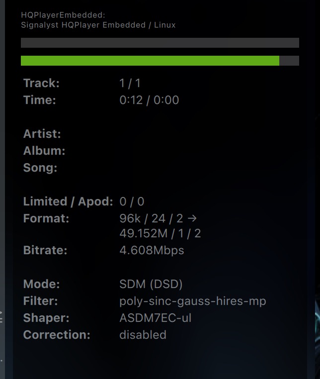

DAC profiles store all settings including if DAC correction is enabled or disabled!
This feature is a time saver for profiles where DAC correction may need to be disabled.
