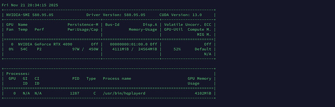

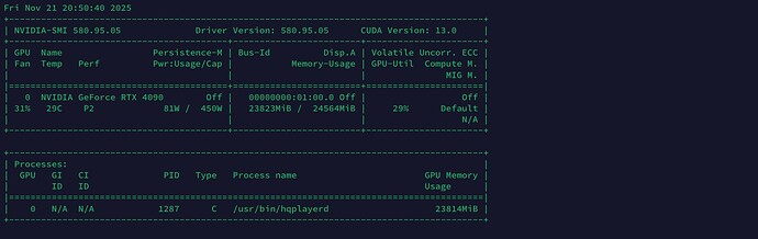

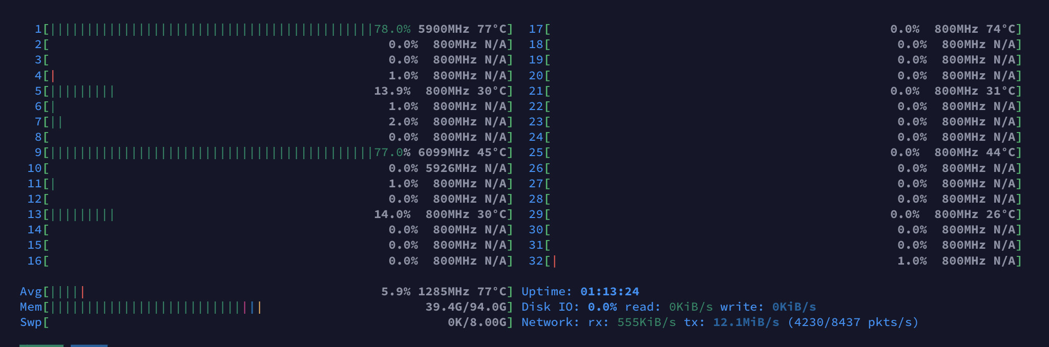

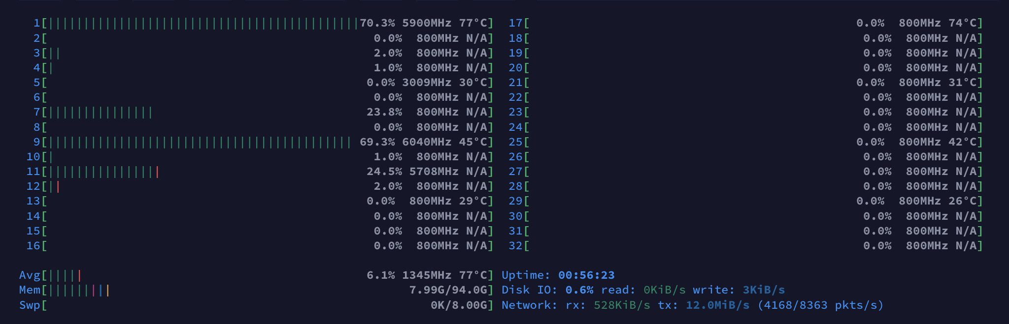

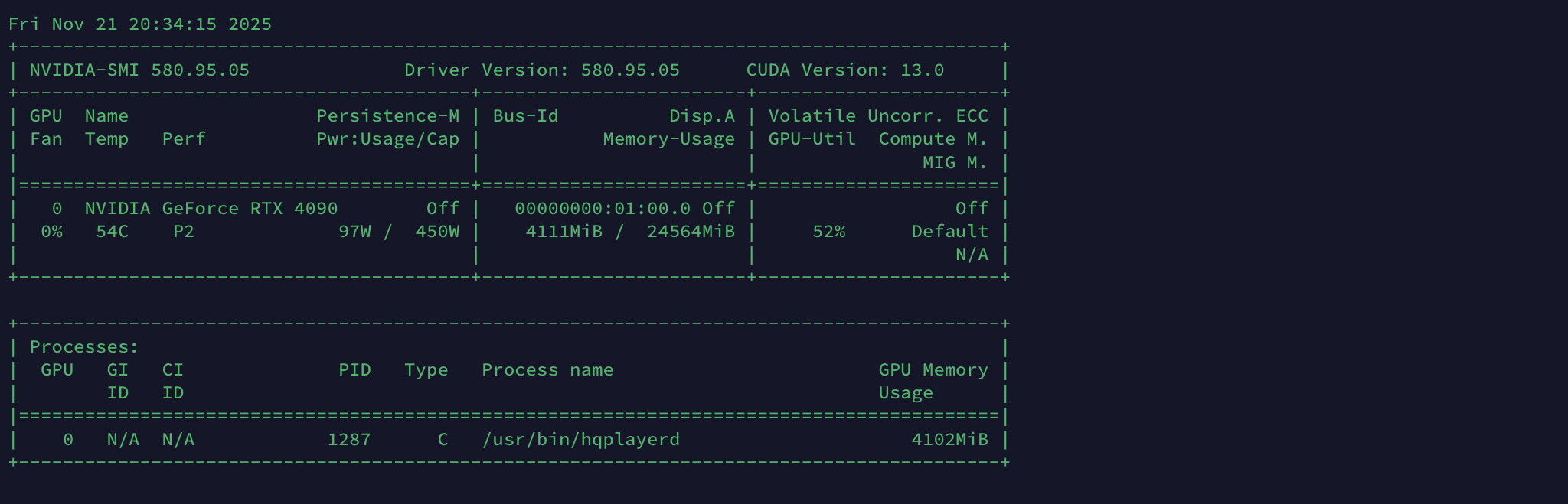

@zottel for sinc-Lh use case, let me share my benchmark for you to may be concider if Sinc-Lh is your goal. Hardware is 14900KS + 4090. System handles with DAC correction. I would say CPU is not too far off from yours in this use case, GPU is far off. Sinc-Lh needs GPU memory. Here couple of images:
This is on stock settings, no OC. for 2ch listening you see only two cores at max out, but equally 70+ %% is as far as it goes, so for your CPU you should have this space allright
this is nVidia stats, 4090 is running at 75-90W, 25-50%% GPU utilisation, with 4GB constant vRAM, this is about what it takes. Clearly no need for 4090 if Sinc-Lh is a goal, but decent new 5th gen 8GB nVidia may be appropriate…
PS: this is Sinc-L = “The Beast” filter with DAC Correction at SDM@1024 with 44,1 source, if anyone wonders
CPU is relatively OK’ish… sometimes hitting 90% utilisation at 2 cores, but RAM is already nonsense… 40Gb! and vRAM is insane, almost complete 24Gb!
But it works perfectly well with DC if it makes meaning for anyone. It is a good filter for some specifics. Try solo violine, wont be disappointed.
PPS: modulator is 7EC-fast 512+fs here and above.
