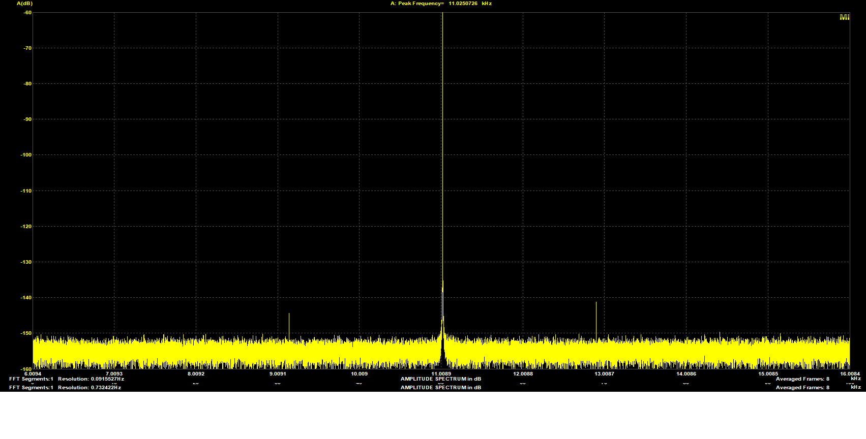

Do you have measurements from the analog DAC output with and without PLL?
Not very good ones stored, but some.
This is with PLL:
And without PLL:
Looks like around +5dB without PLL.

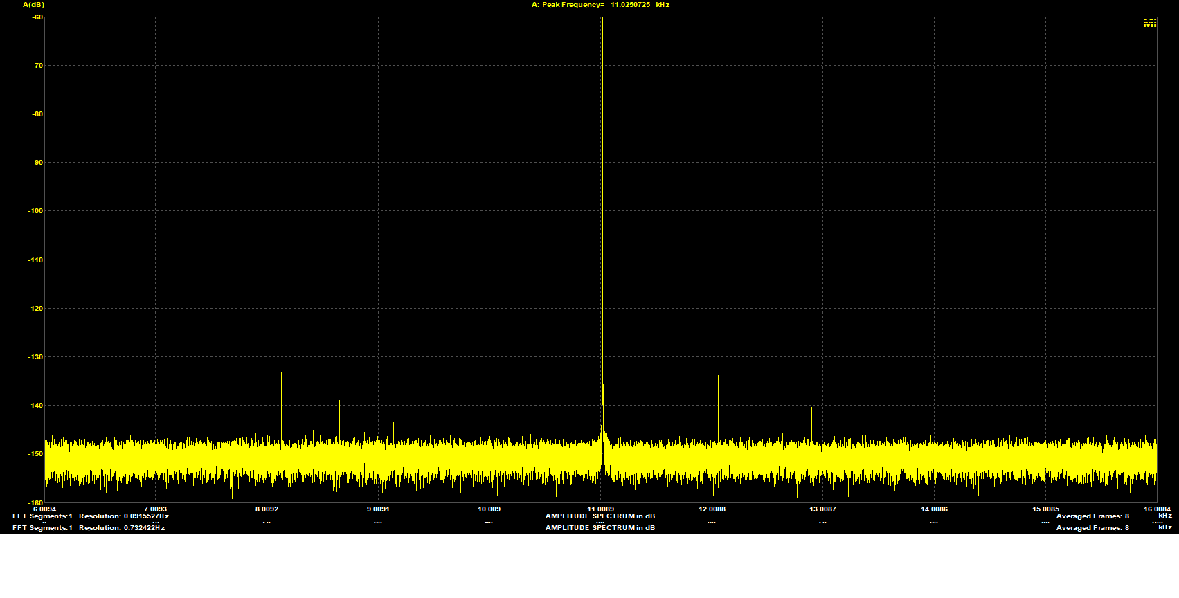

Is that a large amount?
Noise floor increase and some tens of dB more jitter. And you can also compare to USB input instead:
Alternatively, in this case with Cyan 2 you can also compare USB:
vs I2S without PLL:

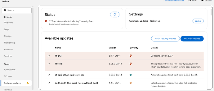

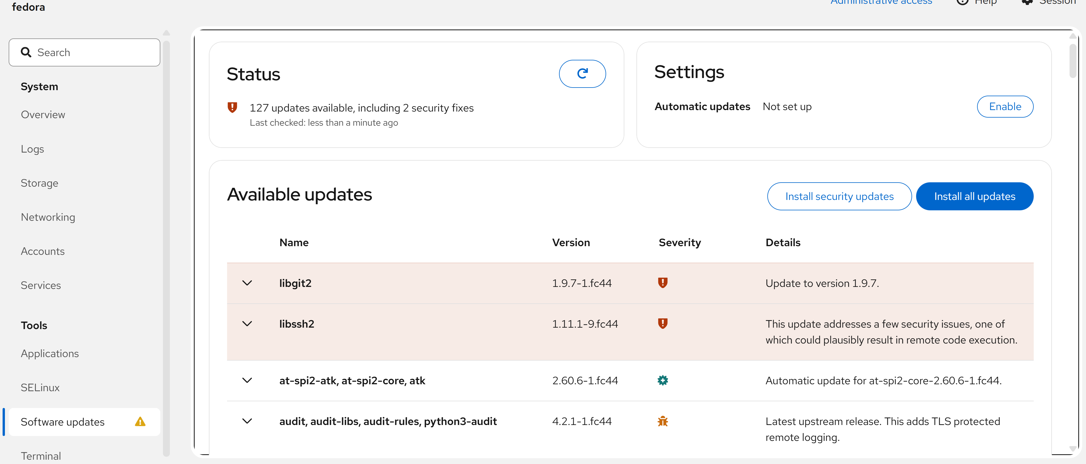

Should I update these?
I try not to, so that I don’t run into issues, but the number of available updates scares me a bit these days…
You should keep your system up to date! Otherwise it becomes a security risk.
None of those visible in your screenshot are related to HQPlayer.
