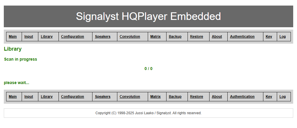

I am using version 5.11.0.
The Library screen looks like this and I cannot configure the settings.
How can I fix this?

Scan was started, but not completed? It may be still traversing the directory tree until it knows how many items there are. You need to wait for the scan to complete before you can do other actions.
Unfortunately, I haven’t done any setup yet and this is the situation.
I have given it enough time again, but there is no change in the situation.
OK, just reboot the device then, that will certainly interrupt the scan…

Even after restarting the service and rebooting the PC, there is no change in the display.
