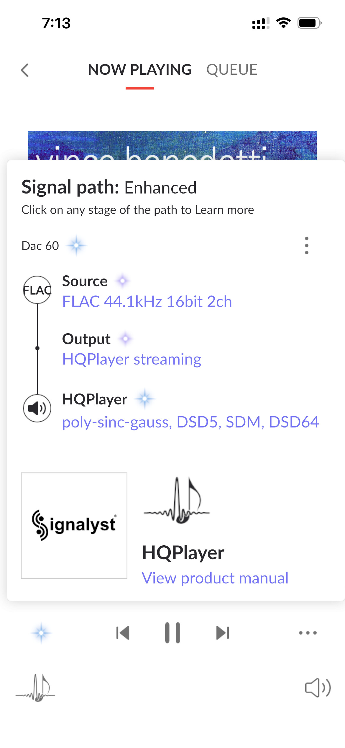

Using an old embedded ver 4 license on an old Rpi4 connected to my DAC-60
I’m amazed how this little thing can push DSD64. It drops sometimes when processing higher resolution files, but in PCM 384khz is stable.
This is more nostalgic than looking for the highest resolution, reminds me when I discovered HQplayer and started playing with it. Vintage DSD anyone :joy:?

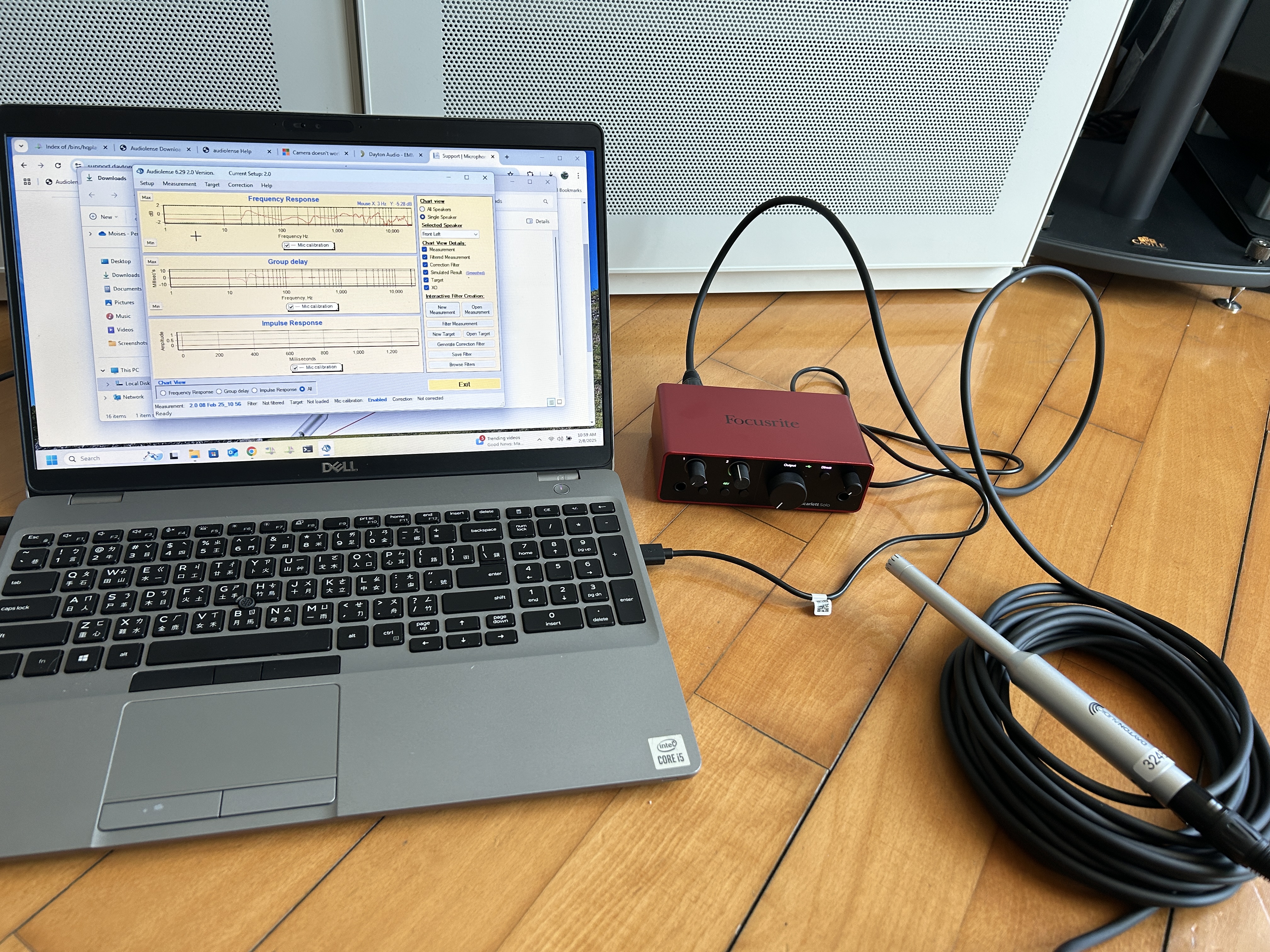

I’m starting basic research on how to use Audiolense. (At least I figured out what it does.)
Do I also need Ozone 10 or Neutron 4 to use it?
No audio mixing software is required to use Audiolense.
Measurement microphone + Audiolense + HQPlayer is enough…
Thank you! :))
The only issue is figuring out a way to run sweep with hqplayer dsd for audiolense - I wonder if anyone else has done this and can advice on a way to do it ?
I don’t think this is needed. And I can’t see how the time domain correction could work well.
For optimal measurement and optimal correction (especially True Time Domain correction feature of Audiolense), you need lowest latency, where Audiolense plays and measurement with only one ASIO interface driver involved
Jussi would need to create some virtual ASIO driver. I imagine he has more important things to do :grinning:
If Jussi were to create his own room correction software/ HQPlayer feature, well that would be interesting
And audio mixing toys ( with ASIO) to do the job better
The Focusrite interfaces are fantastic for measurements.
Even for playback (HQPlayer output set to PCM192kHz).
Especially when multichannel DSD DACs (all are ESS based) are quite expensive
I do run an Artpro USB ii interface with a Sonarwork mic for audiolense.
