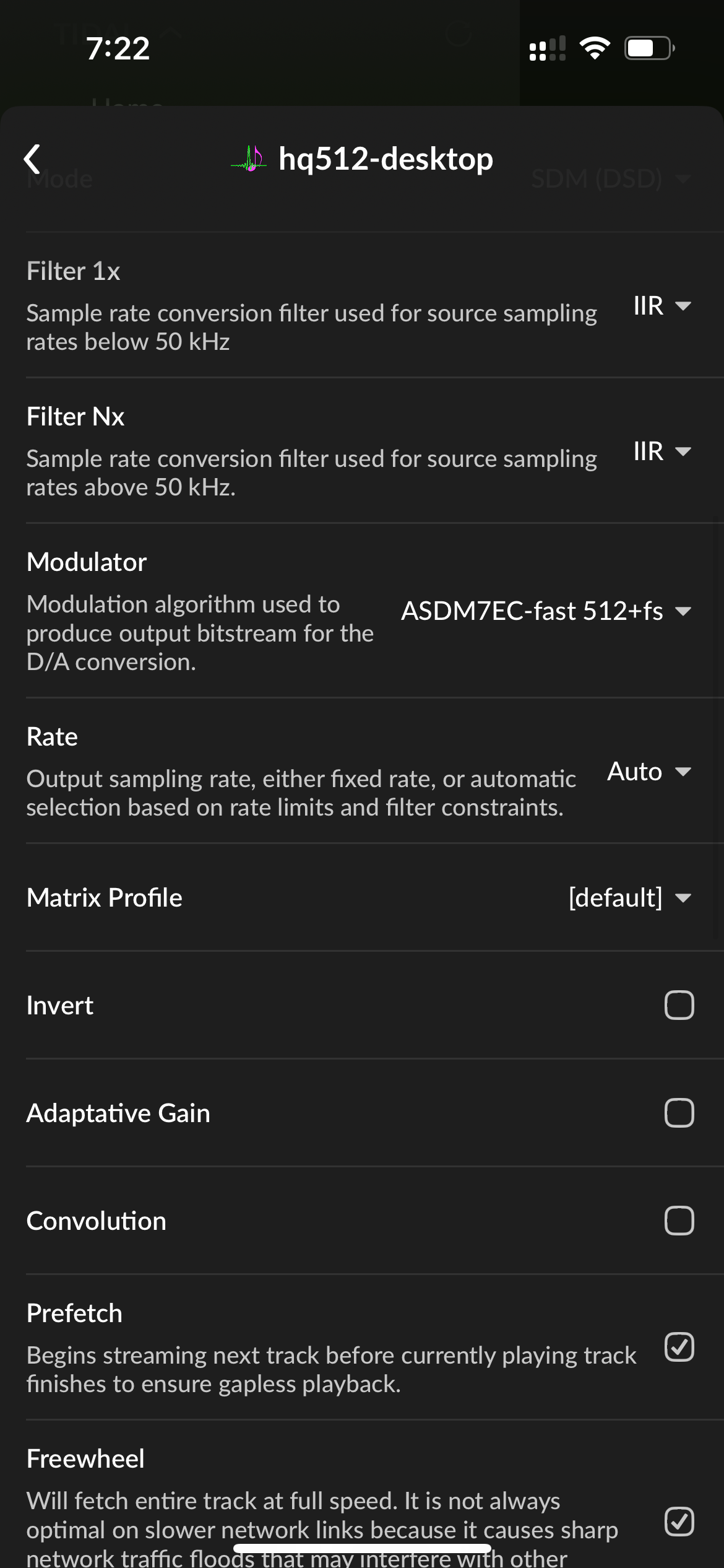

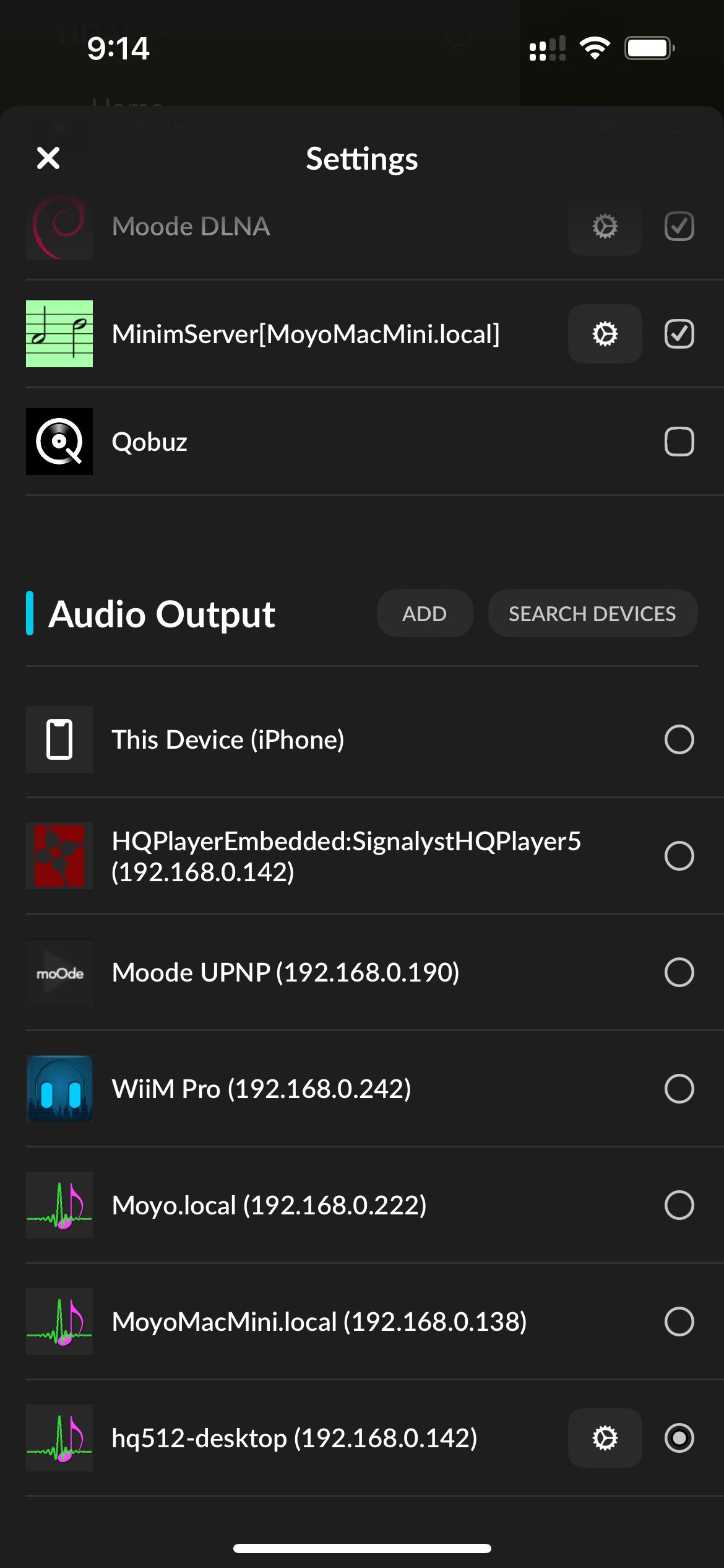

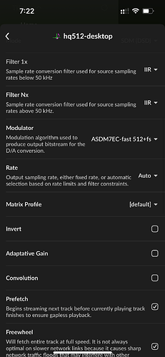

Just click on the audio output zone you want and that’s it:
Ah, I see you have multiple HQp licenses? My config is running a single HQpe instance on a server, and assigning it to an endpoint using config profile, to limit cost. Jplay doesn’t show those as different Audio Outputs, as I have only one HQp address.
All this being said, audio quality using Jplay is top notch, nothing bad to say about it. Much better than my experience with mConnect on iphone, that was a disaster IME. I’d like to see Jplay “sync” its playback queue with HQp rather than being seen as a single stream from HQp point of view. For example, start playback from Jplay, browse to HQp client and see all the upcoming tracks and be able to pickup control from there. Currently, if you for example stop playback on HQp, Jplay will eventually send its next track, its stream doesn’t dissociate from server, it is oblivious to the HQp control state. As I understand it, HQplayer API already offers this feedback for devs to implement.
You have to use HQPClient or HQPDconfig to change the endpoint device as JPLay doesn’t know about these additional profiles.
It’s not fully integrated with HQPlayer, but just sending it’s output to HQPlayer. Seemed to work pretty well when I tried it
With Desktop you get only one, with HQPlayer logo (native HQPlayer). With Embedded you get two, one with Rygel logo (UPnP) and another with HQPlayer logo (native HQPlayer).
