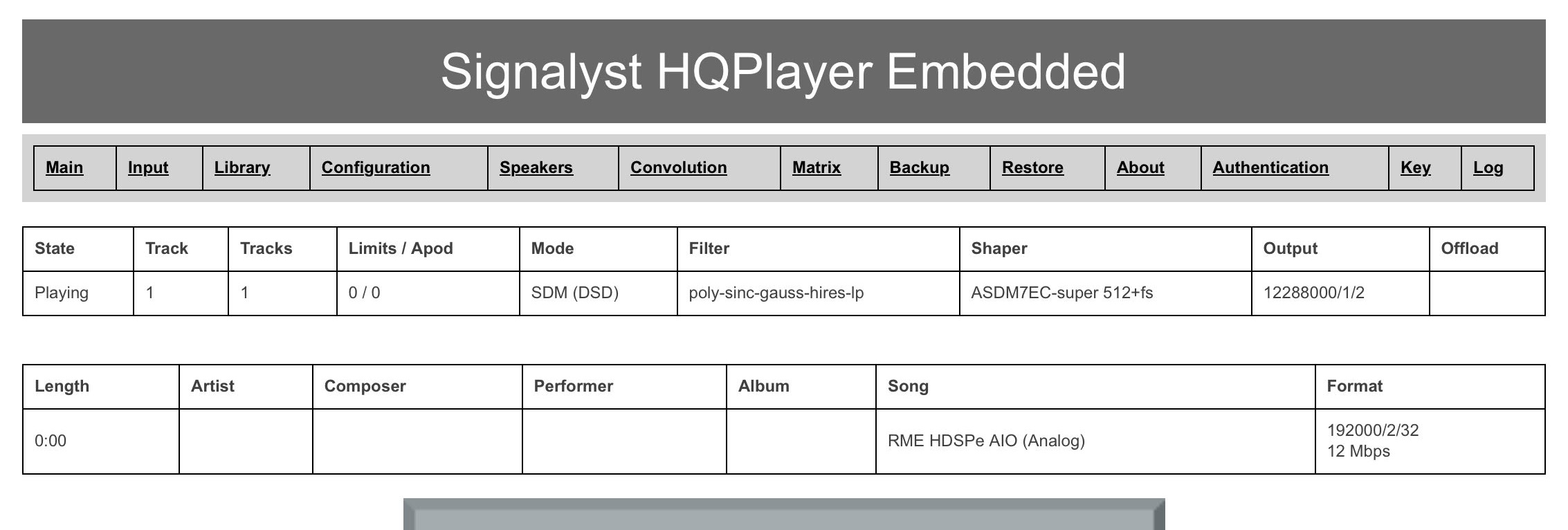

Finally made it!!
I can now run ASDM7EC-super 512+fs at DSD512 with the Matrix pipeline equalizer and DAC correction, as well as with the 20 kHz filter enabled.
More than I expected.
Soundwise, it seems crystal clear, and I’ll listen to different types of music from now on.
Finally, I was able to get the burden off my shoulders.
Thank you very, very much to those who gave me guidance and advice!

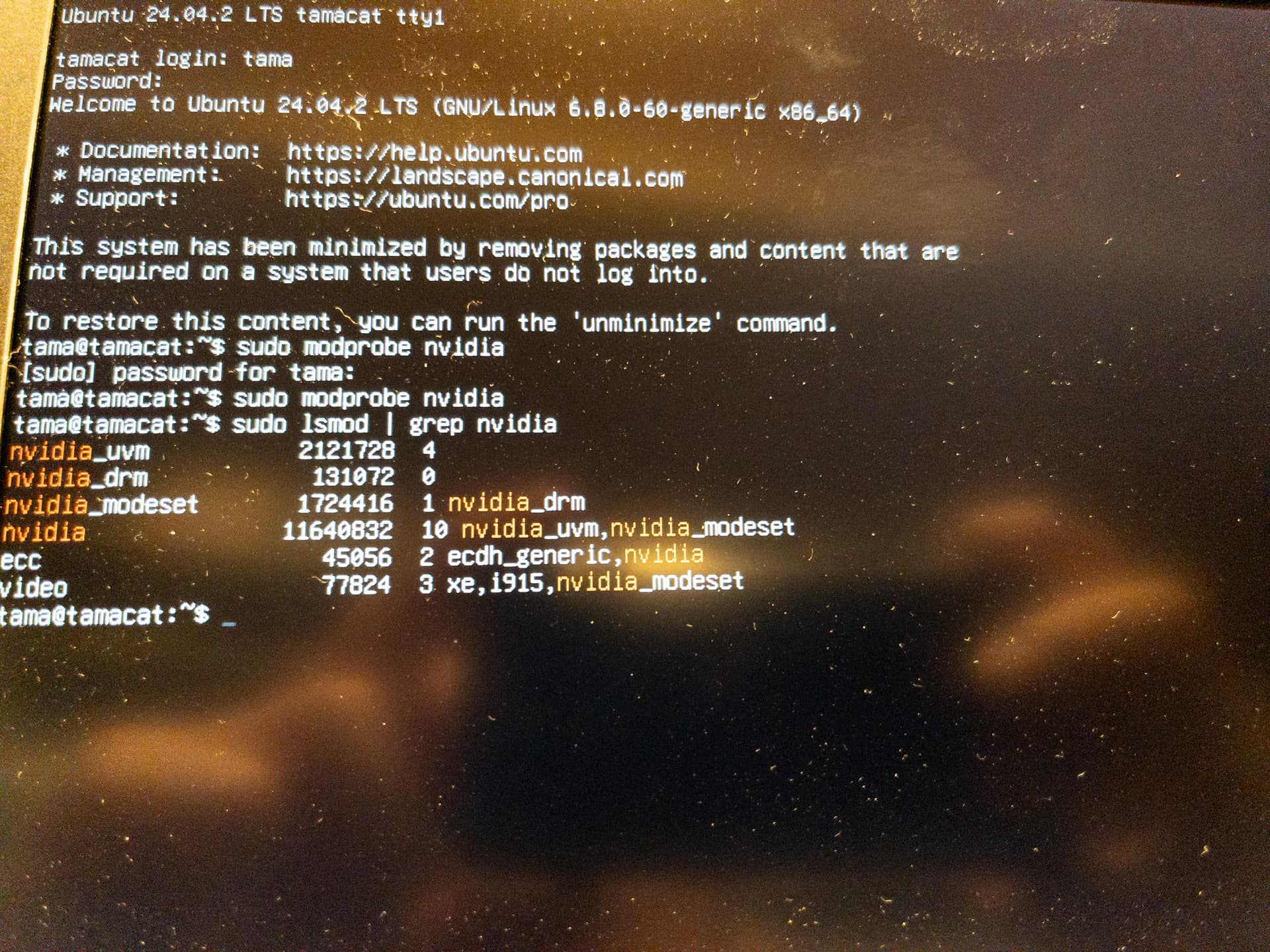

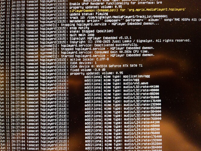

You could check why it is failing. Is the driver loaded? Is the CUDA device recognized?
They seem okay, but somehow it is not working…
(Excuse me for the dusty monitor screen.)

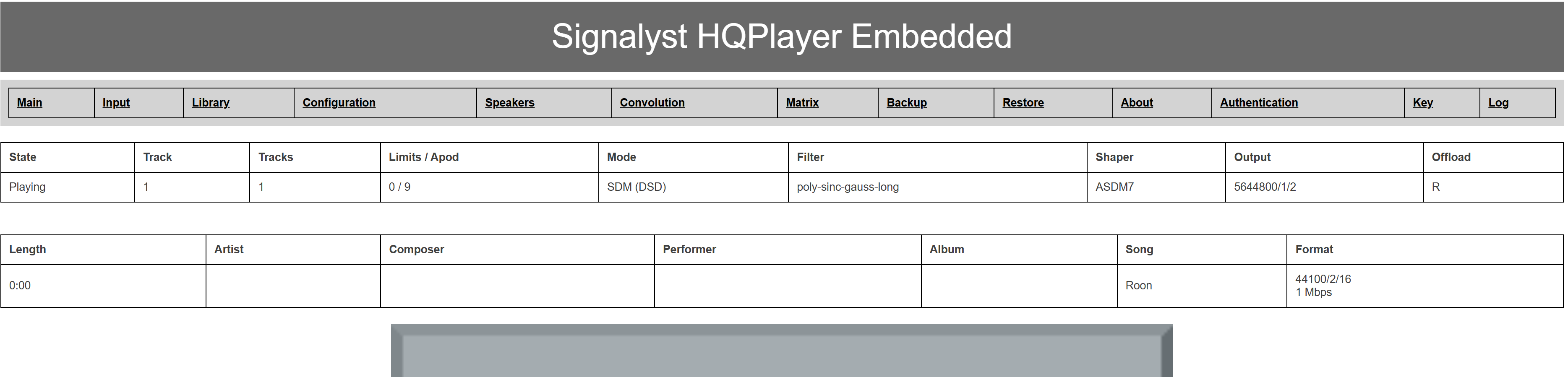

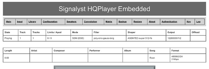

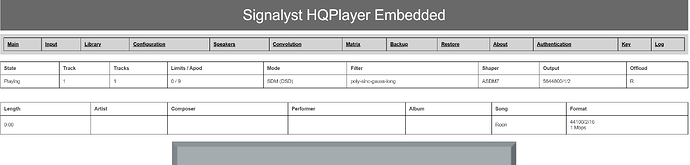

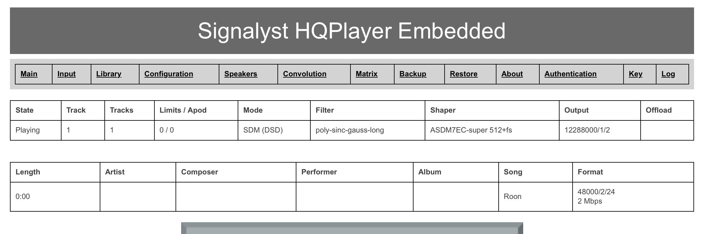

Seems fine to me, it is also detected. When you have playback proceeding, the offload is not indicated? Which settings are you using in that case?
Like these. Changing fs to DSD512 remains the same and pauses intermittently.

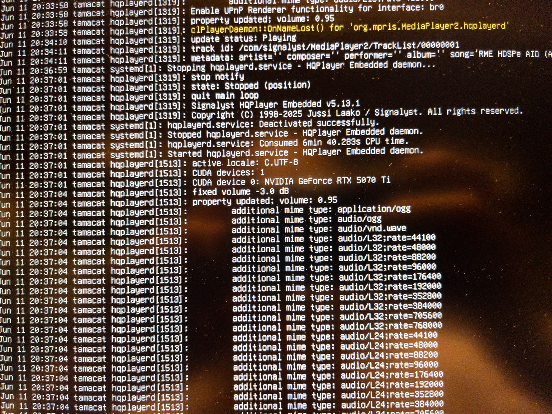

Weird, please check the log file if it says something. Permission issue is less likely too, because the GPU is detected, and hqplayer user is automatically added to the needed groups when created.
Also last time when it was working, you were running the same “6.8.0-60-generic” kernel version?
In the log file, the only line I can find that contains “cuda” or “offload” is:
offload: resampler=disabled convolution=disabled
Yes. I haven’t made any changes to that.

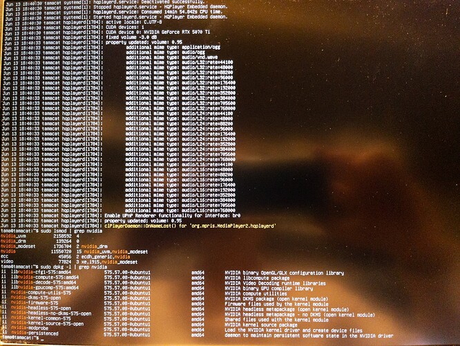

Since the GPU is detected, but the offload doesn’t become active, then one possibility that comes to mind is somehow too old Nvidia driver version. It shouldn’t suddenly magically get switched to another one, but if the driver version is too old, then what you are seeing is exactly what happens.
I have driver version 575 at the moment.
You can check with “modinfo nvidia | grep version”
Checked.
I have 570.133.07
Is it from Nvidia repository? Have you tried installing the latest 575 version?
I think so.
However, doing “sudo apt install nvidia-headless-575-open” didn’t change the version.
I saw your post somewhere before about purging the existing version.
Could you tell me how to do that?
You can do “dpkg -l | grep nvidia” to see what you have installed. You can then “sudo apt remove” any excess pieces, and clean up the rest with “sudo apt autoremove --purge”.
