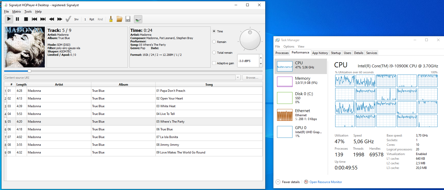

Can your i9-10900K output poly-sinc-gauss-xla for 1x , to DSD256 ASDM7EC ?
2-channels only
No stuttering?
Without GPU help
And same questions for your Mac Mini M1 ? (1x = poly-sinc-gauss-xla to DSD256-7EC)
I don’t know, but I would guess it would work since it works on my AMD 5800X (AMD build under Ubuntu). I have not used that machine for couple of months (it’s in a different place than where I’ve been).
I don’t know, but I would guess it doesn’t.
Safer bet is to use RTX 3060 or higher. I think I had it working on my laptop with 5900HS + RTX3060 (mobile). But I would recommend RTX 3080.
I just checked and no, it doesn’t work. Plays for a while and then pauses. So quite cannot keep up with the processing demand, as expected.

I am running that filter and modulator combination on a i7-8700K with an RTX2080. No skips, pauses, delays at all.
Nice! But I wrote “without GPU help” above, since a GPU can help a CPU a lot
Seems to work
Doing 192k to 12.8M pushes the CPU on edge:
I run this this combination without issue on i5-10600k @3.9GHz. No GPU, 2ch only, no stutters or any issues.
Source up to 96K PCM. 192K PCM is too much for it. DSD anything is too much for it but I have very little DSD.
