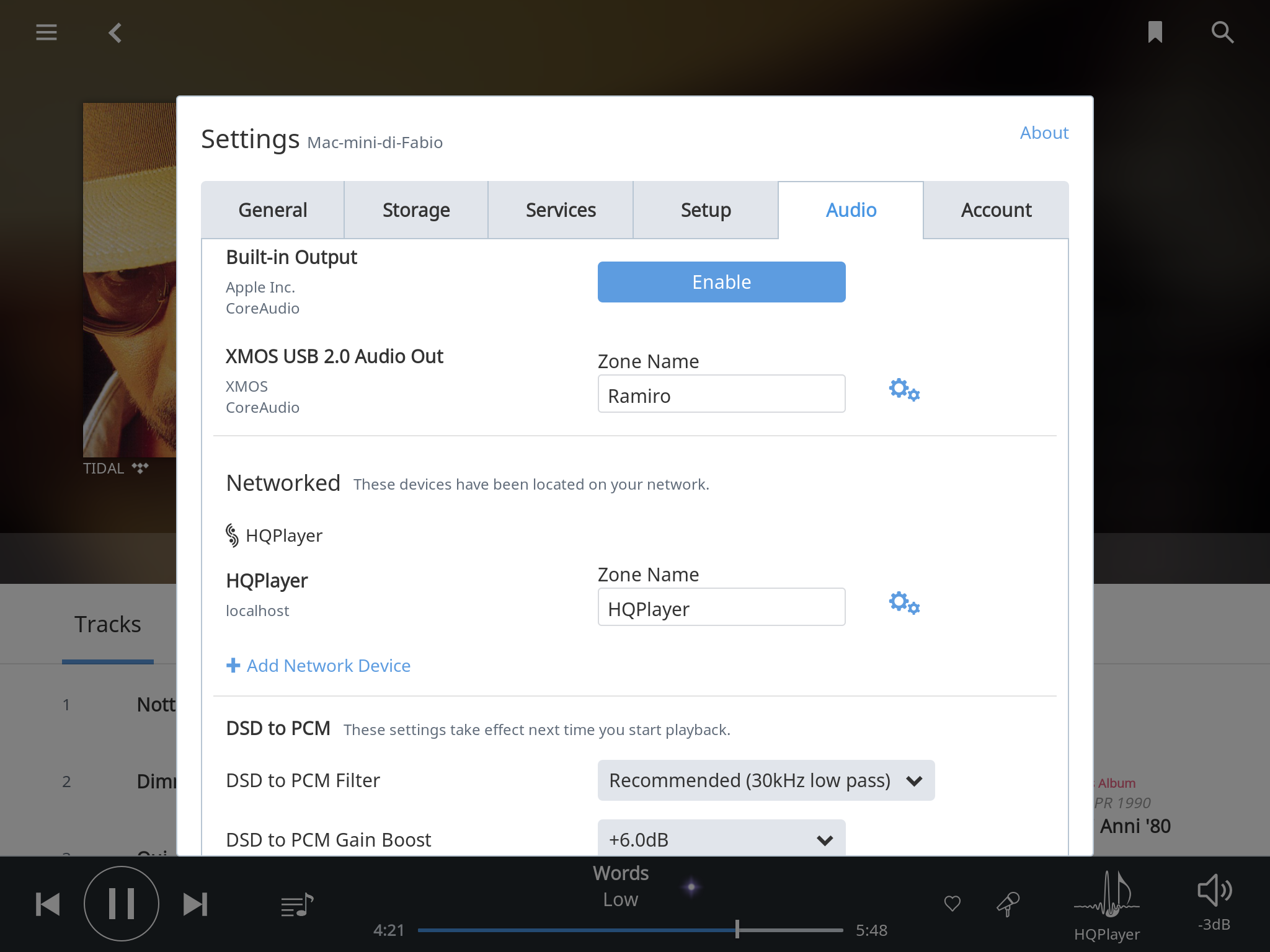

Cab we please see your Settings/Audio setup in Roon.
There should be one Zone named/enabled under HQPlayer localhost only.
I am looking at HQPlayer Settings/DAC bits. Do you have a 16 bit DAC?
Hi @bibo01,
as you can see from this image, it is as you wish:
Yes, I’ve a 16 bit DAC with 96 Khz (it’s a Ladder DAC). This DAC is using Jlsound I2S over USB interface (I2SoverUSB - I2S over USB Audio)
Bye
Yes, thank you.
However, you should not have any Zone Name enabled except HQPlayer - under XMOS no “Ramiro”.

If more than one zone is enabled then OS gets confused. You should have only HQPlayer’s enabled.
dear @bibo01
No! I should have only Ramiro, because HQPlayer alone doesn’t work properly!
Then you are not using HQPlayer at all. You cannot have two applications playing simultaneously to the same DAC… If you try, you will just end up with troubles.
