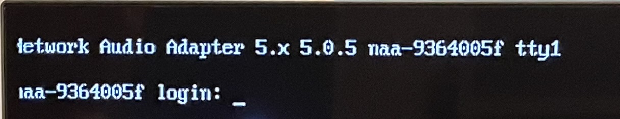

Connected the UpBoard Gateway to TV and after booting the device it stops to ask for a login, is it supposed to do that?
That’s normal, you don’t need to log in, it’s up and running.

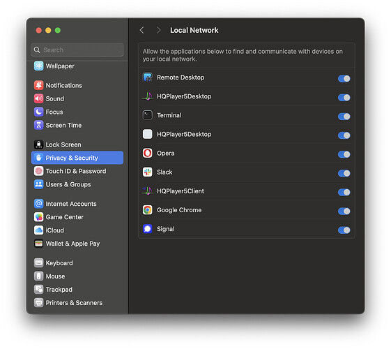

Like said the only change I’m aware of is the MacOs update, so it might be pointing to Mac OS settings. But I don’t know what this setting could be, where do I find this “allow to find devices on local network” in current Mac OS settings? Can anybody help, please?
This is one of the macOS settings related to the NAA discovery:
You can also try uninstalling the software first; IOW, drag the HQPlayer applications from Applications folder to the bin. And then install again the latest version. Just in case. And if at application startup you get prompts for some permissions, check those out and grant the asked permissions. If for example above one is denied, then HQPlayer won’t be able to find any NAAs.

Thank you! Yes, HQPlayer was disabled, probably because of the MacOs update(?) and after enabling it, HQPlayer found the NAA again. So simple, but just couldn’t find this by myself :sweat_smile:
Just don’t understand why the Mac OS update has disabled these? Hasn’t happened before
It has happened to me multiple times, both for HQPlayer and for Roon. Apple has again decided in its “infinite” (sarcasm quotes) wisdom that they know better than you how to “protect” you. And of course, they’t place that network setting under Privacy & Security, not Network, just because? And by the way, even without a macOS update, sometimes you get a pop-up at the most inconvenient time asking to re-allow an app to access the local network.

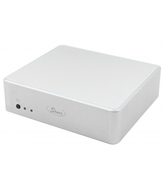

If I install an RPI4 with a HAT, will “naa-515-raspberrypi-holored” be able to support all outputs (USB, I2S, AES, coax)?
More precisely, it is the Ustars C19 (PI CM4 base like the Red), so if I understand correctly it is possible to output in DSD 1024 on USB, I don’t know if also on I2S
Red doesn’t use a hat for DDC, but instead the DDC is connected to the internal USB bus. I don’t know how that C19 is implemented. If it uses a hat, then you’ll need a compatible overlay (device tree file) for it to describe the hardware connections for the kernel. Since arm64 devices typically don’t have anything like PC’s ACPI that could describe the hardware connections for the OS, you need external hardware specific description file.
USB should work the same on all RPi4/CM4, so it should work.
It’s not a HAT, but I think along the same lines as Red.
I found it yes. They don’t really tell details about it. But I suspect it uses a “hat” hooked to the RPi’s I2S, since the DDC maxes out at 384k and hence also DSD128 over I2S using DoP.
