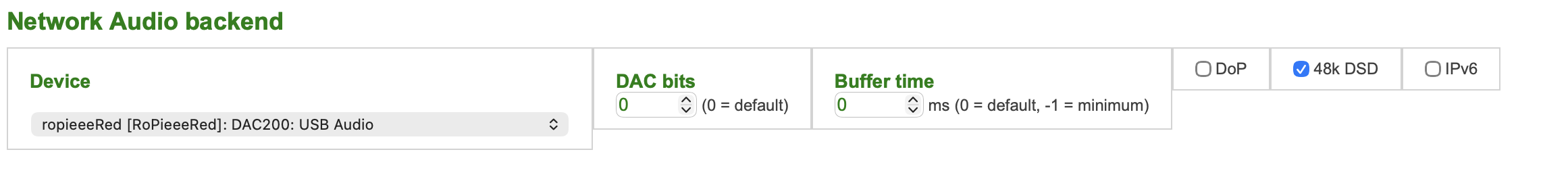

I run an HQPEmbedded server → NAA/HoloRed → Intona → DAC200 (USB @ DSD1024).
For many many months I have been using NAA via RoPieee OS on the Holo Red. It has worked flawlessly, at least since an issue with CM4 was resolved last year. I use default buffer time of 0.
Yesterday I decided to try the NAA517 OS image on the Red instead of RoPieee. It functioned normally, except I started to hear those small dust pops that are always strong indicators of USB packet drops. With default buffer time = 0. I started playing around with increased buffer time and that mitigated it but I never spent enough time tuning it to get it to go away completely - I just went back to RoPieee and it works flawlessly again.
So bizarre and surprising. Obviously, the NAA OS should perform just as well, if not better, out of the box. Subjectively, I was expecting to hear no difference at all of course, particular with the Intona inline.
What do you think it could be? Is the hardware default buffer on the Red via NAA OS not good enough for DSD1024 or something?

I know it is counter intuitive, but you could try with smaller buffer time settings. Try for example 10 ms. Many have found 20 ms to help on sMS-200. Going too low however will start creating drop-outs due to buffer underruns though.

I think I may have solved my issue. Looks like mine was related to FIFO buffer (rather than hardware buffer)
Short buffer (grayed not checked) with hardware buffer on default seems to be very stable. As always YMMV
Sounds like your issue was at the HQServer layer, not NAA/HoloRed. Glad you solved it.
