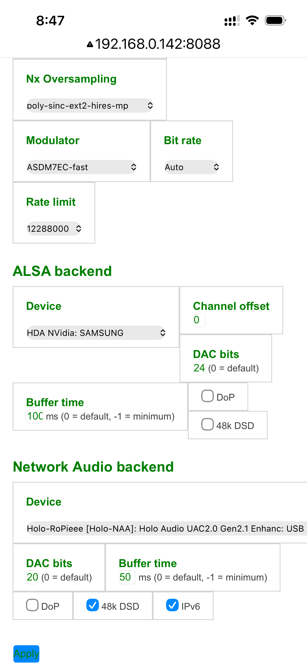

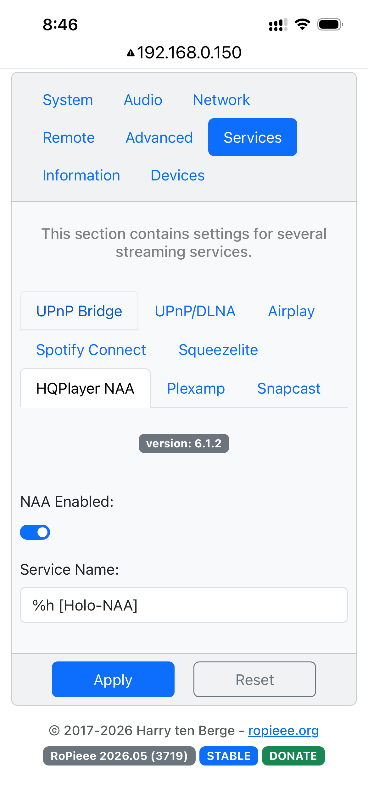

Already using a Rpi4 in that armor case :slight_smile: current version of RoopieXL on there. NAA
Enabled. HQplayer does not recognize the endpoint. Roon DSD512 works through it just fine. (Yes I disabled the dac in roon when I tried HQplayer 6).
Also HQplayer 6 keeps crashing every few minutes.
I’m solid with all kinds of operation systems and I’m also able to handle a few Linux commands and Mac OS console but HQplayer reminds me of a unfinished beta software from 2010.
It’s that frustrating.
I’ve managed to get HQplayer 4 & 5 to work before as trial with the same hardware , so I’m not a hopeless idiot but yeah.. feels a bit random this software.
Maybe not so “solid” …
What version? Can you try using latest NAA version instead? Just flash the memory stick with latest NAA 6.x
What CPU you’re using and what are your HQplayer settings (embedded or desktop)?
For this, I think a good approach would be to enable logging and when you get it to crash again, check the log to see if there’s anything informative… if you find anything I’d send it to the signalyst email and @jussi_laako can further assist.

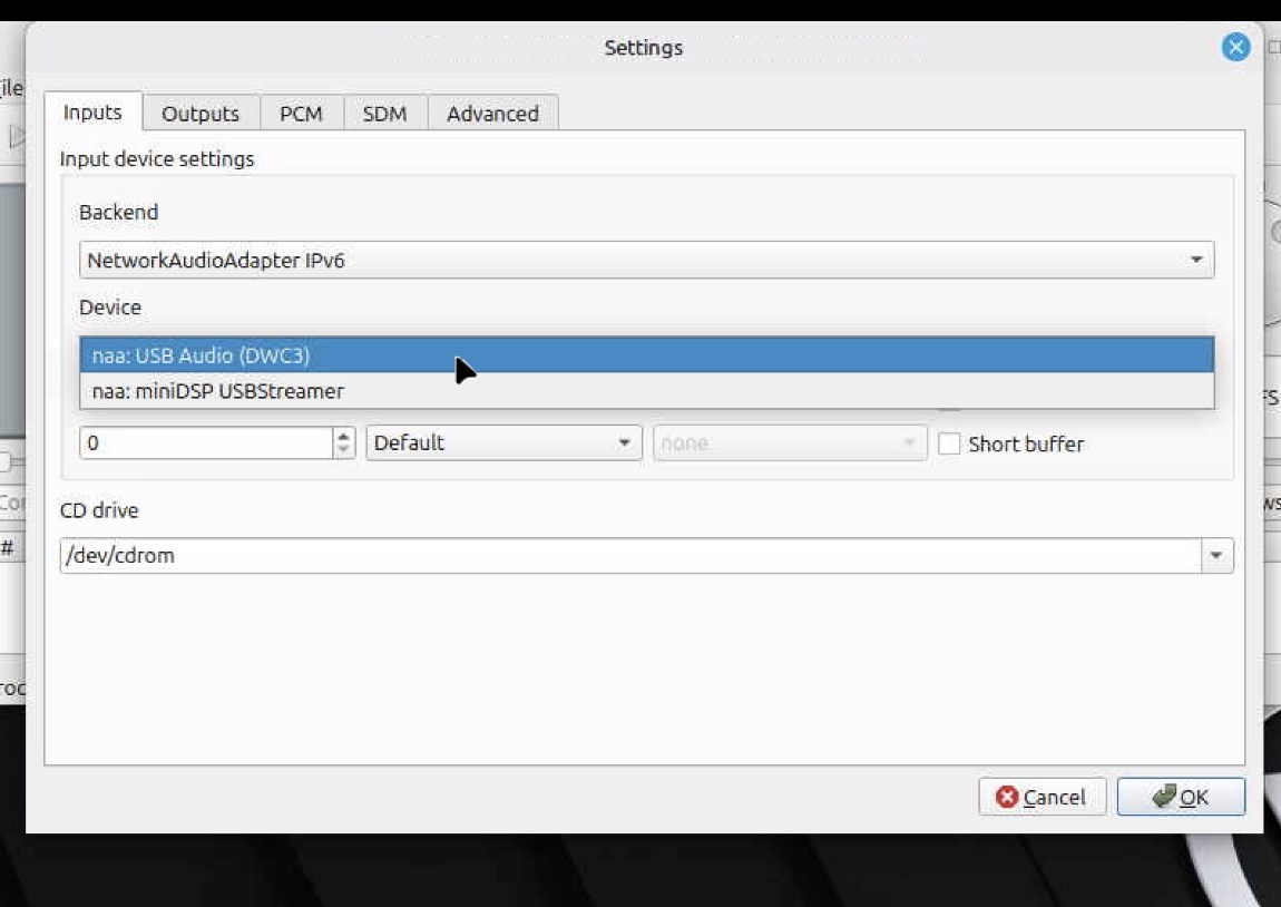

It seems when connecting a shield to the NAA using a usb micro to usb a cable, hqplayer sees the naa , but shield doesn’t see or recognize the NAA or hqplayer so usb audio cannot be selected as an option on the shield.
It will only come up once you start playback from HQPlayer… So first load the input URI and start playback and then check if Shield allows you to output through USB.

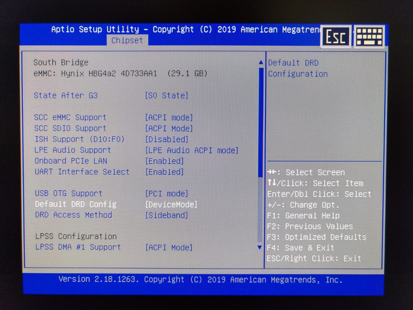

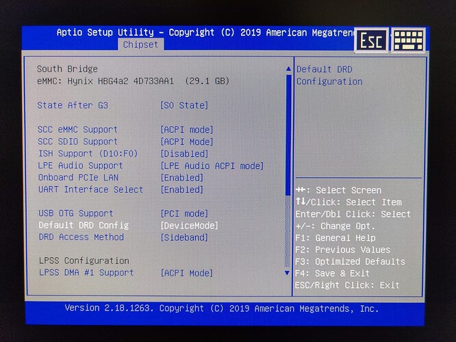

I assume you switched the microUSB into device mode from BIOS settings before booting up the NAA OS?
I did go poking around the bios. As you said, there’s not to many settings for that port. I couldn’t find anything listed device mode or anything about voltage but there was a setting for ACPI or PCI for that usb port (is that what you were referring to about device mode?).
What should that be set to?
Also is there any terminology specifically I should be looking for in regards to that port?
I found a screen picture from my work phone related to that setting:

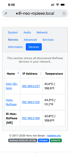

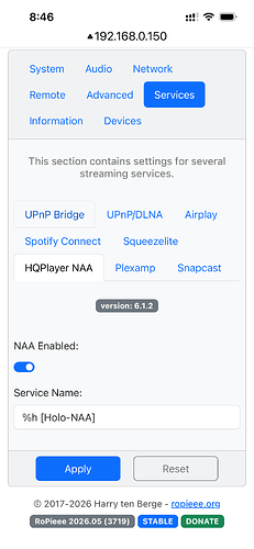

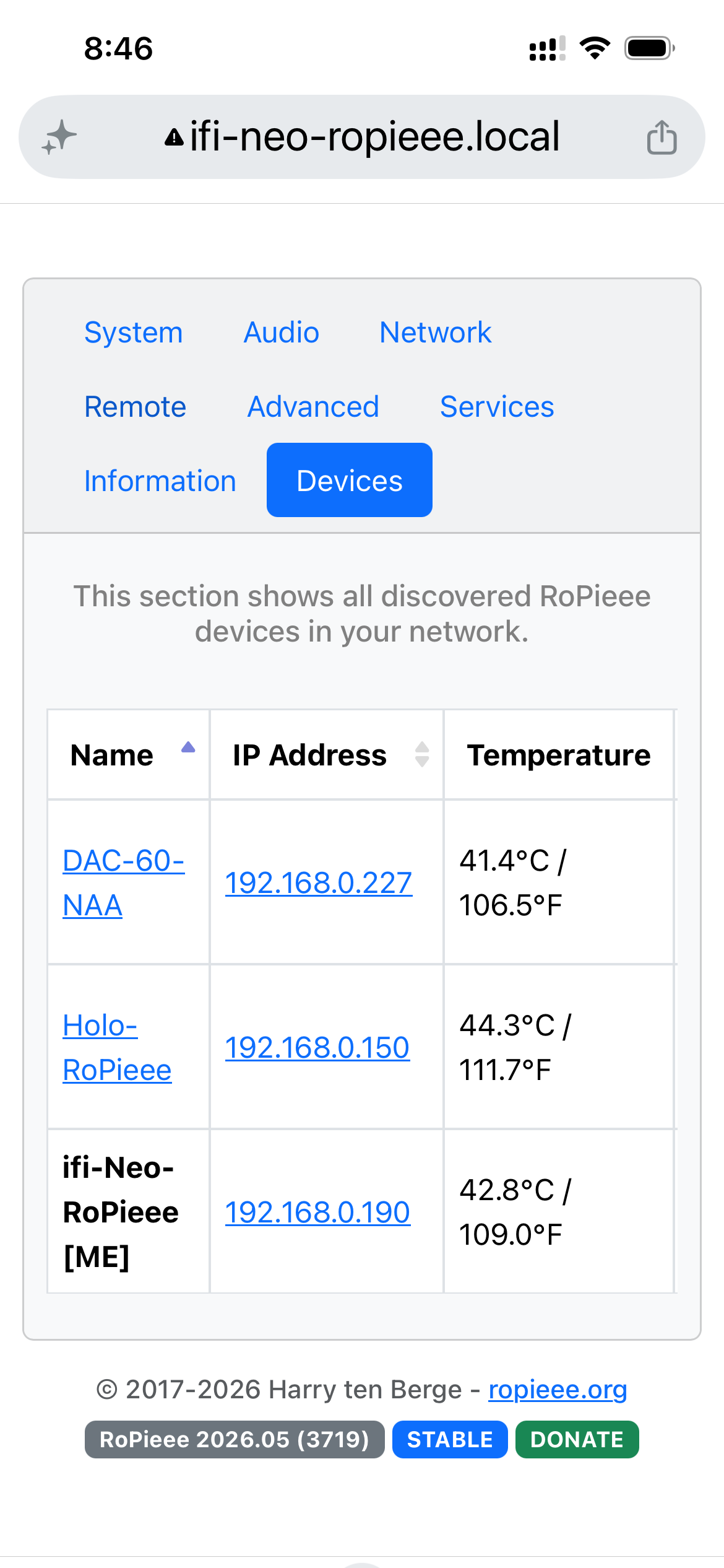

I found RoPieee a great way to manage and update various NAA points. Just flash once a see more info of your Rpi4. NNA updates can be done on same web interface.

I updated my RPi4 to “naa-614-raspberrypi-holored” NAA OS version.
Now HQP do not find my RPi4 anymore.
HQP and Roon are on a MAC Mini M1 with Tahoe 26.6.2. MMM and RPI4 are connected via LAN. I can see the RPI4 in my network monitor.
Do I have to set some permissions in MacOS for this to appear again?
EDIT: After updating to HQP 5.17.2 everything is back to normal. :slight_smile:
