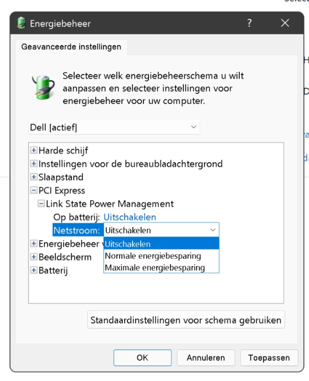

Old thread but still relevant.
Going from W10 to W11, I was suddenly not able to upsample above 88.2 without distortion.
The processor got trottled by eco settings.
Goto energy management (battery icon on my laptop), advanced settings, PCI Express, Link State Power Management, is was on max energy saving, I disabled this, presto now I could upsample to 705 and anything thrown at it.
Also the setting below PCI Express, check if nothing is economized there. It was not in my case, but just check.
Sorry, it’s dutch :wink:

in my case there was no high-performance setting in that list to choose from, only BALANCED and DELL.
So I changed the DELL settings as shown in that pic.

in that vid they forgot to mention that PCI EXPRESS setting I referred at, which was my bottleneck as all other options were maxed out already. That vid was good too see if nothing was forgotten.
