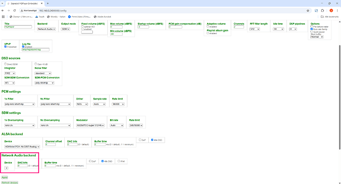

When my dac 200 is power off, this is what the configuration looks like:
so no devices at all

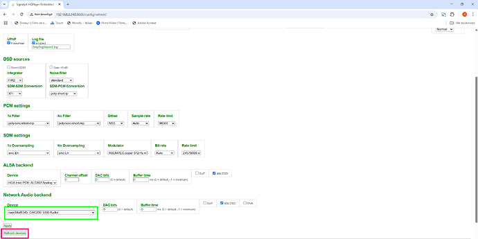

after powering on my dac 200, and ‘refreshing devices’ , configuration looks like this:

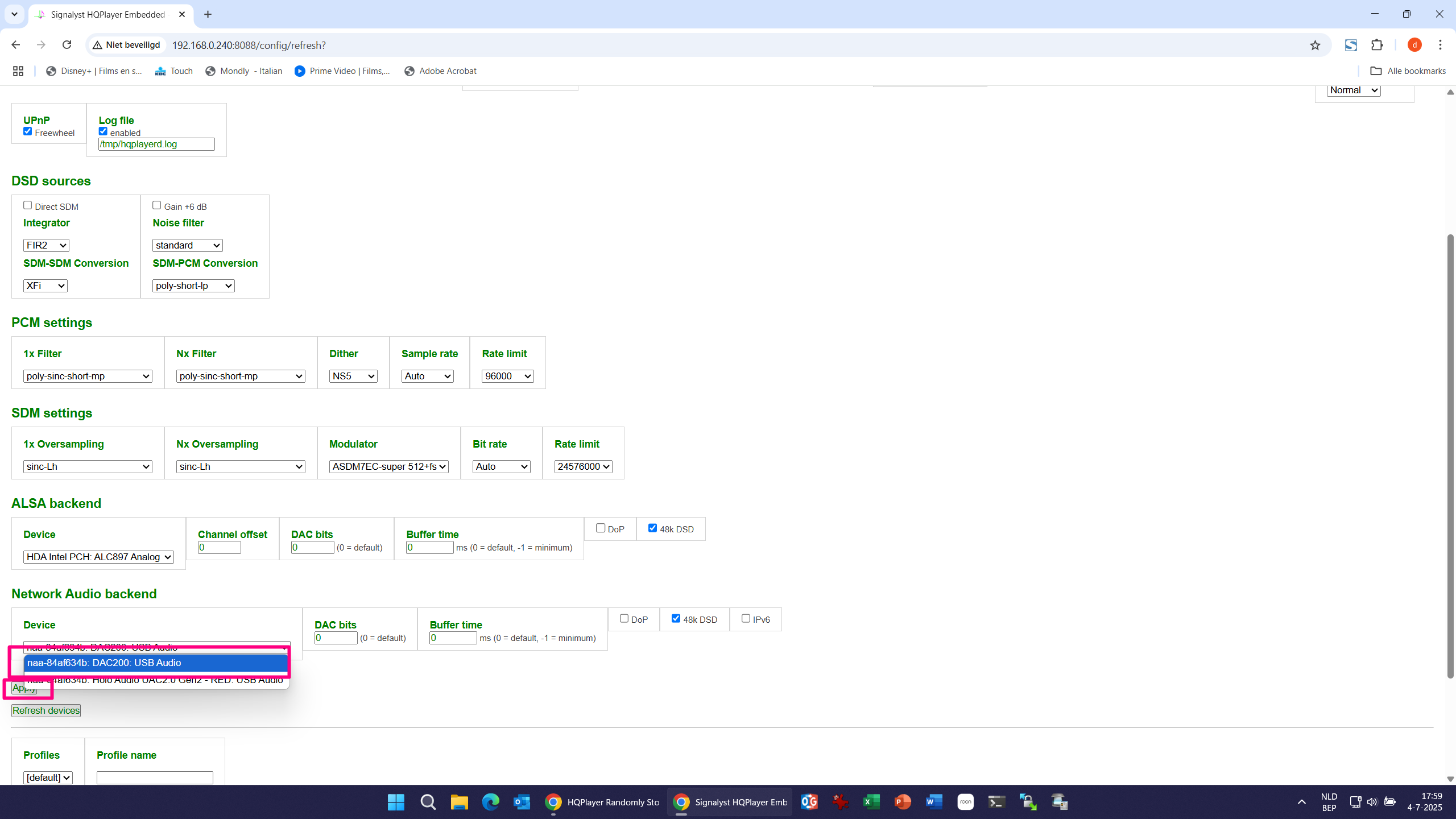

which is the wrong dac interface

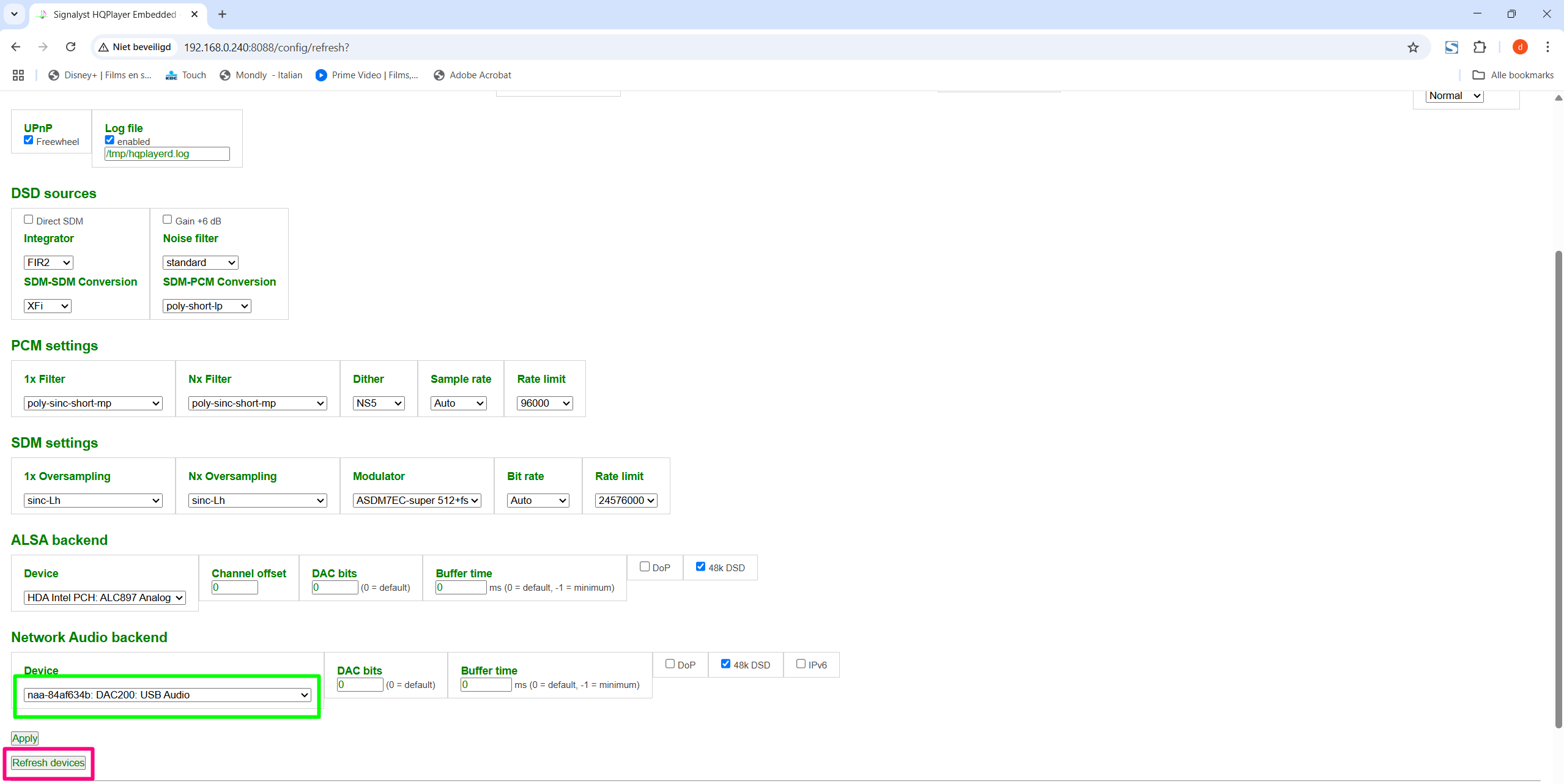

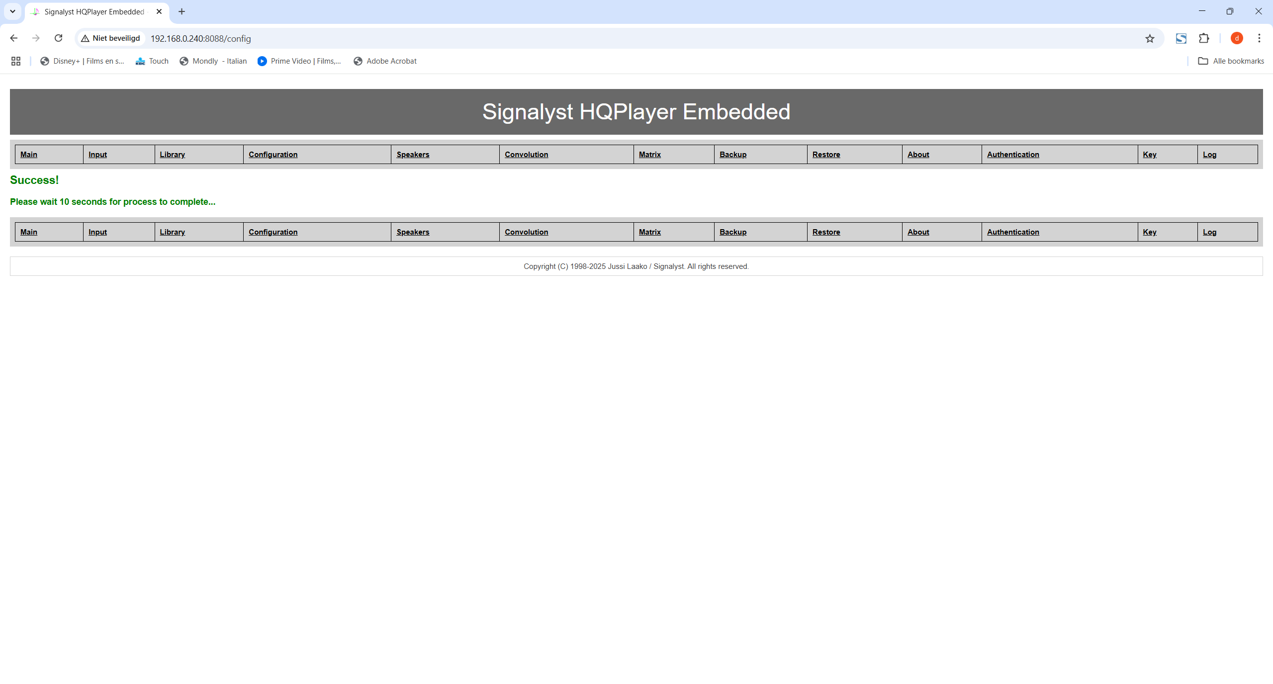

Selecting the right interface and then Apply to get the right naa interface
From then on, you should be OK, as long as you remember to power on your dac before you play any music. As your Holo RED is a low power device, I advice to leave it powered on all the time (that’s what I do anyway).
