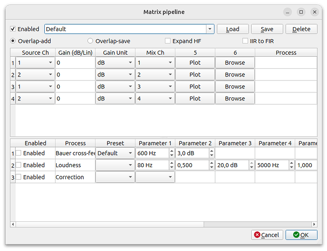

First remember to set number of output channels to 4 in HQPlayer settings. Then in matrix setup, route source channels 1 and 2 also to output channels 3 and 4.

How and where in Matrix setup, do I route source channels 1 and 2 to output channels 3 and 4? Please, can you elaborate how? which fields? Could not find anything related under the Matrix tab.
This is how it should look like:

I did follow your Matrix pipeline settings the Default parameter at the top cannot be chosen from a list. It might be a user defined name for storing a matrix configuration.
Compared to your screenshot, I have more than four lines on the upper table, does it matter?

Not really, this can be adjusted from the Advanced tab in settings (number of pipelines).

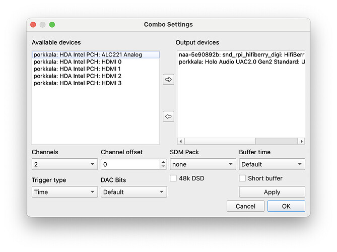

On combo screens, the settings are for each selected output device:
So if you select one of the outputs chosen for combo device, you can set additional parameters for it using the settings below (those apply for the device selected on the right “Output devices” list). By default it is two channels, since stereo devices are most common.

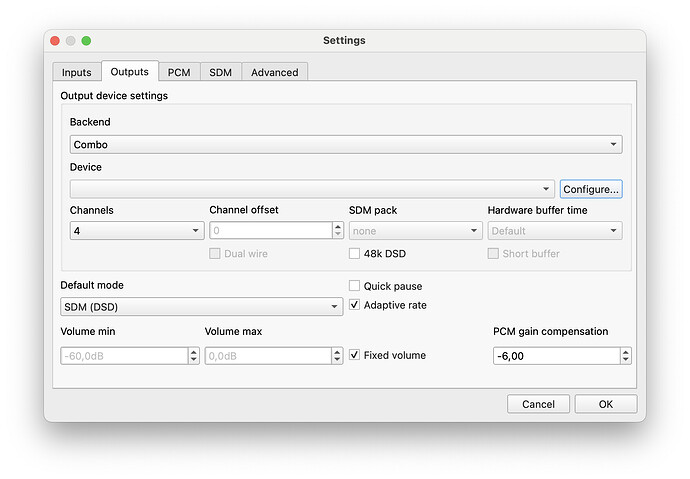

On output tab it is total number of output channels and should be 4 if you have configured two stereo output devices for the combo:
With these settings I don’t get any crash…

Then i will set the combo, as in your screen.
Then i will mix the channels matrix pipes.
