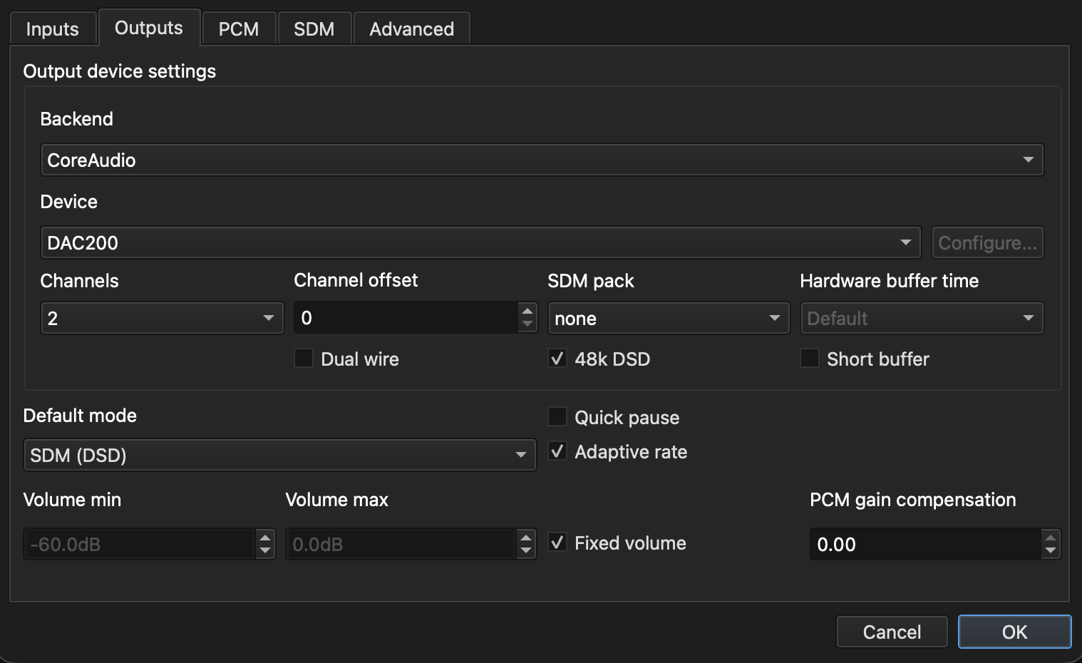

I just set it up like this and yes it is working but wasn’t there something on a MAC why we needed the VM? I cant recall this anymore? Also the DAC200 is now saying DOP 256 (if I switch off DOP then I see PCM 7xx) instead of DSD. Here are my settings. @jussi_laako THANKS
With DAC200, you can also enable “48k DSD” and make “Adaptive rate” checked, and select 48k x256 as rate limit, to lower your CPU load somewhat.

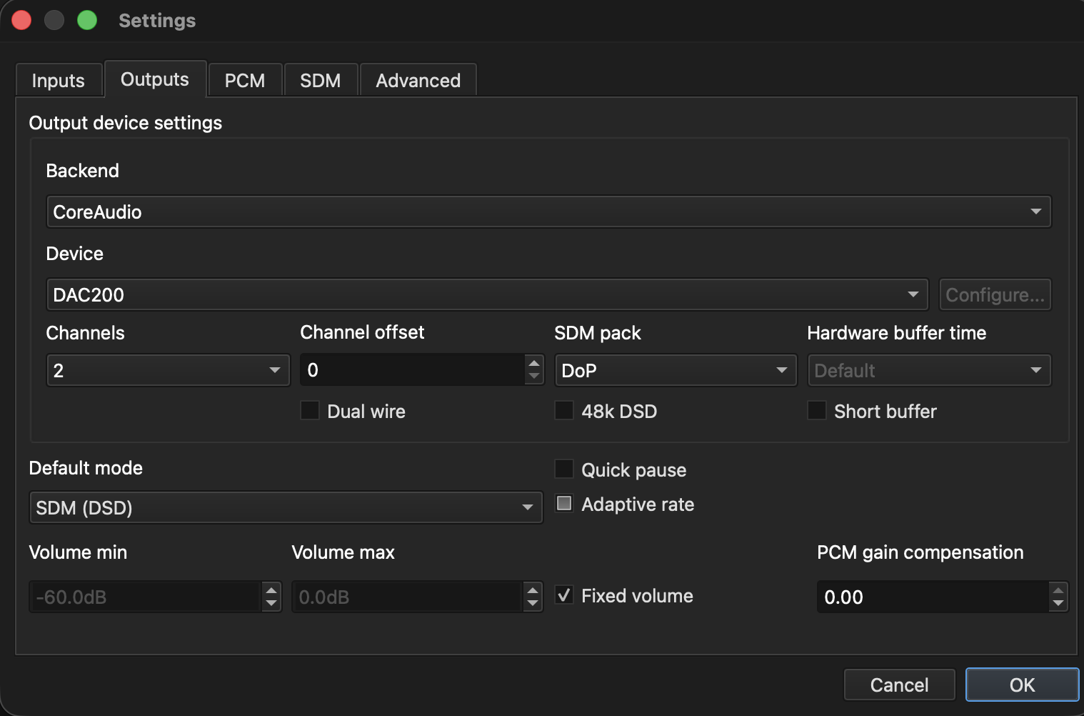

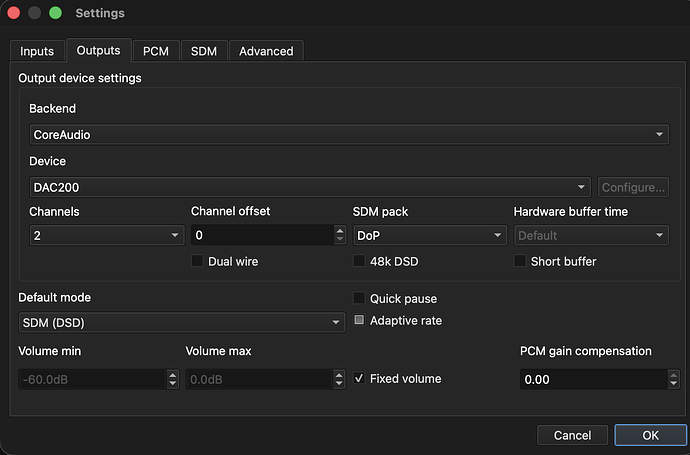

Hey I changed the settings but I am only getting PCM not DSD. Why is that? @jussi_laako thanks.
“SDM pack” should be set to “DoP” here. As CoreAudio doesn’t natively support DSD. So DoP method is needed to work around this limitation when playing through CoreAudio.
