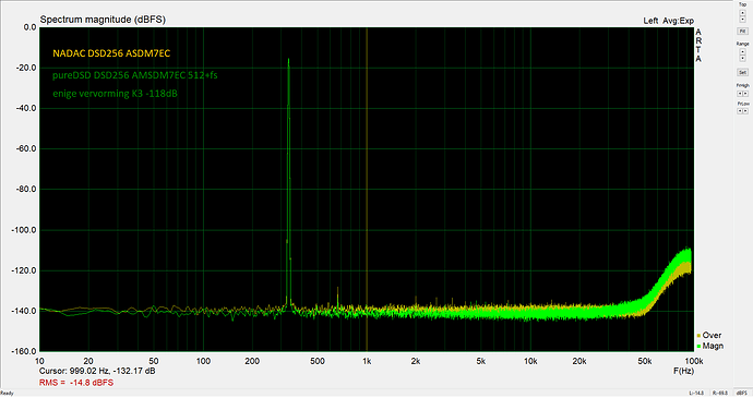

Here one guy compared DSC2 (board by PureDSD) vs his Merging NADAC (ESS chip)
Both fed with DSD256 from HQPlayer
