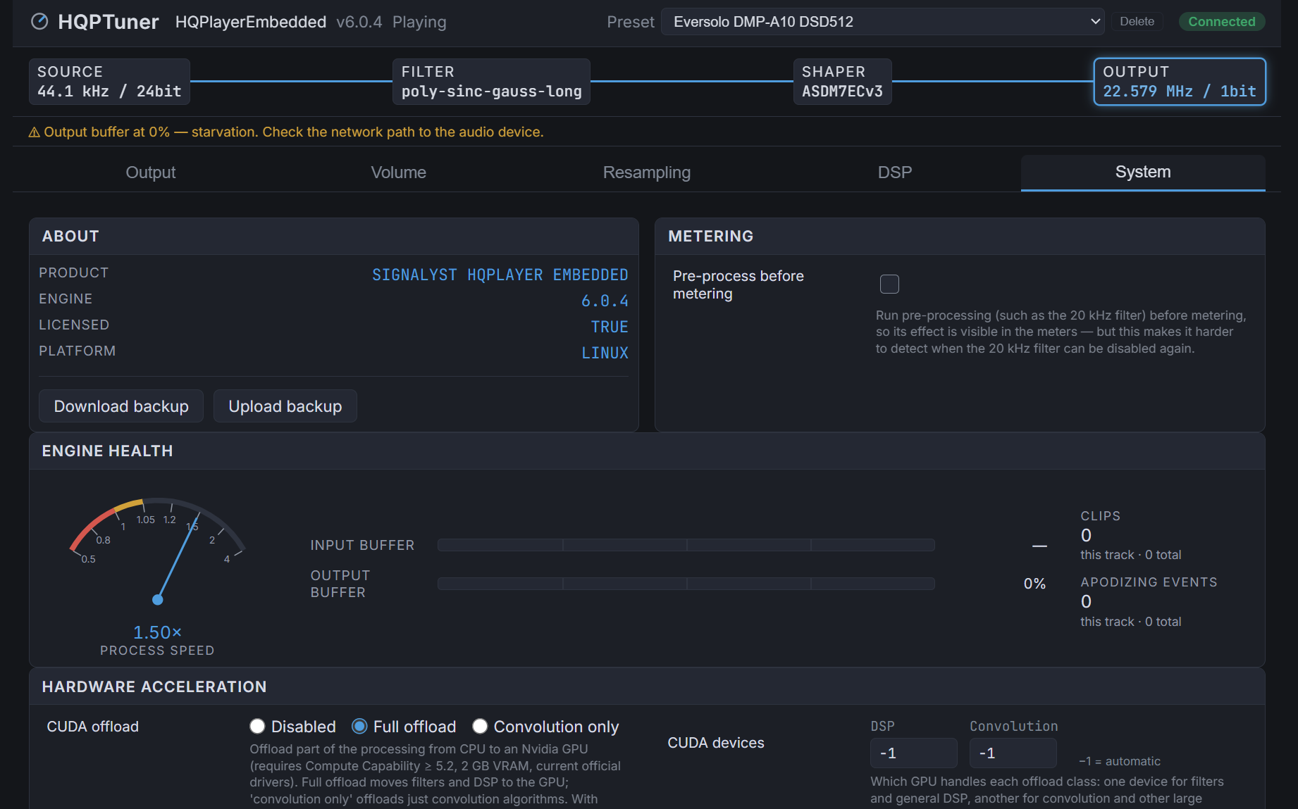

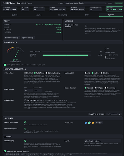

Haha, “working great” is quite generous given the glaring error at the top of your screenshot, so thank you very much! :smiley:
I’m working on fixing the bug when the output buffer is simply reporting 0 instead. I’m seeing that now with my speakers output as well.
It’ll be a hot minute before a fix gets pushed to the master repo, since I’ve also added a “structural” crossfeed alternative to the built-in Bauer implementation. Sounds absolutely awesome once your head size is dialed in, super spacious. But its interaction with existing pipelines and/or loading an EQ profile on top of the crossfeed pipelines are complicated enough to be buggy in ways that are difficult to track down with normal usage.
For example, the warning in the screenshot above… well, they WERE routed straight through until I engaged that feature!

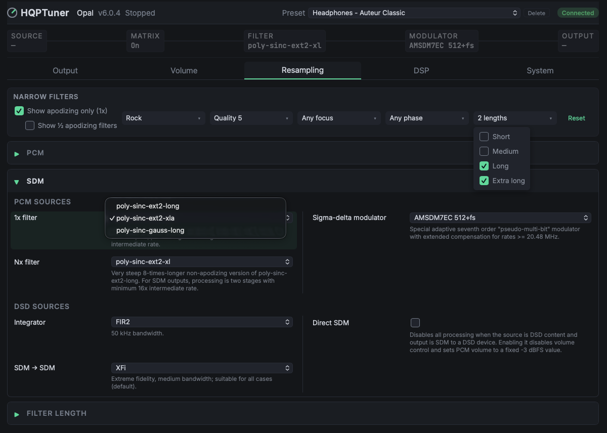

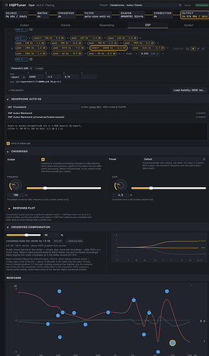

  1. Filter narrowing via five drop-downs (genre, focus, quality, phase, length). Only show apodizing filters for 1x content by default and/or half-apodizing filters. Rather than sorting through a list of 50+ filters with the PDF open in another window, you’re down to a handful of relevant filters with a few clicks.
  2. Headphone Auto EQ integration: Over 8,800 headphone correction profiles directly in the UI. Type in your headphones, select and apply the EQ curve, restart daemon. Done.

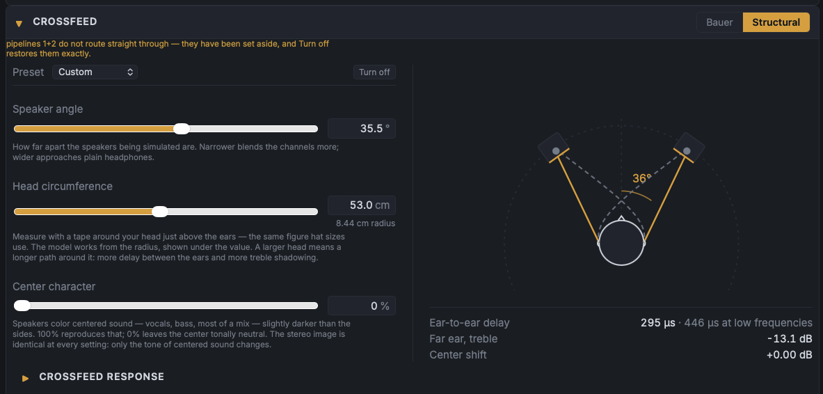

  3. Structural crossfeed: I am a huge fan of crossfeed, but Bauer doesn’t do it for me. So I wrote a structural crossfeed implementation with proper delays/HRTF and everything that loads in a few clicks. Measure your head’s circumference, input the value, tune the rest to taste. And for those of you who do like it Bauer-style, I’ve included crossfeed treble compensation—the first case I’m aware of of crossfeed compensation being applied to someone else’s DSP chain (Meier and CanOpener both own their entire DSP chains).

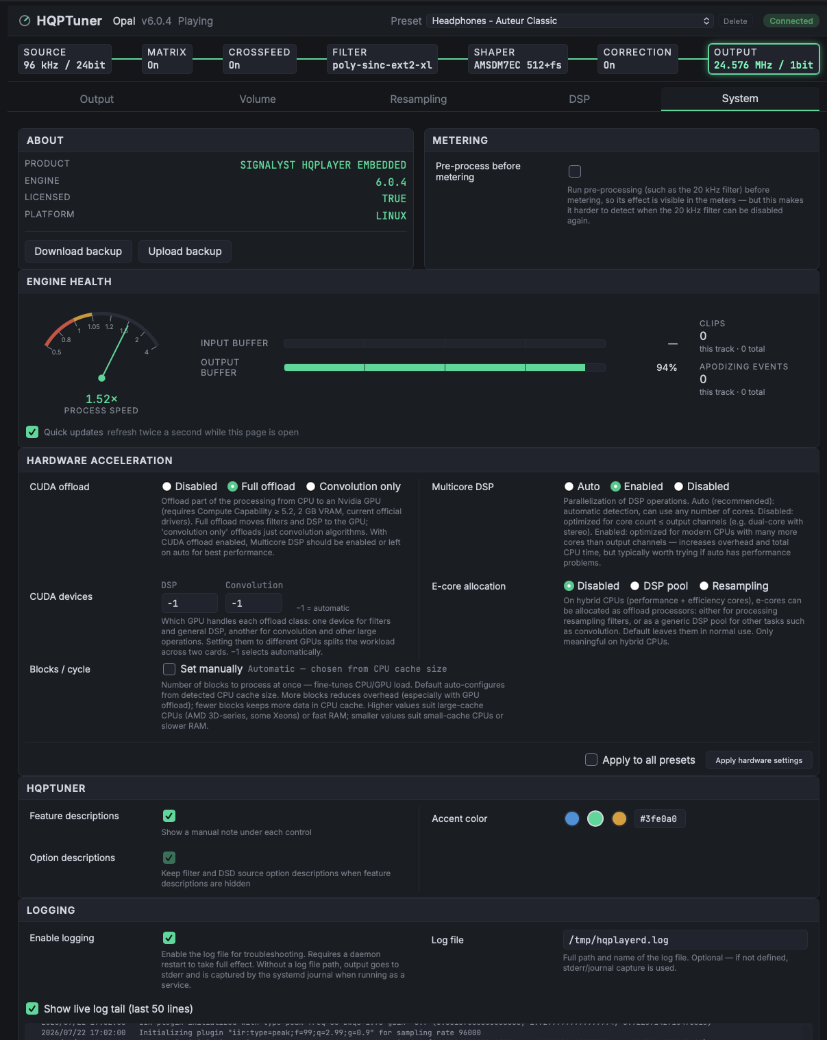

  • Hardware acceleration settings: Those settings you normally have to write to hqplayerd.xml to enforce? HQPTuner has them in the UI, with full descriptions right there, so you can easily play around.
  • Better organized: HQPTuner has five tabs: Output, Volume, Resampling, DSP, and System. I’ve scrapped a lot of the original organizational system for my own so things are where you might expect them to be.

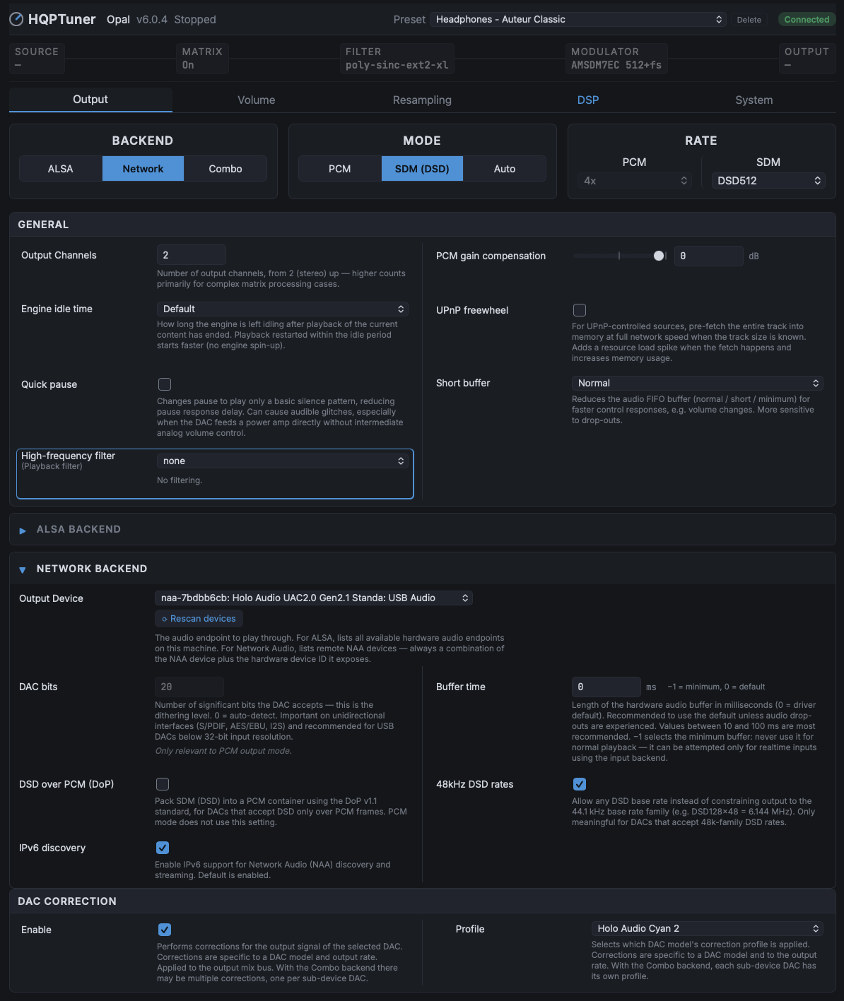

Fig 1. Filter narrowing in effect. Showing 1x filters matching “genre: rock”, “quality: 5/5”, and “long” or “extra long” which are also apodizing.

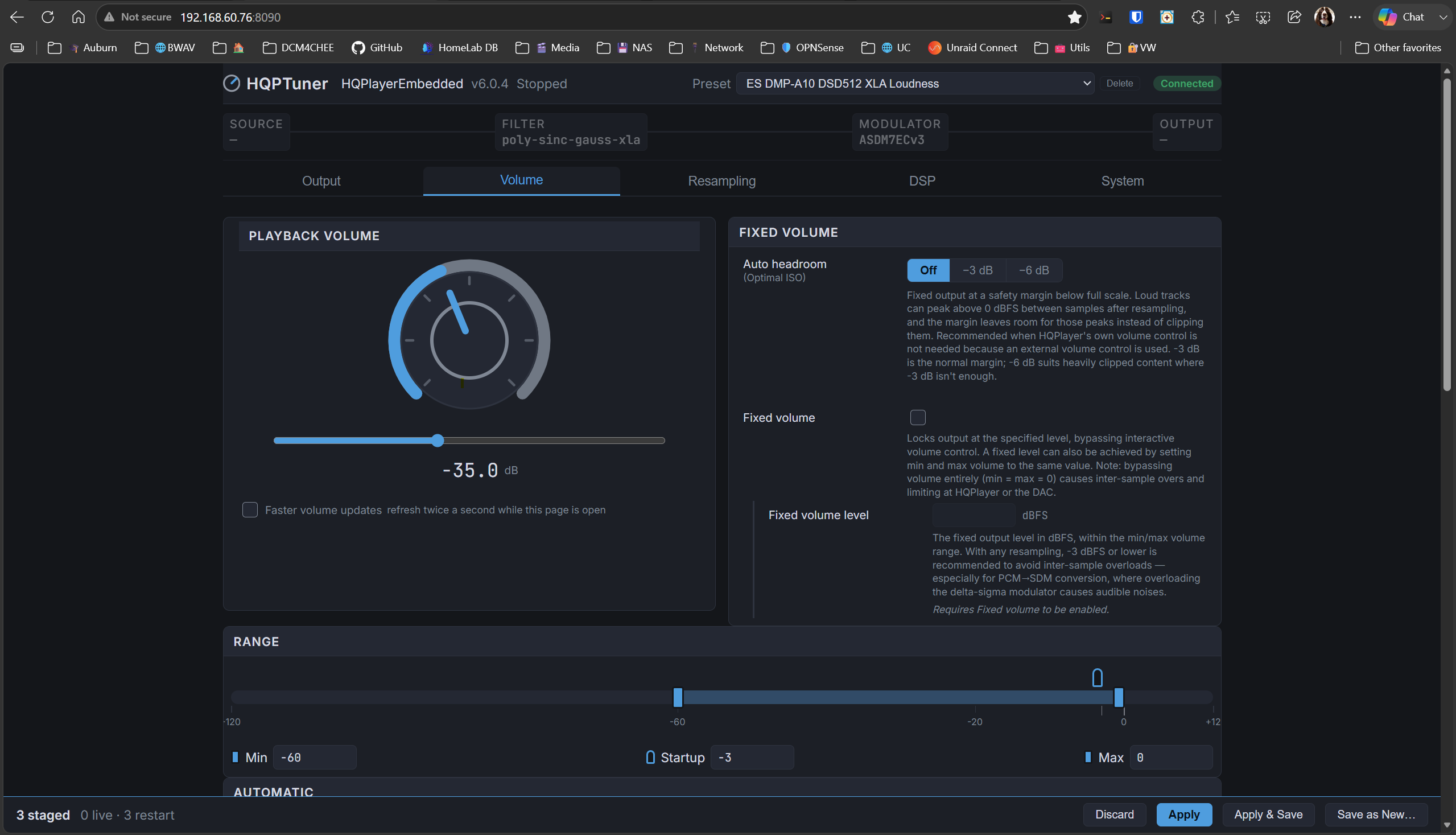

Fig 2. Output tab. Changes (e.g. high-frequency filter) are highlighted in the selected accent color. Irrelevant settings (ALSA backend, DAC bits) are collapsed and grayed respectively.

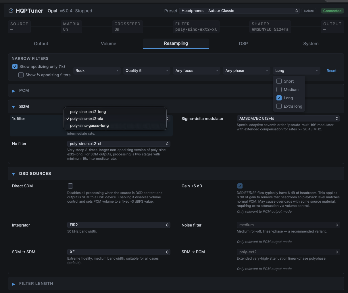

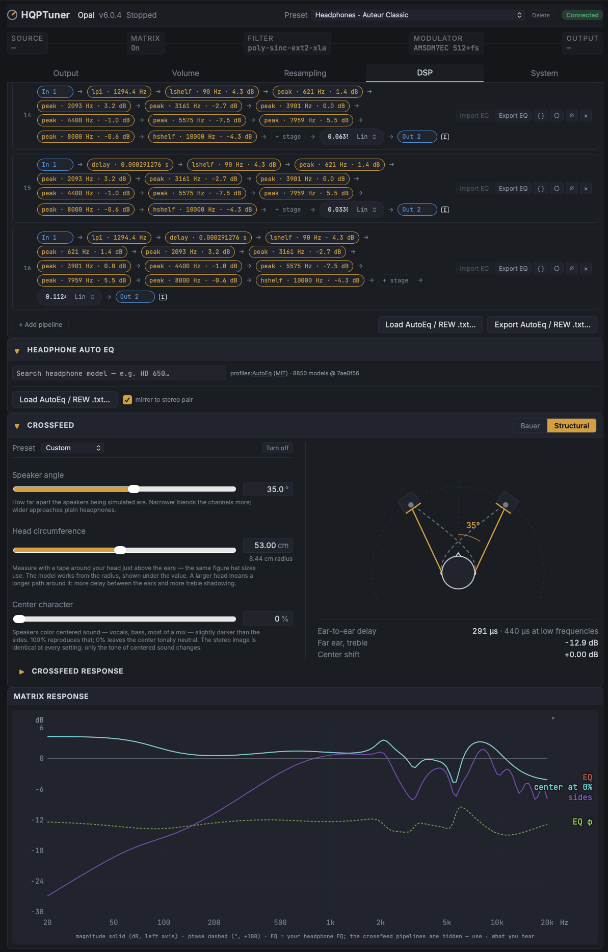

Fig 3. DSP tab showing structural crossfeed + headphone EQ + REW-style interactive response plot.

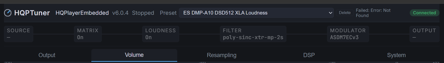

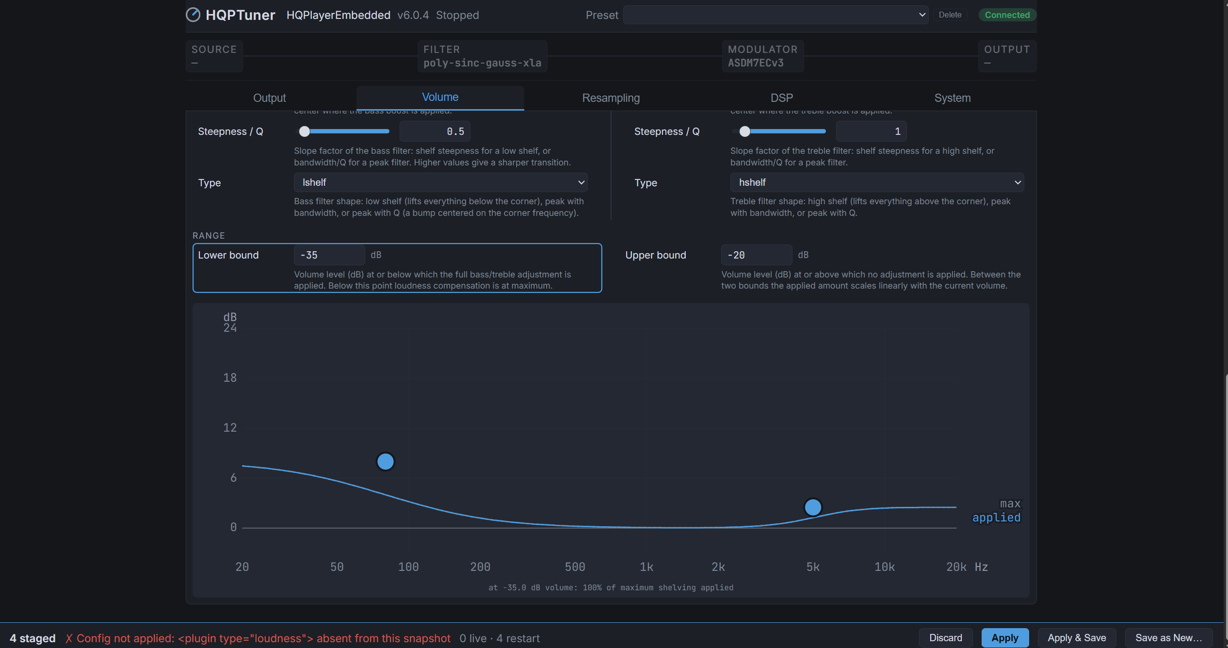

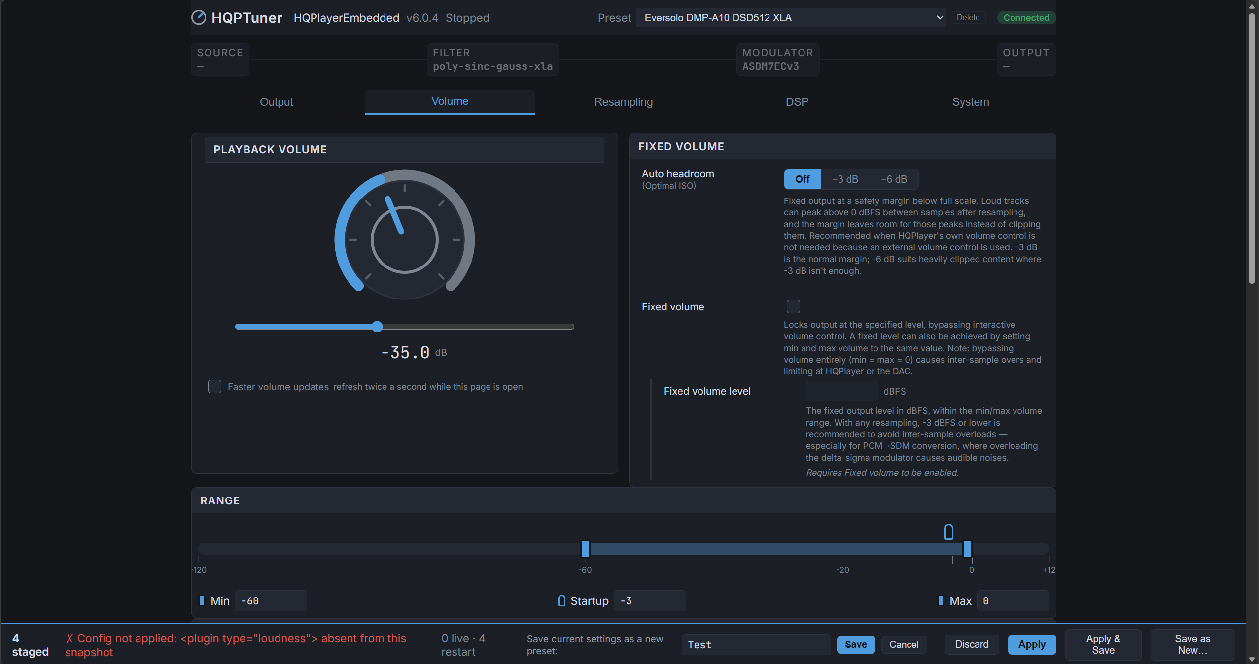

Having an issue saving profiles. Using Edge, make my changes, apply, save as new, give it a name, save, hard refresh, and never shows up. Is my workflow incorrect?
Thanks
Good catch! Working on a fix now, should ship soon.
EDIT: try now! It was a focus issue, something really stupid that I should have caught before.
Solved, I think. Permissions issue on my end.
Moved to same VM, same issue, can’t seem to save any presets and restarted hqplayerd manually. May be it’s my workflow?
Same issue, let me move HQPTuner to same VM as hqplayerd, will follow-up.

Can you DM me the HQPTuner logs and let me know of the stock web UI shows a named profile active? Or, if you’ve solved it, let me know what the fix was!
Yes, the permissions and moving to same hosts did not address the issue. I was finally able to save a new preset, but when I go back in and make changes under Volume Tab and click apply and save changes, stale, see picture. Also, I manually restarted hqplayerd, same issue.
…and this:
✗ Config not applied: daemon returned an unusable /backup (known 6.0.4 bug after a profile load/save); refusing to build a restore from a stale cached archive — restart hqplayerd, then retry
From Claude FWIW:
That error is the real culprit behind everything tonight — and now it’s naming itself. This is the HQPlayer 6.0.4 /backup bug: after you load or save a profile, the daemon’s /backup endpoint hands back a stale/unusable archive, and HQPTuner (correctly) refuses to apply config without a good restore point. Since you’ve been saving and loading presets, you keep re-triggering it. It’s not your setup, not permissions, not the container — it’s a daemon bug.

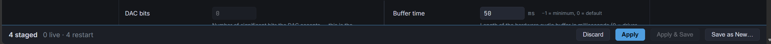

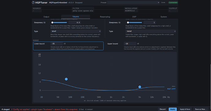

No dice, made some changes and tried to save as a new preset.
4 staged✗ Config not applied: absent from this snapshot0 live · 4 restartSave current settings as a new preset:SaveCancelDiscardApplyApply & SaveSave as New…

I think I’ve cracked it.
HQPlayer only writes the parts of its configuration file it has had a reason to write, it never fills the rest back in. If you’d never set up loudness, or never switched matrix processing on, your file simply had no loudness or matrix section in it. HQPTuner could edit what was there but couldn’t add what wasn’t.
Try :beta again.
Same problem, recreated container and made some changes from volume tab, hit apply and save. Using the tag :beta, here is my compose for reference:

Damn… I can’t reproduce this for the lfie of me. DM me the profile you’re trying to save to when you get a chance. There’s something in there that’s not in my fresh profiles that’s causing the bug.
PS you should remove the /tmp/hqplayerd.log file from the volume mounts. the container now gets its logs directly over HTTP. /tmp/hqplayerd.log can cause HQPTuner to crash on startup if Docker comes up before hqplayerd.
PPS be sure it’s a fresh pull, that error text appears to only match an older version without the above fix
I removed all presets, restarted hqpleyrd, updated hqptuner stack, removed volume mapping for logs, and was able to create a new preset w/ volume and loudness settings with one exception. When I set the volume to -35 and apply and save, reverts back to -3, does not stick.
Also If I select default from top right I see this:
Also, using :beta
Great work on this, looking forward to this maturing. Let me know if you need anything else.
Thanks
