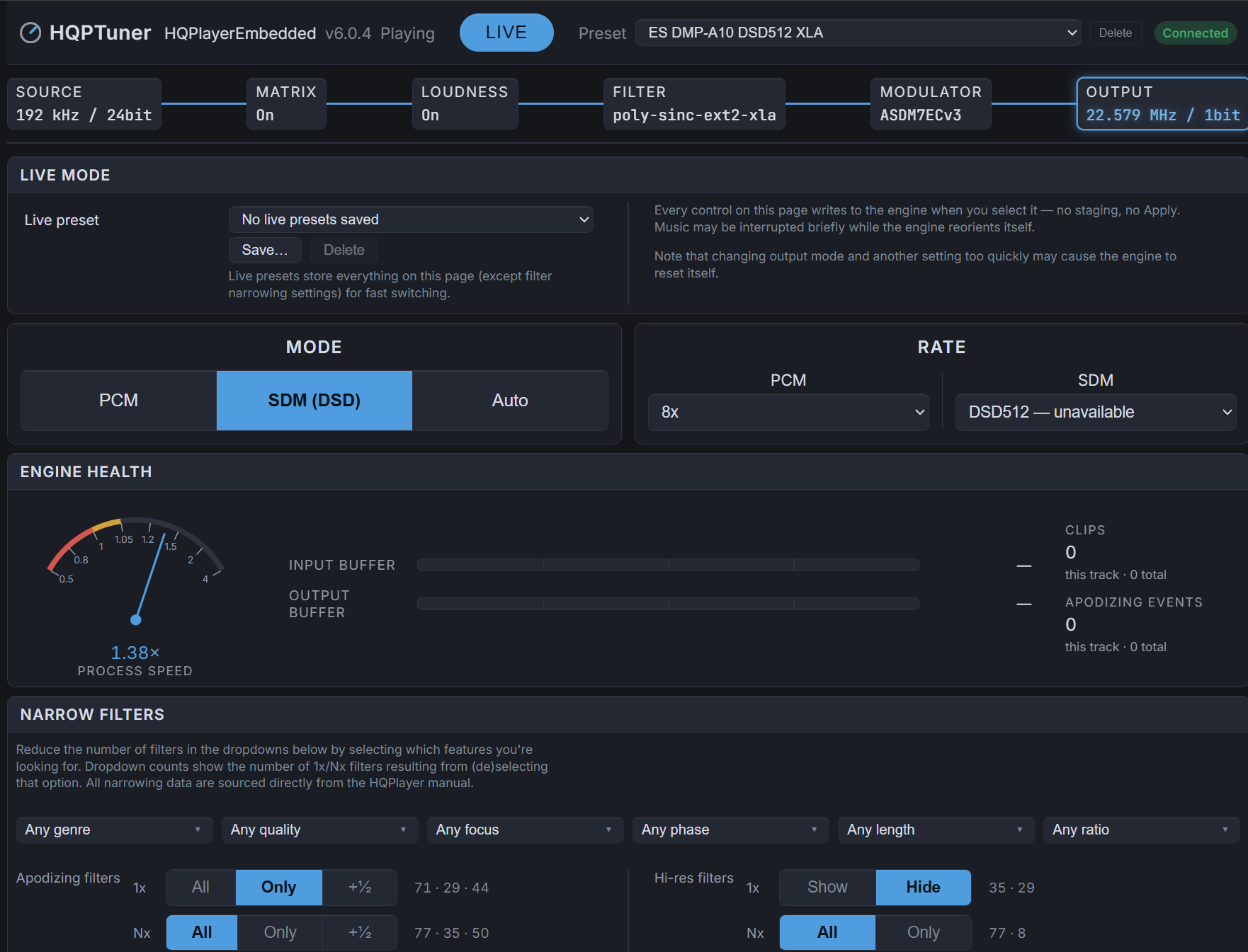

HQPTuner: an improved configuration interface for HQPlayer Embedded

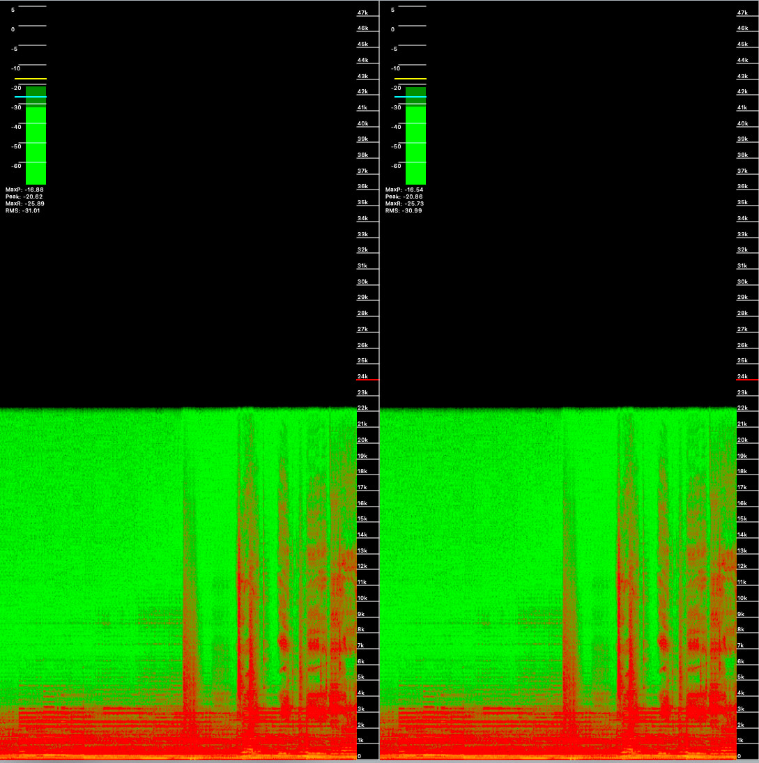

Really? That’s interesting… I guess I was reading the spectrum wrong, I saw those spurs up high and thought “oh, 30kHz junk filter material!”
And yes, that is definitely genuine hi-res.
My fake hi-res file looks like below, pretty unambiguous.
If you have further reading on this stuff, I’d love to take a look at it! Thanks!
Yes, this is certainly a fake hires, 96k made out of 44.1k. Pre-upsampled content. Not a bad one though. You could still apply a 20k filter on it, since the source material seems to be quite bad (and seems to have gone through a half-band filter). Will give you a bit of improvement.
Jussi, your feedback is always invaluable, so thanks again.
HQPTuner still detects HF spurs, but will no longer assume bunk causes. The warning now reads something like:
Persistent tone at 40.0 kHz — recommend switching to a ‘hires’ resampling filter or engaging the 30k high-frequency filter.
It recommends a ‘hires’ filter before the 30k junk filter, but ultimately the user can decide. Or ignore it.

slight correction: hifiberry-digi-pro is capable of low DSD rates over DoP.

I’m guessing your DAC doesn’t support 48kHz DSD rates… but both of mine do, and that’s what I developed against. So when HQPTuner sees the lack of those rates, it incorrectly declares the entire family unavailable. Oops.
Fix shipped to :beta under v1.0.2, switch over and see if it’s still declared unavailable.
