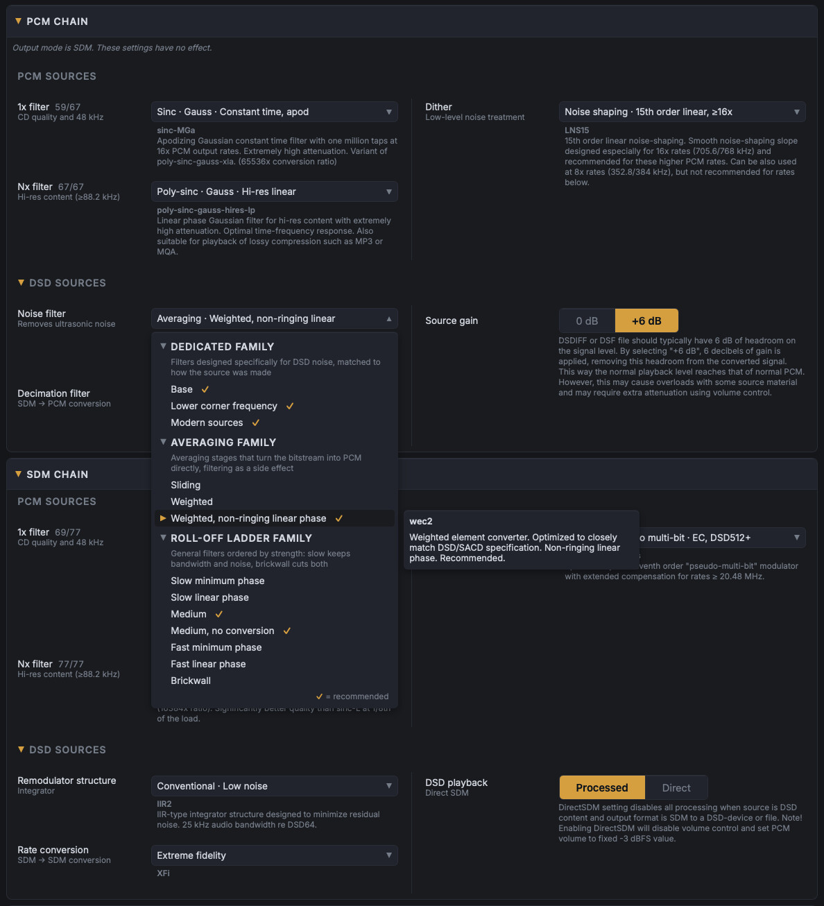

Another new version is up, v1.11.1, but this one is limited to :beta for now. If you want to try it out, change compose.yaml to image: oh💩gorillas/hqptuner:beta then re-pull and re-build. But replace the emoji with… y’know :wink:
Two big changes:
Simplified option mode extended to DSD Sources
Yes, now you can read the DSD sources features in plain English as well!
In my opinion, these are some of the most baffling settings in the entire program and some of the most difficult to suss out how to use… so they needed this treatment badly.
The reason this release is in beta is because I am waiting on Jussi to confirm the accuracy of the language, if he so chooses. I have pretty tightly hugged the manual with the descriptions, but there’s always the chance that some wording needs tightened up or changed to maintain full accuracy. Take these with a grain of salt for now.

DSD Source options in plain English
As with v1.11.1, Simplified option mode now extends to DSD Source settings with approved sorting and names (thanks, Jussi!).
Renamed features (traditional names are always printed below the new name):
  • SDM to PCM conversion is now “Decimation filter”
  • Integrator is now “Remodulator structure”
  • SDM to SDM conversion is now “Rate conversion”
A shot of the PCM and SDM chain cards in Simplified mode:

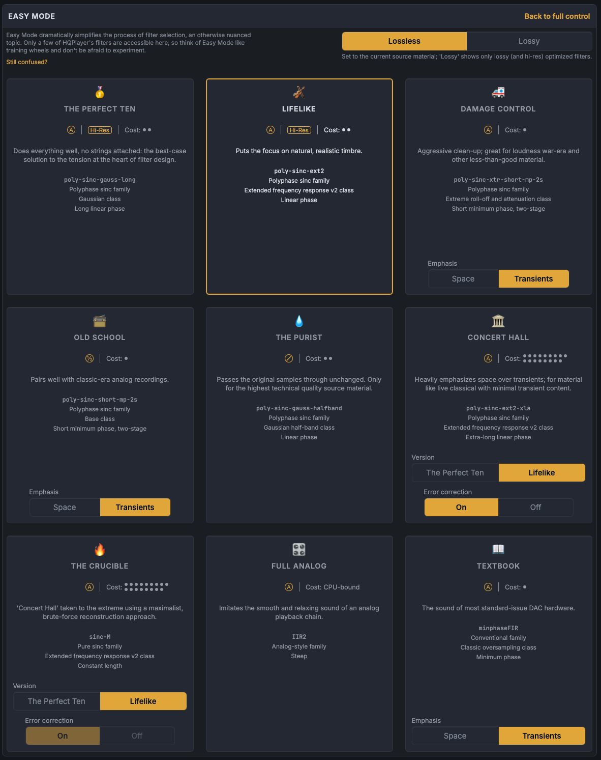

No new version for today, but I wanted to get people’s feedback on an idea I had: a truly easy, simple, plain language system for picking a filter. Something so easy an idiot could do it.
I didn’t think such a thing could be done. I thought it was genuinely impossible. HQPlayer has too many filters/settings with too many variables. You can’t just generally recommend filters beyond the defaults. It’s just too complicated.
…I think I’ve done it.
I call this Easy Mode. The language and settings here are still pending Jussi’s review, however, I also wanted to see if anyone in the community has further suggestions, feedback, criticism, etc. Don’t hesitate to let me know what you think, even if it’s to tell me how bad the idea is.
Constraints: Filter selections should be:
  • Capable of any rate change
  • Apodizing, except when otherwise explicitly noted to the user.
  • 4/5 Quality or better.
There are two non-apodizing choices and one half-apodizing in the list, and only one 3/5 filter—and that option comes from an old comment from Jussi pairing poly-sinc-short-mp(-2s) to old school analog prog recordings.
Without further ado, I am extremely proud to present: HQPlayer Filters for Dummies v2
Playlist mode
Playlist mode is when you’ve got a mix of different material and source rates back-to-back. It only has two settings.
:1st_place_medal: The Perfect Ten
Does everything well, no strings attached. Start here.
1x: poly-sinc-gauss-long
Nx: poly-sinc-gauss-hires-lp
:violin: Lifelike
Puts the focus on natural, realistic timbre.
1x: poly-sinc-ext2-long
Nx: poly-sinc-ext2-hires-lp
Album Mode
Album mode is for when you know what you’re getting and can optimize for a specific recording. Each preset also comes with an Emphasis sub-option for fine-tuning transient performance vs space via either phase or length. It sets both the 1x and Nx filters to the same setting for consistency in albums containing multiple rates (I have a few).
Does everything well, no strings attached. Other presets are trade-offs. Start here.
Emphasis [ Space | Balanced | Transients ] → gauss-long | gauss-medium | gauss-short
Note: ‘Transients’ corrects errors less aggressively than ‘Balanced’ or ‘Space’; if it sounds harsh, try another setting.
:sparkles: The Perfect Ten: Hi-res Mode
A version of The Perfect Ten optimized for rates 88.2 kHz and up. Also suitable for lossy MQAs and MP3s.
Emphasis [ Space | Transients ] → -lp | -mp
:violin: Lifelike
Puts the focus on natural, realistic timbre. Perfect for live performances.
poly-sinc-ext2-long
Emphasis [ Space | Balanced | Transients ] → ext2-long | ext2-medium | ext2-short
:radio: Old School
Excellent with classic-era analog recordings. Less aggressive error correction; if it sounds harsh, try another setting.
poly-sinc-short-mp
Emphasis [ Space | Transients ] → -short-lp | -short-mp
Note: use -2s when available
:droplet: The Purist
Passes the original samples through unchanged. Consumes more resources. No error correction: only recommended for the highest technical quality source material.
poly-sinc-gauss-halfband
Emphasis [ Space | Transients ] → gauss-halfband | -gauss-halfband-s
:ambulance: Damage Control
Aggressive clean-up for loudness war-era and other less-than-good material.
poly-sinc-xtr-short-lp-2s
Emphasis [ Space | Transients ] → -lp- | -mp-
:classical_building: The Concert Hall
Emphasizes the recording’s space at the cost of poorer transient performance more than other presets. For material like live classical with minimal transient content. Consumes heavy resources.
poly-sinc-gauss-xla
Version [ The Perfect Ten | Lifelike ] → gauss-xla | ext2-xla
Error correction [ On | Off ] → -xla | -xl
Disabling error correction reduces resource consumption.

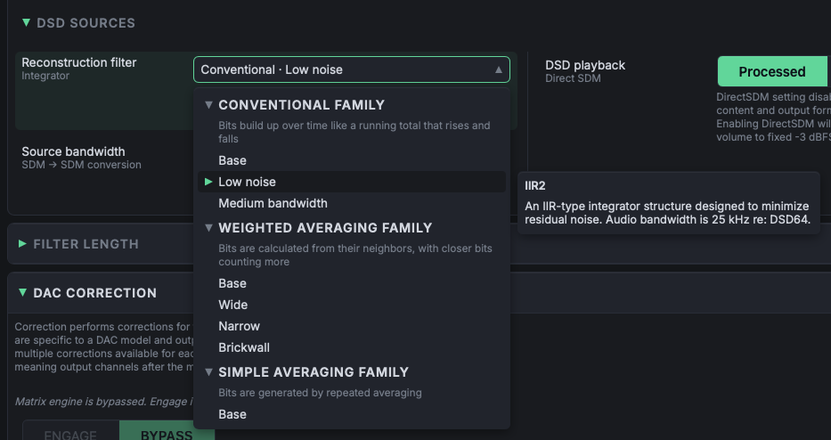

I’m getting very close to being able to put v1.14.0 up on :beta, pending Jussi’s blessing of tweaks to Easy Mode.
A teaser:
Some significant changes from above, but the biggest are:
  • It no longer conflates length with phase. The old model gave [ Space | Transients ] toggles to both phase and length adjustments, but that was wrong and confusing. I eliminated length as an axis of control entirely, actually.
  • I managed to work in three sinc filters under The Crucible (-MG, -MGa, and -M), as well as IIR2 and (minphase)FIR.
  • Lifelike went from ext2-long to plain ol’ poly-sinc-ext2, a better all-arounder imho (and currently my favorite filter).
Note that the tile rows also work as tiers: the first three are all-purpose; the second are situationally excellent; the bottom are curiosities for the sake of comparison.
