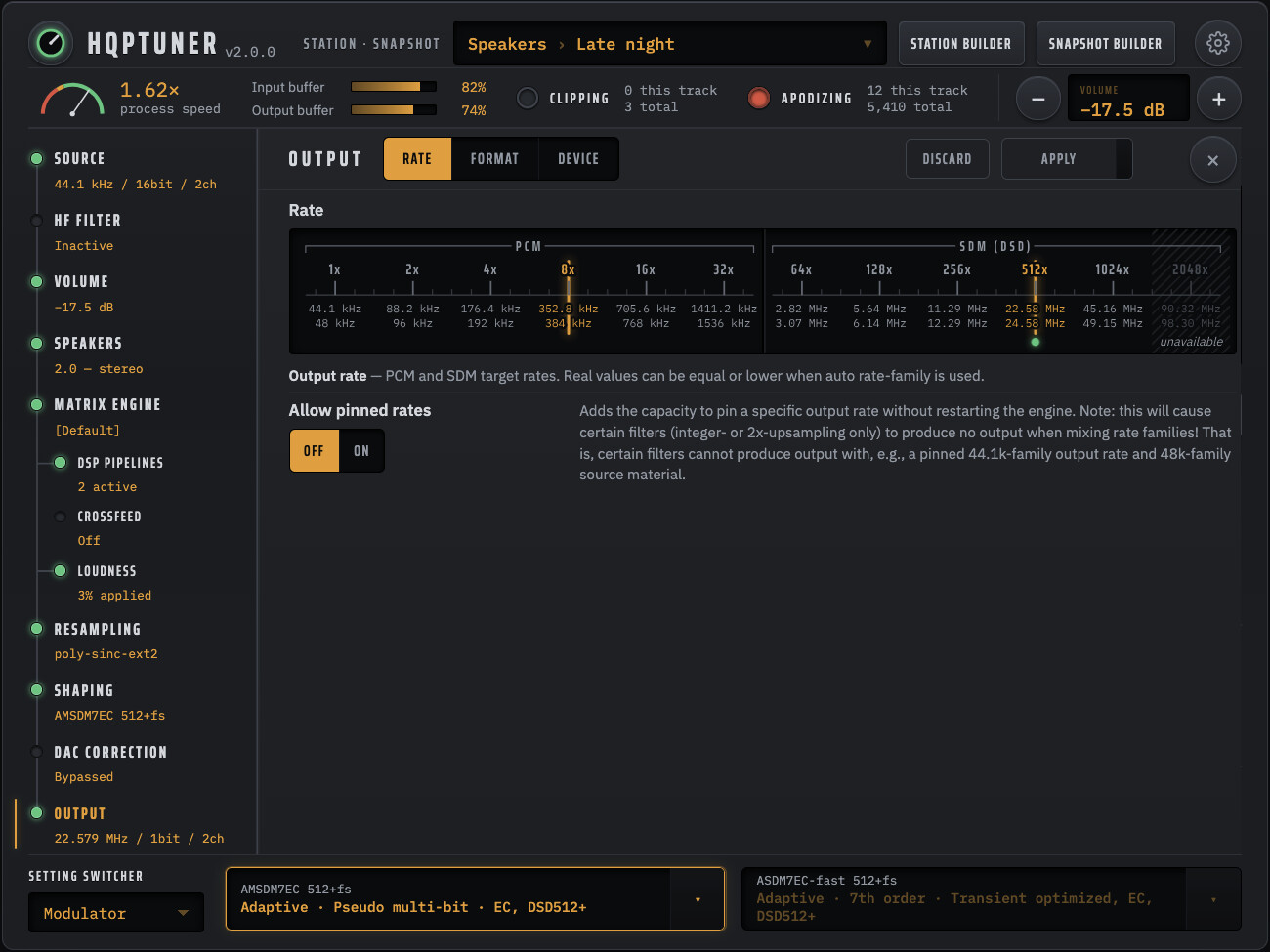

I’m excited to announce that I’m moving forward with one of the prototype mockups for version 2. I think this is a major step towards cohesion and coherence… properties lacking from v1. I also think that, with the help of a ~2 page guide, any newbie should be able to pick up enough speed to comfortably merge.
I’ll post a link to the mockup once it’s finished so that people can play with and poke at it for themselves. In the meantime, this is another teaser… and also another feedback checkpoint. If any of the below doesn’t sit right with you, let me know and I’ll see what I can do.
First and foremost, it’s highly compact: the whole thing fits on a 10.2" tablet screen with no scrollbars anywhere! I never actually intended to make v2 small, it just kind of happened.
No cards, no tabs, no special modes that duplicate settings: just one coherent interface. The default view always shows the core live settings: matrix profile, filters, shapers, and output format, while non-live settings are found in “drawers” that open by clicking on the relevant portion of the signal path. Some drawers are further organized into tabs.
Please don’t be shy with feedback :slight_smile: and once again, I’ll be posting a link to the mockup for people to play with once it’s ready.

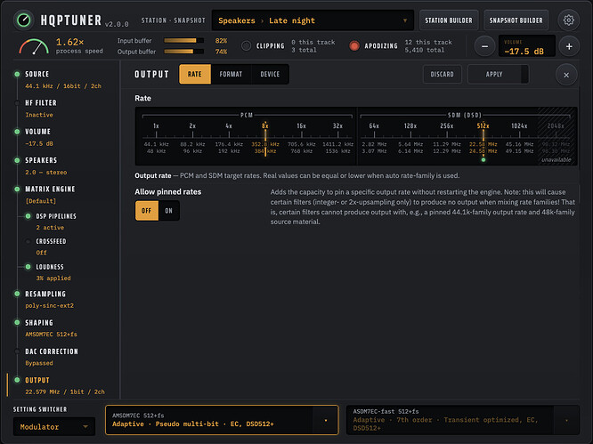

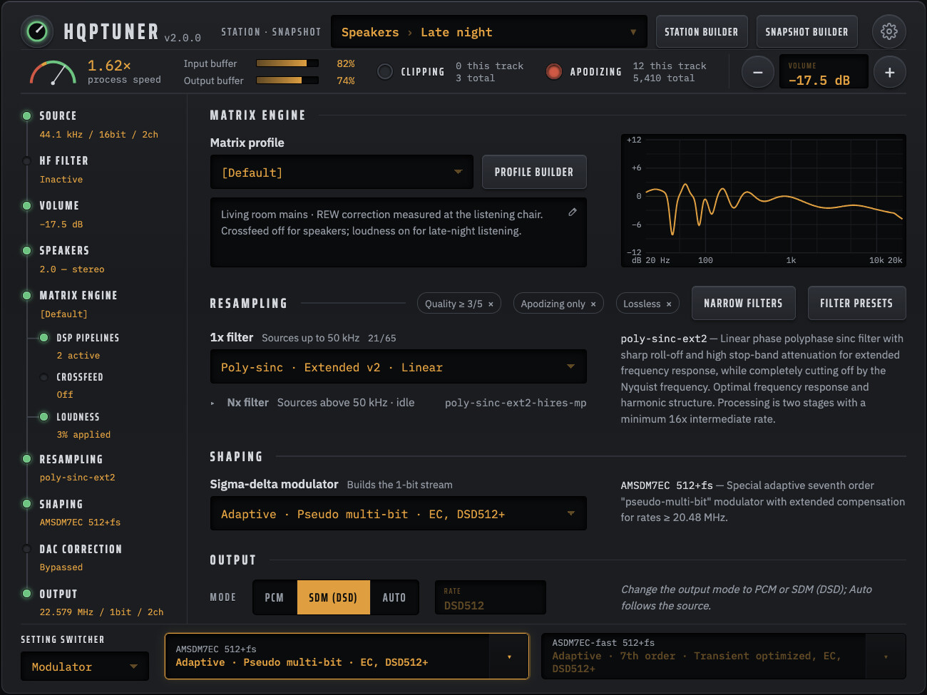

As promised, please find a link to the v2 mockup below. There’s a control strip at the top of the page that you can use to imitate various playback scenarios and screen sizes.
https://claude.ai/artifact/TDCf3zE1nWfFgKFvui58G7
What this is (and isn’t)
This is a mockup: a dummy program that I’ve been using to nail down the visual language before I translate it into the real app.
While this is far, far more polished than the screenshots I sent before, it’s still a work in progress, so whenever I update anything, the mockup may freeze and reset on you. That said, most of the visual language is locked in, I’m mostly just tweaking the finer details at this point. The Builders are the areas that still need the most work, but you can get the gist regardless.
Certain things, like the Setting Switcher, aren’t wired up at all on purpose: the intended behavior is obvious, so use your imagination. Other things like the DSP pipelines had to be wired up to the extent that you can get a feel for how the interface manages them.
How version 2 works
It is highly compact and fits on a 10.2" tablet screen with no scroll bars. As I said before, this was never an explicit goal of mine, it just happened, and I didn’t fight it.
The main settings are always on the front page. Everything else is either in “drawers”, or in Settings (top right). Click on a portion of the signal path to open its drawer and see the related settings.
The bottom bar can be switched between the Setting Switcher, volume control, or being hidden.
Easy Mode filters are now found in the “Filter Presets” popover.

This looks amazing, Adam! Can’t wait to actually use this!
​Pretty sure everything we need is right here. If I had to be super picky though, having the HF filter settings and the spectrogram on the same screen would be awesome.
​Oh, and one more thing: I’m a total sucker for bouncy VU needle meters. Feel free to shove “level meter visual overhaul” all the way to the very bottom of the roadmap :joy:

Hm, I think my old poll above for v2 missed the point and didn’t give the right options. I mean, of course there’s still work to do, it’s a mockup.
Let’s try this:
  • It’s great, keep working on the finer details
  • It’s good, but needs some work beyond the finer details
  • It’s fine, but I don’t agree with some big choices
  • It’s bad, I don’t like the new direction at all
0 voters
If you choose the last two options, please explain!

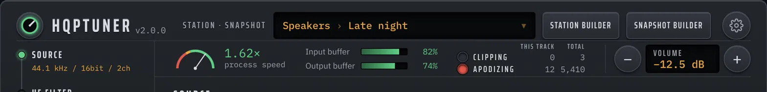

I made version 2 fit on an iPad Mini by stacking the clipping and apod lamps and expanding the signal chain up into the engine row :joy:
The Mini is a little wider but ~66 px shorter than the 10.2" format, and the signal chain’s height/density is the main thing stopping me from going smaller than this. Going smaller than this would eat into either/both the top bar and/or the Setting Switcher bar at the bottom; the only alternative would be forcing people to give up portions of the signal chain… like two minimum. A UI that says “sorry, you can’t go that small until you cut at least two signal chain options” is bad by any metric in my book.
I’ve also finally moved the mockup code into the repo and have begun the refactor that will prepare it for integration. I am so excited to use this myself! Version 2 looks so much better that I can barely stand to look at v1 anymore :rofl:
