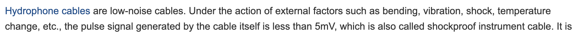

I’ve personally had some fun with hydrophone cables and preamps. There typical preamp gain can be 120 dB with about 100 Mohm impedance. Just bending a cable can create enough internal friction that the electric field changes enough to make sound of it’s own. Good thing there is that EMI/RFI and cooling are usually not a problem…

Well, you are free to read on the topic in internet… Just search for something like “microphone cable microphonics”.
You can find low microphonics mic cables:
https://www.performanceaudio.com/products/mogami-w2792-superflexible-low-microphonic-mic-cable-black-by-the-foot
Or you can just read here:
Bending causes internal physical movement in the cable, in this case hydrophone is purely capacitive piezoelectric sensor and is driving 100 Mohm input impedance on preamplifier. This preamplifier can have gain of 120 dB. Cable itself has capacitance too and can be tricky to deal with since it can become sensor of it’s own, especially because the preamplifier input is so high impedance.
The key in both cases is high impedance input and high gain. Static discharge properties and “condenser microphone” properties. Where latter is emphasized by the DC on the cable, such as 48V microphone phantom power.
Quoting from there:
Triboelectric noise within medical cable assemblies and lead wires is generated when the conductors, insulation, and fillers rub against each other as the cables are flexed during movement. Keeping triboelectric noise at acceptable levels requires careful material selection, design, and processing. It is also an issue with underwater electroacoustic transducers if there are flexing motions of the cables; the mechanism is believed to involve relative motion between a dielectric and a conductor in the cable.
One hydrophone manufacturer for example specifies about their cable:
No, for example capacitance of the interconnect used to connect LP player to the RIAA stage can have notable impact depending on the cartridge-cable-RIAA stage combination.
