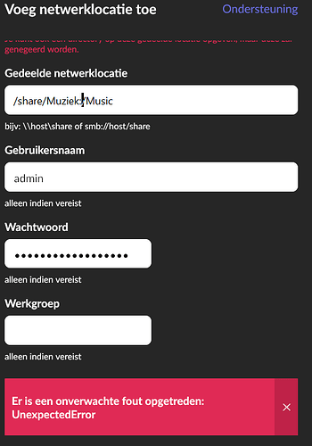

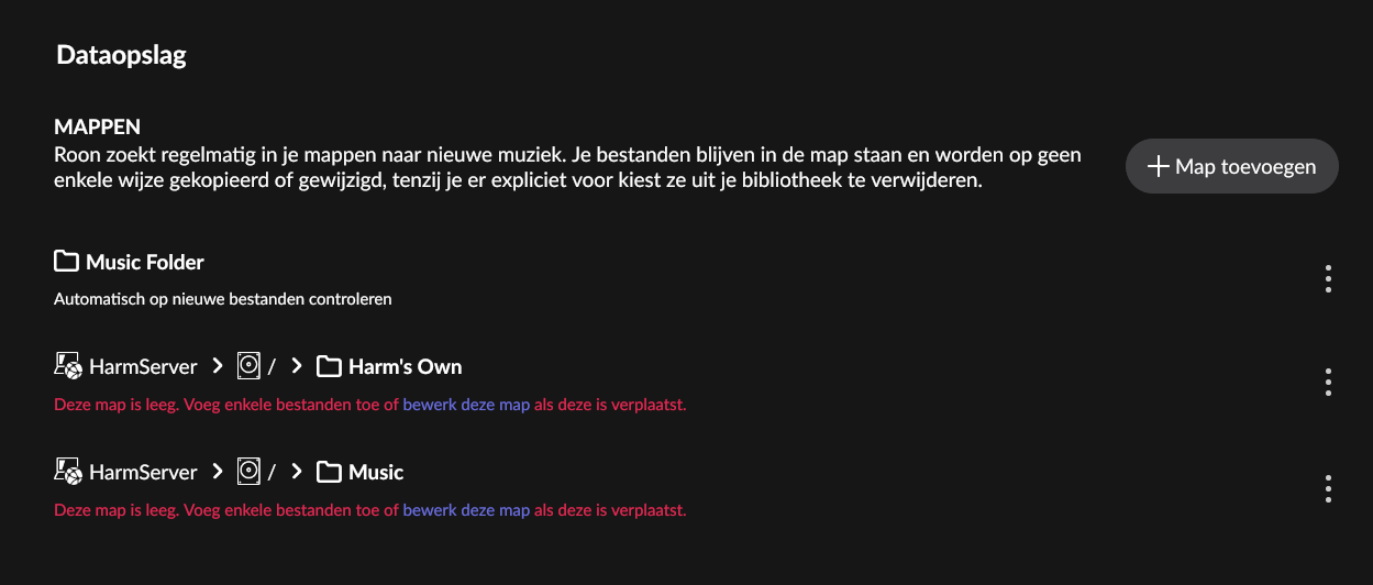

Although I was able to get Roon running again, I haved not been able to connect Roon with my private music library. I think that by now I have read most of the topics on establishing this, but I just can not succeed! Despite all the kind,patient and elaborate replies on similar questions on this subject I remain at a loss. I just don’t seem to get it.
Can anybody help me out? Harm’s Own is my music folder. What would the exact ‘grammar” of the line connecting Roon to my music library be in my case? And how do I insert this line in the Roon UI to actually make it work. All Ihave been able to attain this far is this:
What happens when you click on bewerk deze map and select your music folder?

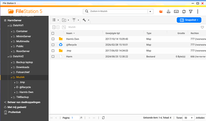

QNAP is a bit tricky when it comes to compiling the correct share path, for example my experience is that logical volume names like ´DataVol1´ do not work, and top-level folders must be mounted correctly, without duplicate names, then they work without volume names in the path.
From you File Station screenshot, I would try as the second of the three lines, if your second one deviates, this might be the root cause of the problem:
/share/Container/roon:/roon
/share/Muziek:/Music
/share/Container/roon-backups:/RoonBackups
Feel free to share your path in docker generator. If the “´” in the folder name is not part of the script, it should not be a problem, that is why I suggest to share the parent folder /Muziek instead.

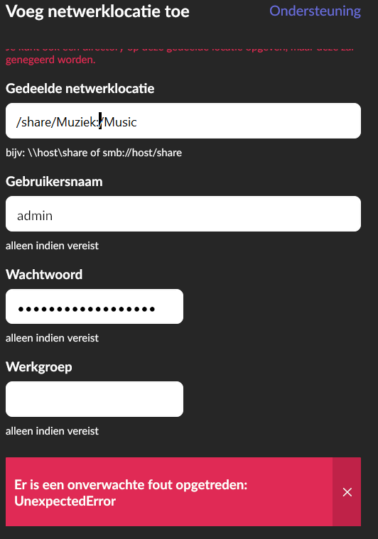

You are trying to activate the folders using a wrong method. Sharing a folder path with a container, is not an SMB share over network, but like sharing a local folder. Try instead enabling the “Music Folder” under Settings > Storages, or “add Folder”, NOT “add network share”. If you have previously not altered the docker script, though, this would not work.

/share/Muziek

Once this is running, you can open roon remote, go to Settings > Storages, and disable the first folder named Music Folder, and click for the folder formerly known as ´Harm´s own´ on
Bewerk deze map
and find the subfolder of the name ´Music´ in the structure under ´Music´. This means you are pointing roon to the different path how to access your music, after moving to the container. Do not open a new folder, and do not try to establish a network location folder, like you have done.

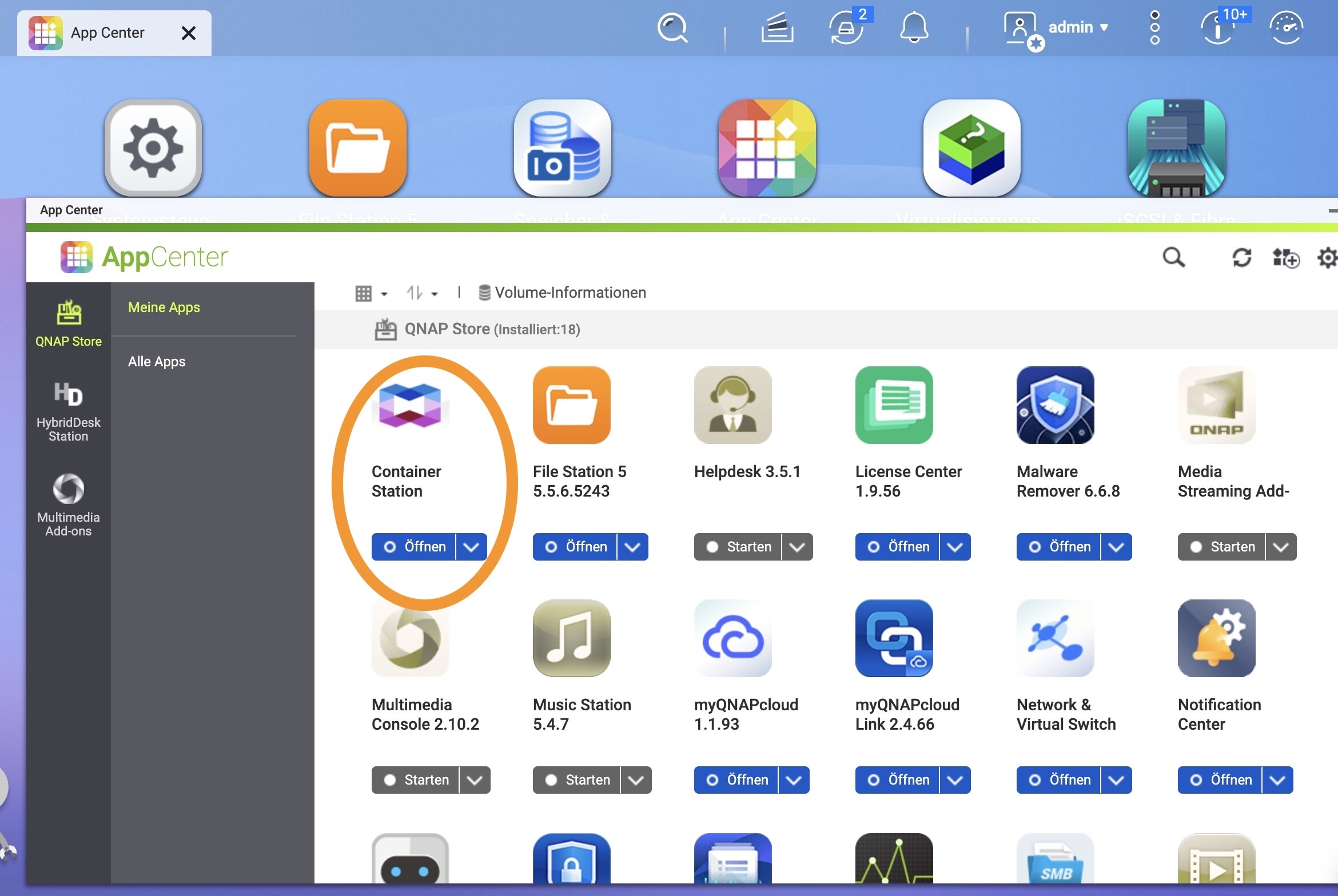

Then go to the QNAP desktop and open `Container Station´ in ´App Center´:
and replace the container which is running roon with the new script, or upload the new YML file and update the container. I fully understand you are hesitating, but I can assure you, you have to do the very same thing you had done successfully already, otherwise roon would not be running in the container.

It is indeed not so extremely difficult, BUT, it never occurred to me that I had to hit “+ Recreate” in Container Station. That is why I never got to the point where I would be able to alter the line! And I don’t remember having ever seen the Windows equvalent of that MAC OS page where I would have been able to specify my Music folder. Maybe I just missed that bit and the container took a default setting?
