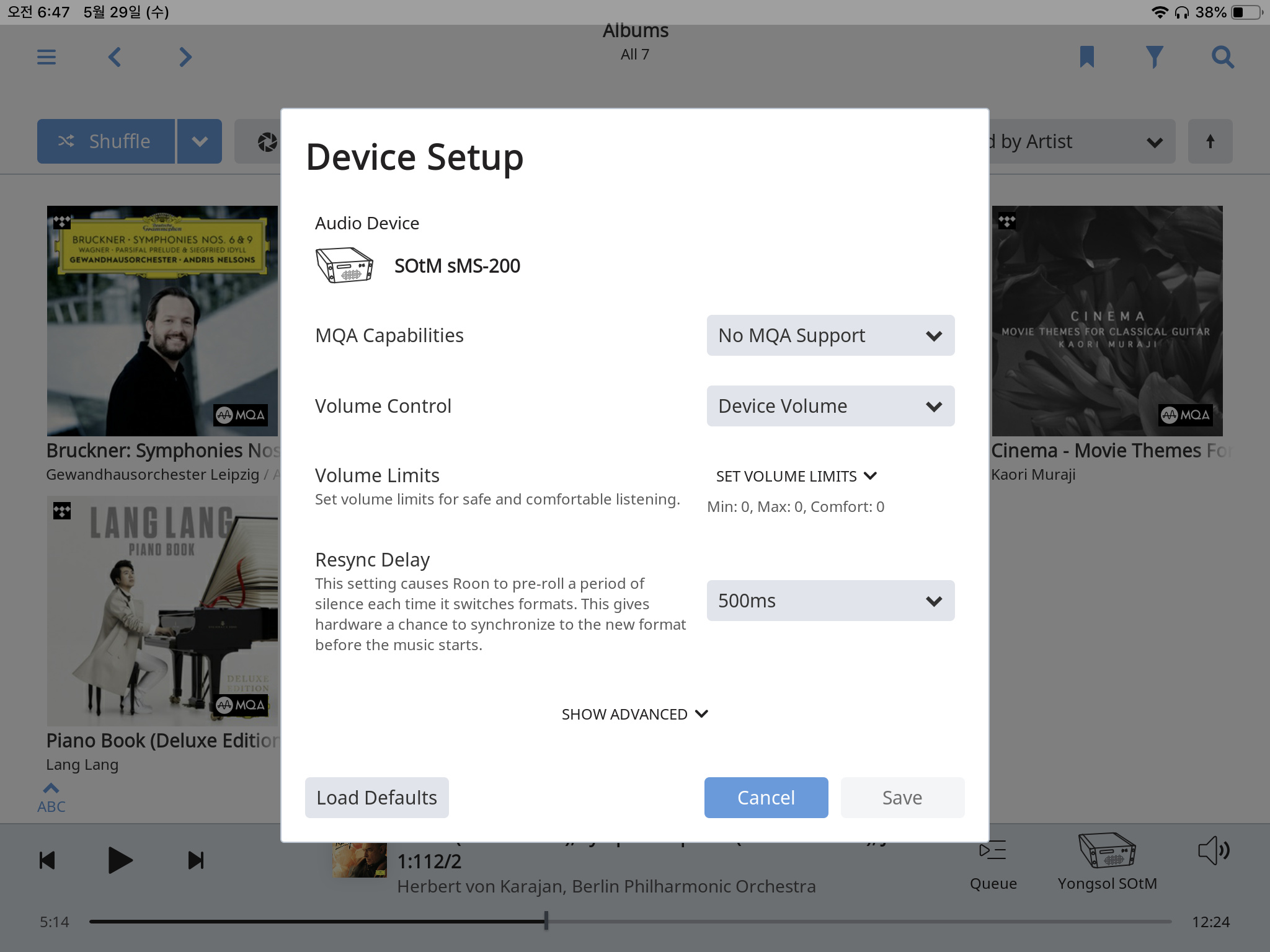

Thank you for your quick reply.
I will answer your question.
  • My network system has no problems. It works properly with Shareport function in sms-200.
    (As I wrote in my last post, I played Roon well for a year without any problems)
    -sms-200 The firmware of the device is up-to-date
  • Pictures of the device setup and Signal Path are as follows.
  • On a System Device, and through a DDP device not Roon ready,
    sounds normal. No problem.
  • The same symptoms occur in the playback of ALAC files too.
    (After playing the MQA file, there will be no sound when playing the ALAC file.The 44.1kHz file has the same symptoms.)
Pictures of the device setup and Signal Paths
