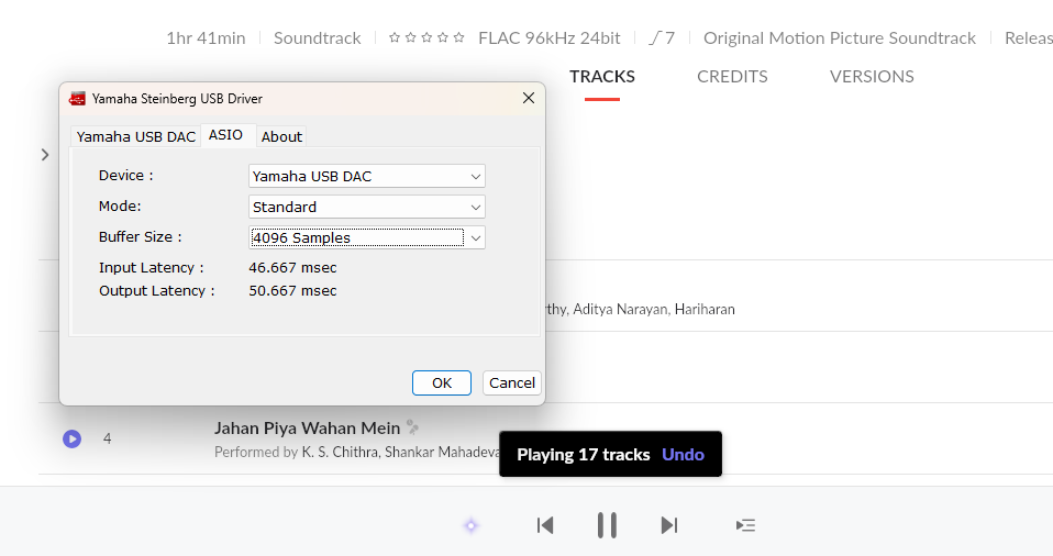

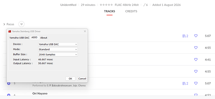

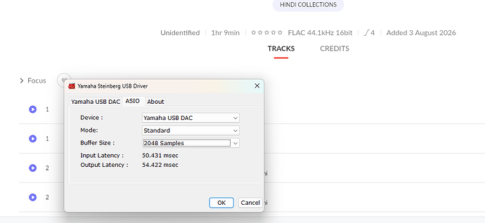

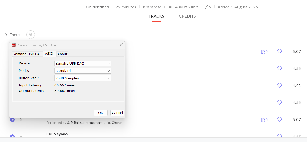

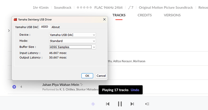

Thanks for the suggestion. I did some more testing while monitoring the Yamaha Steinberg USB Driver. I noticed that the driver automatically adjusts its buffer size depending on the playback sample rate. For example, both 44.1 kHz and 48 kHz use a 2048-sample buffer, while 96 kHz uses a 4096-sample buffer. However, I still see the “Lost Control of Audio Device” message when switching from 44.1 kHz to 48 kHz, even though the buffer size remains the same. This makes me wonder if the issue is related to how the driver reinitializes when the sample rate changes, rather than the buffer size itself. Happy to hear your thoughts if I’m overlooking something. Attached the pictures for your reference.
Reports elsewhere suggest that a larger buffer size eliminates the issue. Therefore, experiment with a larger buffer size.
