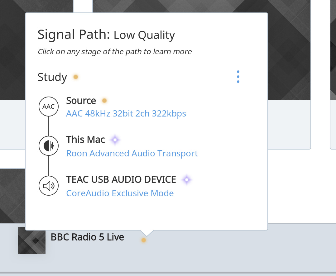

But internet radio works with relatively low resolution

The work-around but a cumbersome solution.
  1. Roon is playing high res files but will not play 44.1/16 bit files.
  2. Quit Roon and close down the application.
  3. Open Audirvana and play open a 44.1/16 bit file.
  4. Close Audirvana and open Roon and 44.1/16 bit files will play.
  5. Roon will not allow 96/24 bit files or higher to play.
  6. Close Roon and open Audirvana to play a 96/24 bit file and back to Roon.
  7. Roon will open internet radio after playing 96/24 files but after listening to internet radio the highest files playable are 44.1/16 files.
  8. There must be an easier way to manage this issue. I do not have Roon and Audirvana open at the same time.
