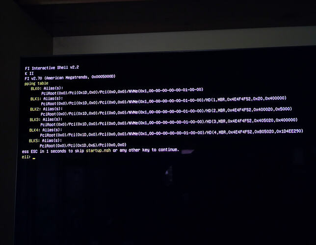

This is the screen, sadly none of the keys work and I can’t escape this screen without powering down.
Good screenshot. Tells me a lot.
I’m assuming you’re not able to access the bios now.
That’s the NUC’s built-in UEFI shell, and two things stand out in the mapping table.
Every partition on your NVMe shows as MBR, with disk signature 0x4E4F4F52, which is ASCII for ROON. That’s your old legacy ROCK install. There’s no FS0: entry at all, so there’s no EFI partition for UEFI mode to boot. Hence the shell. Normal, not damage.
More telling is there’s no USB device in the list either, although your USB rock installer might not be plugged in. That plus a dead keyboard says the USB setting you changed turned the ports off l, which is also why F2 won’t get you back into BIOS.
Fix is a CMOS clear: unplug the power, undo the four screws under the feet, disconnect the small two-wire CMOS battery lead for a few minutes, reconnect. That restores factory defaults and brings USB back. Then change only Secure Boot off, UEFI on, legacy off, and boot the fresh ROCK stick from the F10 menu.
Before you reinstall though — a clean install wipes the drive, and your Roon database is on that fourth partition. Get a backup off it first if you possibly can.
