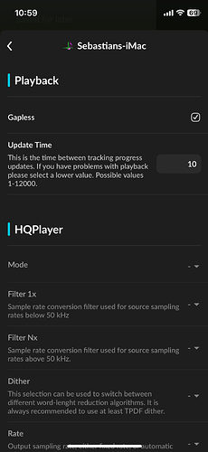

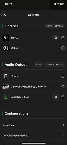

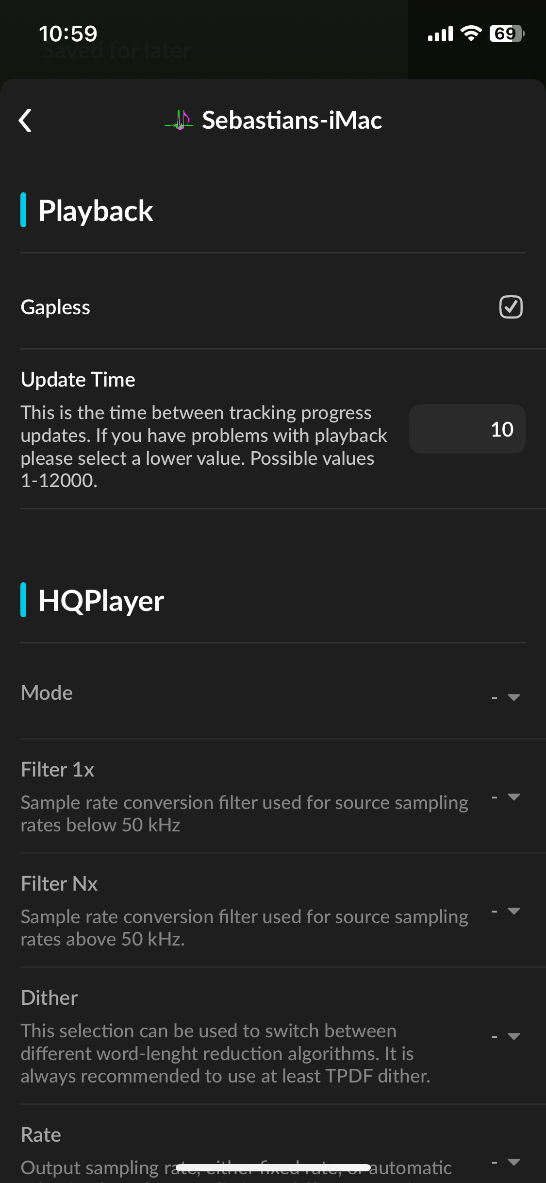

Can you post a screenshot of your audio output settings?
And … are you trying to play local music (which upnp mediaserver are you using) or from Tidal/Qobuz?
Just Tidal. Here are the relevant screenshots.
It seems all correct … do receive some kind of error when you try to play something?

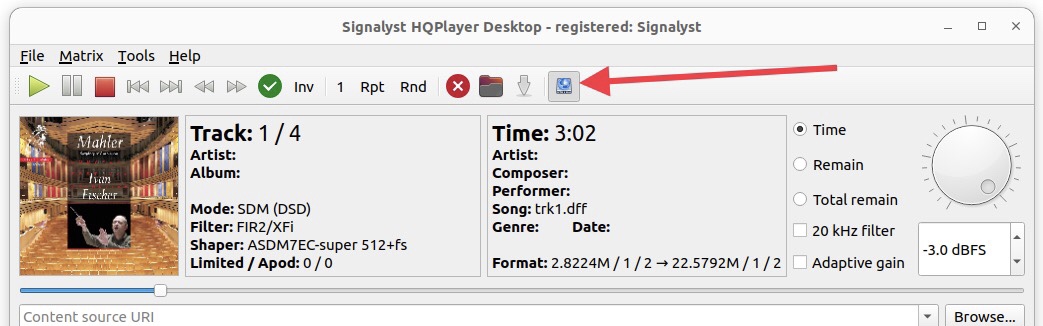

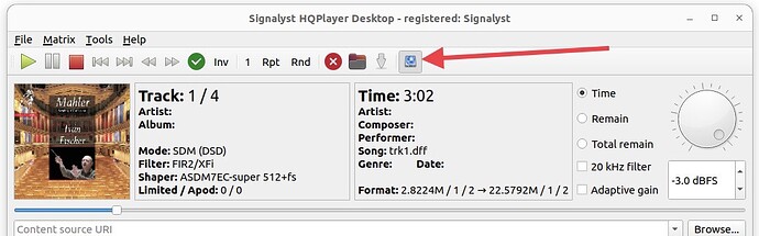

Have you allowed remote control on your HQP Desktop?

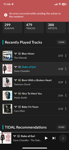

That is checked. Here’s the error:
Do you perhaps have Private address checked in your iPhone Wi-Fi settings?
