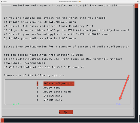

Point-of-confusion (for me & perhaps others with similar experience):
When instructed in step 4.4 to “…run menu in the terminal…select install/update"…” I was confused because all I could see was below:

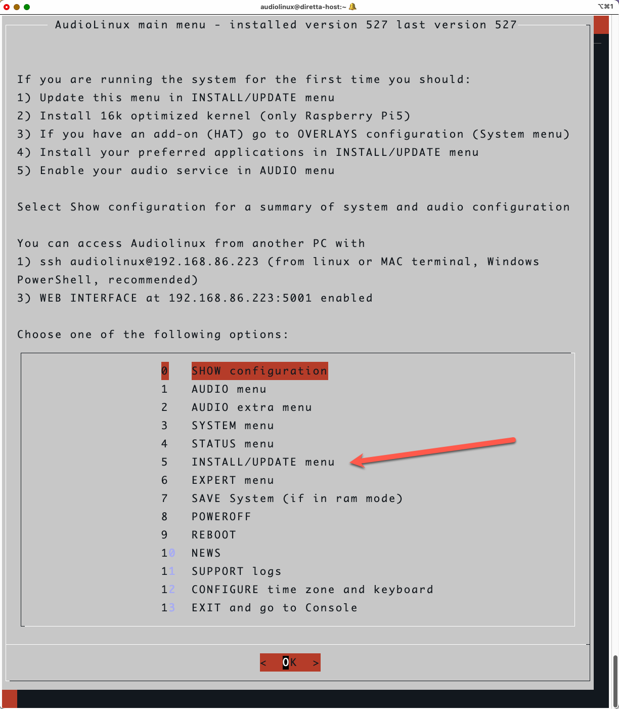

Being a newbie to this specific experience, I did not notice, nor understand the significance of, the faint “35%” in the lower-right corner. In hindsight, I now understand it was telling me that my menu choices were NOT all visible. (Yeah, large fonts necessary for my septuagenarian eyesight.) Once I mucked around a bit, I accidentally ran across the full menu:
…and there it was!

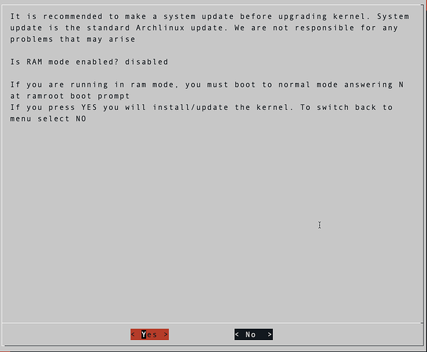

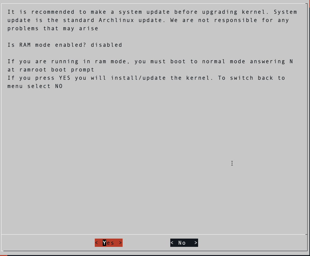

One more point of disorientation was after choosing “5 INSTALL/UPDATE menu” there was another screen that required clicking [Yes] to get to initiate step 3 - updating the kernel:
I muddled through and got it done (I think) correctly.
