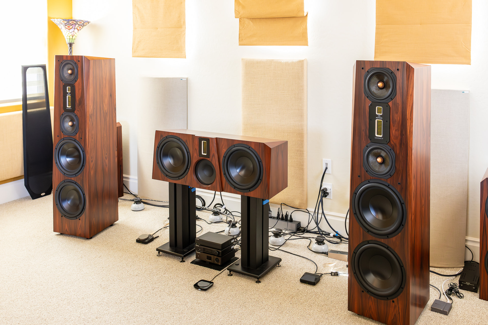

Honestly, I don’t think I hear any significant differences between the $16.95 Raspberry Pi official 5v/5A 45W power supplies and the $299 iFi Elite 5V/5A. But, I had the iFi SilentPower adapters leftover from another project, and the look nicer in my main system. :smiley:
Hi David,
Thank you for your point of view. Nice picture by the way.
So I will not spend €300 to change the powersupply of the host.
Implementing Diretta in my system made a big difference, so thank you for your thread. It pulled me over to start with Diretta and I am still a big fan.
Kind regards, Frank.
Sure thing, and thanks for your kind words.
A careful study of my photograph will reveal that I’ve adorned my beloved system with other trinkets (I call them “audiophile jewelry”). Not every decision I make is in service of sound quality alone as there are other aspects to enjoyment in this hobby that reward attention. :wink:
Put that €300 towards more music or a nice meal with someone you love and you’ll be happier.
