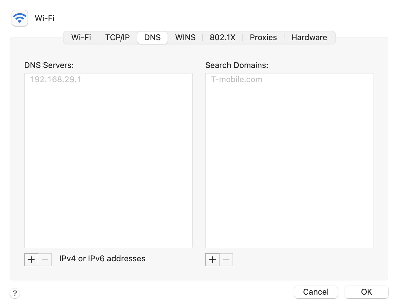

If Roon is not running in a VM ignore the above. How did you install your core on the mac? What steps did you take? Is your Mac mini wired to router? Or is it wifi? What is the IP address of your remote, core, and endpoints? If possible please verify subnet mask as well.
Please post some screen shots of the network and advanced network settings on you M1 Mini.
perhaps there are some issues with subnet mask or other entries like DNS / gateway etc that we might spot.

My Network setting Screenshots:
