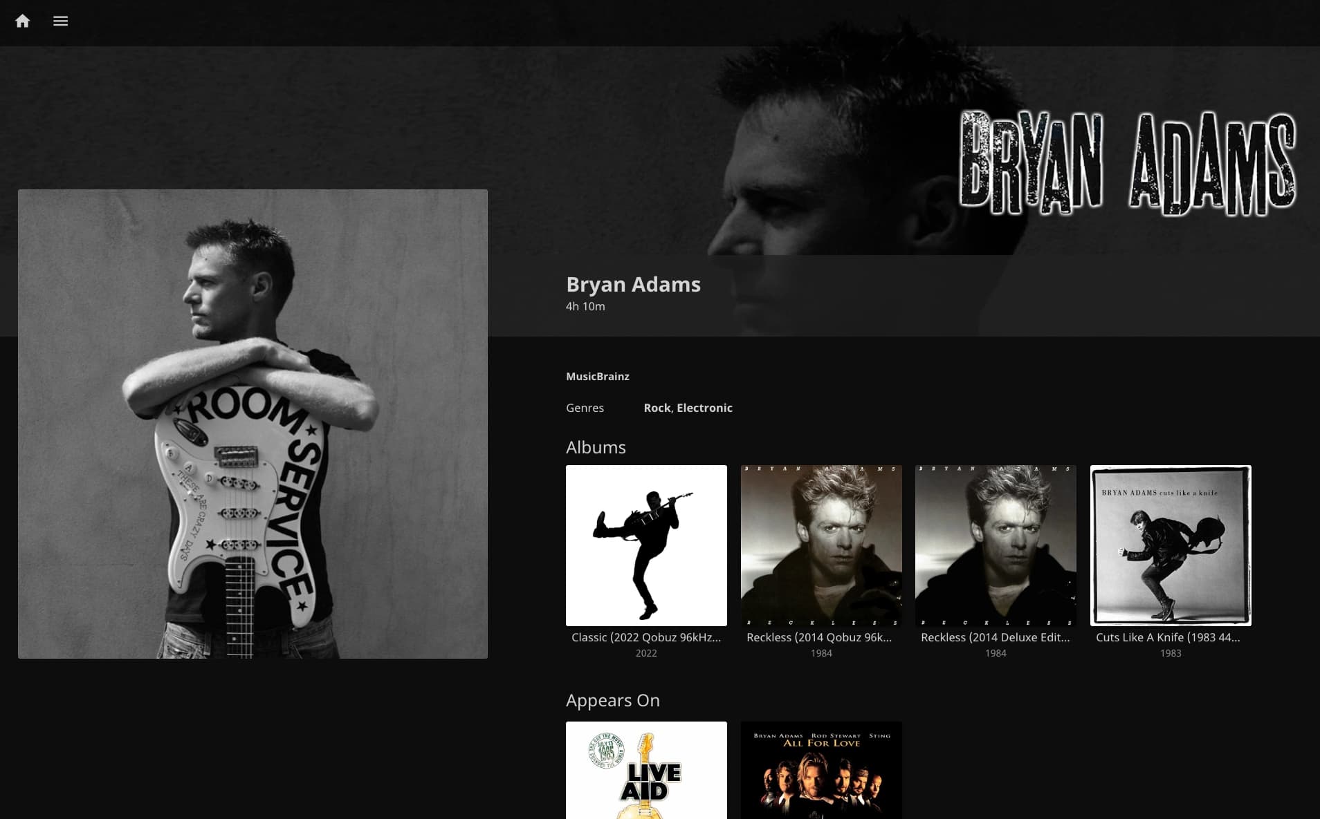

I think this is now the 4th time I’m trying roon. My library is meticulously well tagged (all files have Discogs tags + proper covers), I’m accessing my library from Swinsian (MacOS), Navidrom and Jellyfin with no issue whatsoever.
I’m running the core on Synology, I tried both the SPK and Docker with the same result:

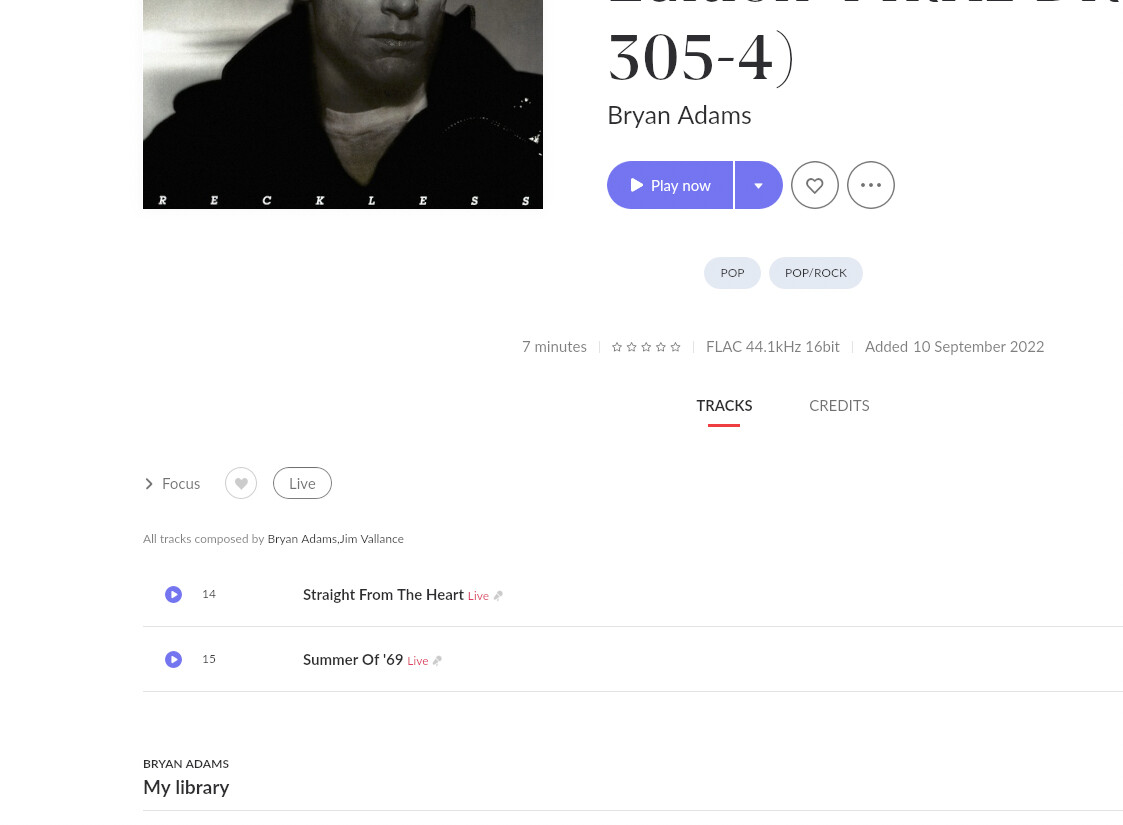

Only 395 of my 612 albums get imported, see images for the weirdness happening.

Roon works very differently from other players. It is not uncommon for those migrating from other players where they have heavily tagged their library to find that the conventions they were using do not work as they expect with roon. There are probably multiple problems with your library but a couple of things jump out with the Bryan Adams “Reckless” album that will probably fix other problems as well.
(1) With a double album (or any other multi-disk box-set) you must label the subfolders simply:
Reckless
   CD1
   CD2
Do not label them similar to:
Reckless
   CD1 - Studio
   CD2 - Live
In addition I would generally tag the ID3 disk number as 1/2, 2/2 etc.
This will make sure that roon knows to keep the multiple disks of your album together as a single album instead of splitting them into multiple albums which seems to have happened in your case.
(2) It is difficult to see from your cut-off screen shot but in general you should not be “meticulously” packing all the additional identifiers such as “deluxe” and release date of “2014” (vs. original release of 1984), and catalogue number “378 305-4” into the album title. This just confuses the roon album auto-identification process. This information should be going separately into each relevant ID3 tags.

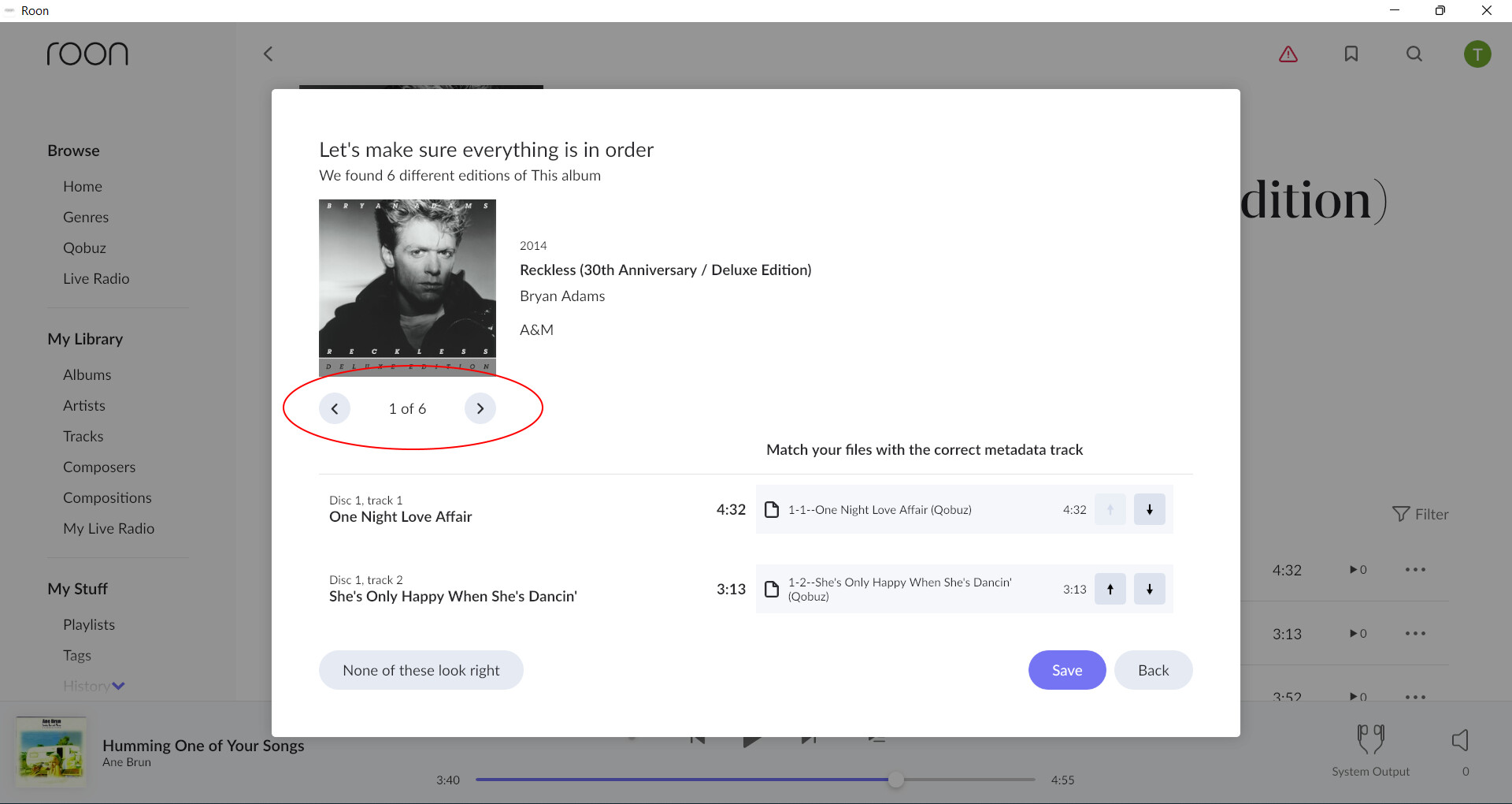

(4) Some roon collectors have thousands of albums. In those cases it is a major commitment to re-tag their albums so that roon’s auto-identification process is more accurate. In your case you have a few hundred problem albums so the decision may be easier. But before going down that path you can try roon “manual” album identification which may work with minimal re-tagging. For example, that album Reckless has had literally countless pressings and re-issues. Discogs has 247 versions. On the other hand, as far as I can see roon has only 6 but you may be able to “manually” identify your “30th Anniversary” version without extensive re-tagging (although following roon multi-disk conventions in point (1) above is usually a prerequisite). If you click:
album → three dots → edit → identify album
then you should come to a screen similar to this and then you can choose the match that is closest to your album.
It shouldn’t happen in this particular case with your version of Reckless (roon should make a 100% match) but it is not uncommon that track times may differ. That usually doesn’t matter as long as track titles match up. But with an album like Reckless where there have been so many re-issues it is also possible that track ordering or even bonus tracks do not match roon’s metadata so some further editing in roon may be required.

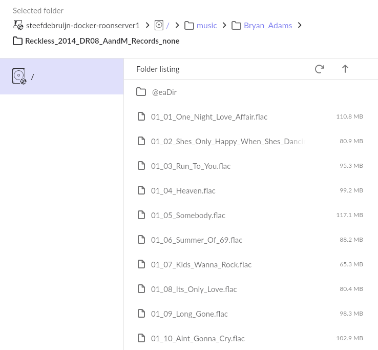

My file structure is flat, which works well because I prefix files with albumnumber_tracknumber.
Bildschirmfoto 2022-09-12 um 13.58.46
Yes, I do indeed pack release date, sample rate, catalog number and more into the album name, which allows me to identify the edition I’m looking for.

According to the FAQ having all files of an album in a single folder should work. It’s easy enough for me to stick to the standard tags, which should help roon identify albums.

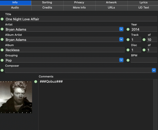

I have re-written the tags for all albums to only contain standard data.
All files have complete Discogs tags, i.e. IDs, label + catalog number.

Names are clean from special characters, files have proper album name, artist, album artist, year, label, catalog number tags. No skipped files. If the tags say “Track 1 of 10” and roon only shows two, there should at least be an indicator that something is wrong?
