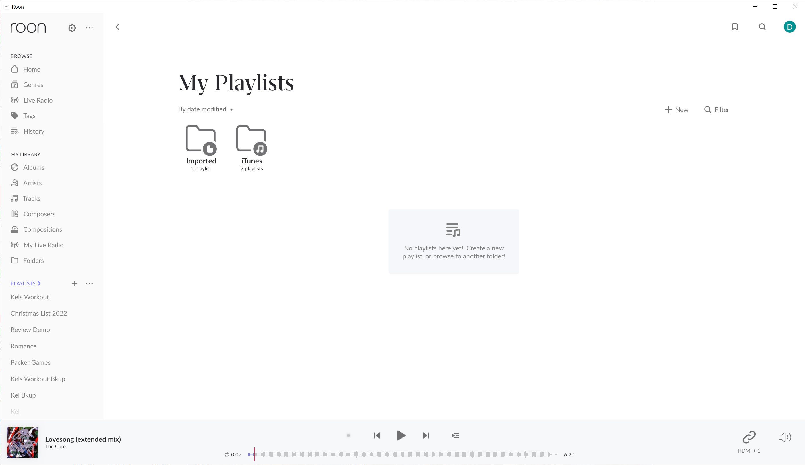

After my last update, 3 out of 4 of my “Imported” Playlists disappeared. It now looks like the Roon playlist now shows Imported and iTunes Playlists separately. OK, fine.

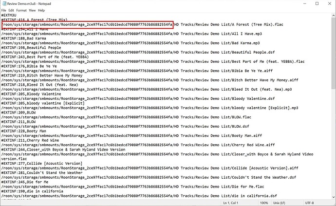

But now, it only shows one of my playlists (Review Demo). 48 songs. I have done all the usual and yes…the M3U file is in the directory of the music.

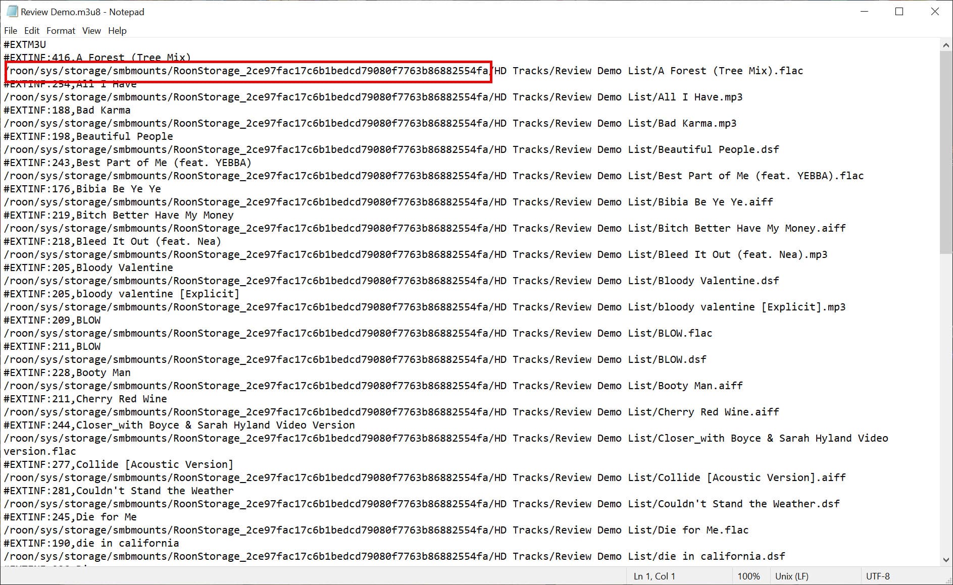

Here’s the playlist that works:
I am assuming the issue with the rest of the Playlists, has something to do with the line
"roon/sys/storage/smbmounts/RoonStorage_******** ?*
For my other 3 Playlist, i copied the line above and did a search and replace (this did not work), then I deleted all file location (since the M3U file is located in the same directory…and no…this did not work).
Can someone tell me where I can find the
I think this might be the key?

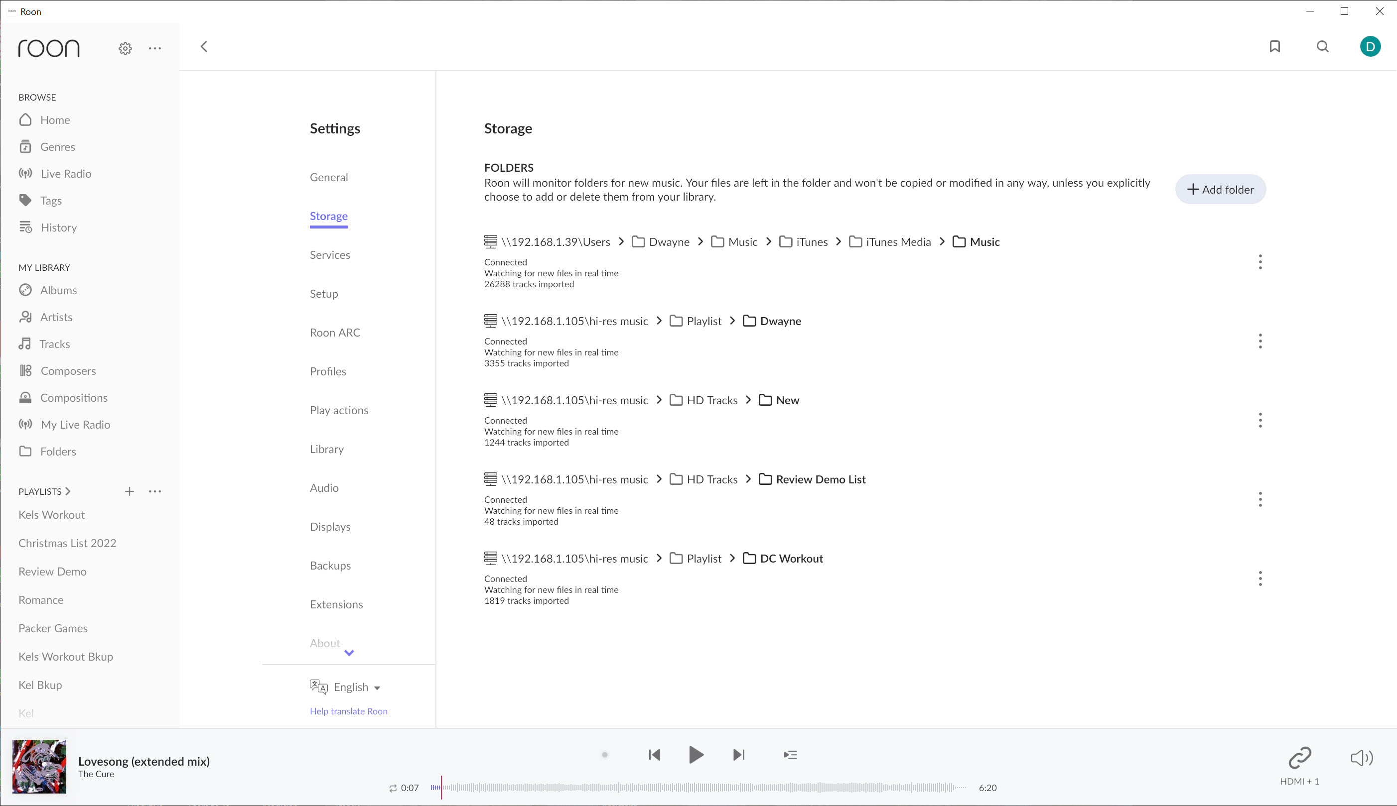

Can you tell us a little more about the boxes sitting at 192.168.1.105 and 192.168.1.39?
Sure. .39 is an iMac. My wifes iTunes are on that and Roon has found all of them. .105 is a Synology NAS. All of my music is on the NAS. Roon has only found one playlist on the NAS (after the update).

  • 192.168.1.105 is your Synology NAS
  • You have 3355 tracks in \hi-res-music\Playlist\Dwayne
  • You have 1244 tracks in \hi-res-music\HD Tracks\New
  • You have 48 tracks in \hi-res-music\HD Tracks\Review Demo List
  • You have 1819 tracks in \hi-res-music\Playlist\DC Workout
  • Of the 4 playlists above, only “Review Demo” is importing correctly.

(Aside: I notice from your screenshot of the Review Demo List that it is called “Review Demo.m3u8” - note that .m3u8 fules must be encoded with UTF-8 character encoding, so software doesn’t have to read those if there are non UTF-8 characters. I personally only use standard old .m3u files, which aren’t so fussy about character encoding. All that said, that could be a red herring, so I will move on…)

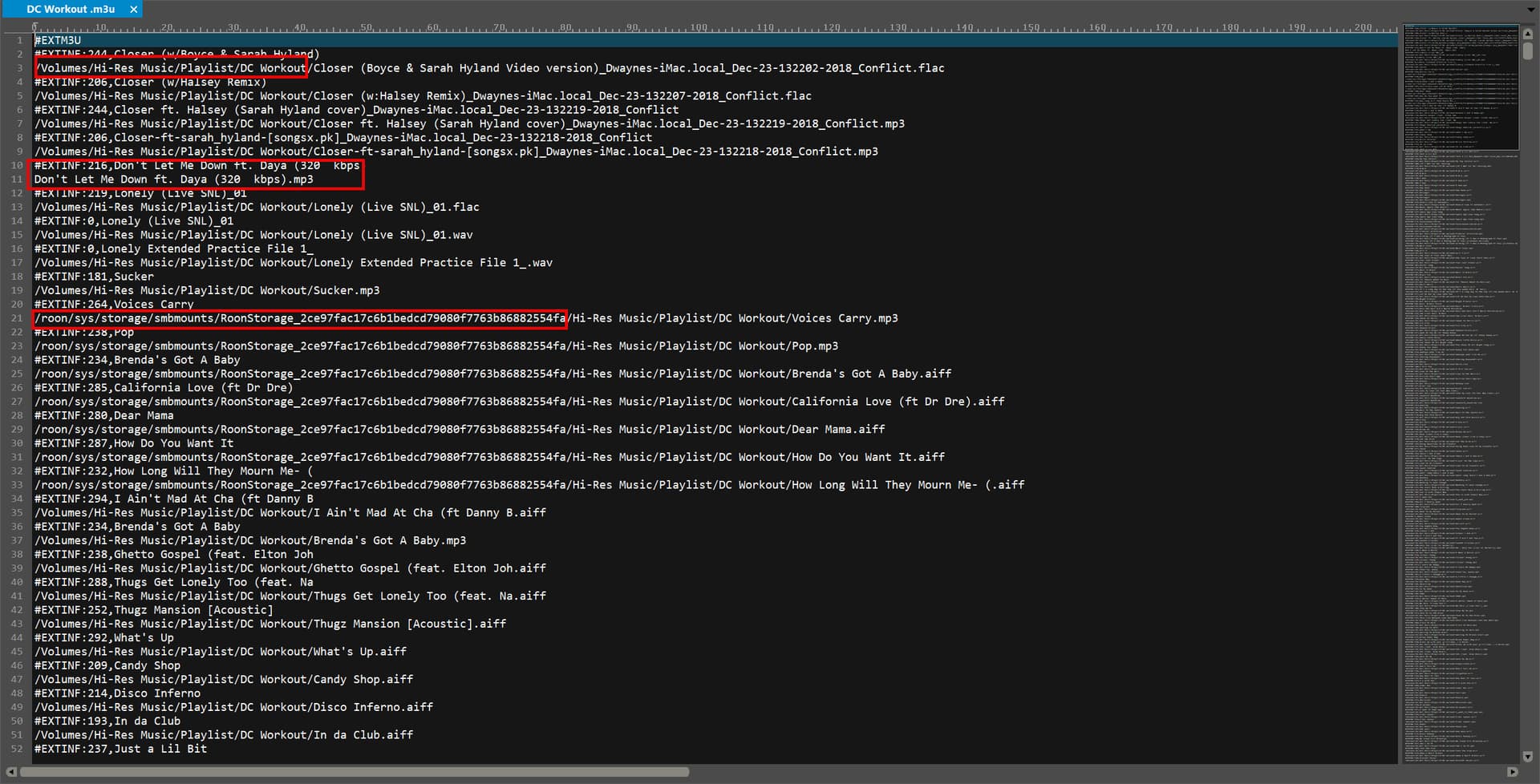

I can’t tell 100% from your posts so far where your all your playlist files are. BUT: One important thing to keep in mind is that Roon will deliberately ignore playlists that sit in a directory that simply reference every song in that directory. It appears from your “DC Workout” screenshot that this may be the case.
But the syntax "roon/sys/storage/smbmounts/RoonStorage_******** " - which is an “absolute path” - is not 100% sure to stay the same over time. Between that and the above fact, I think you are better off doing the following:
