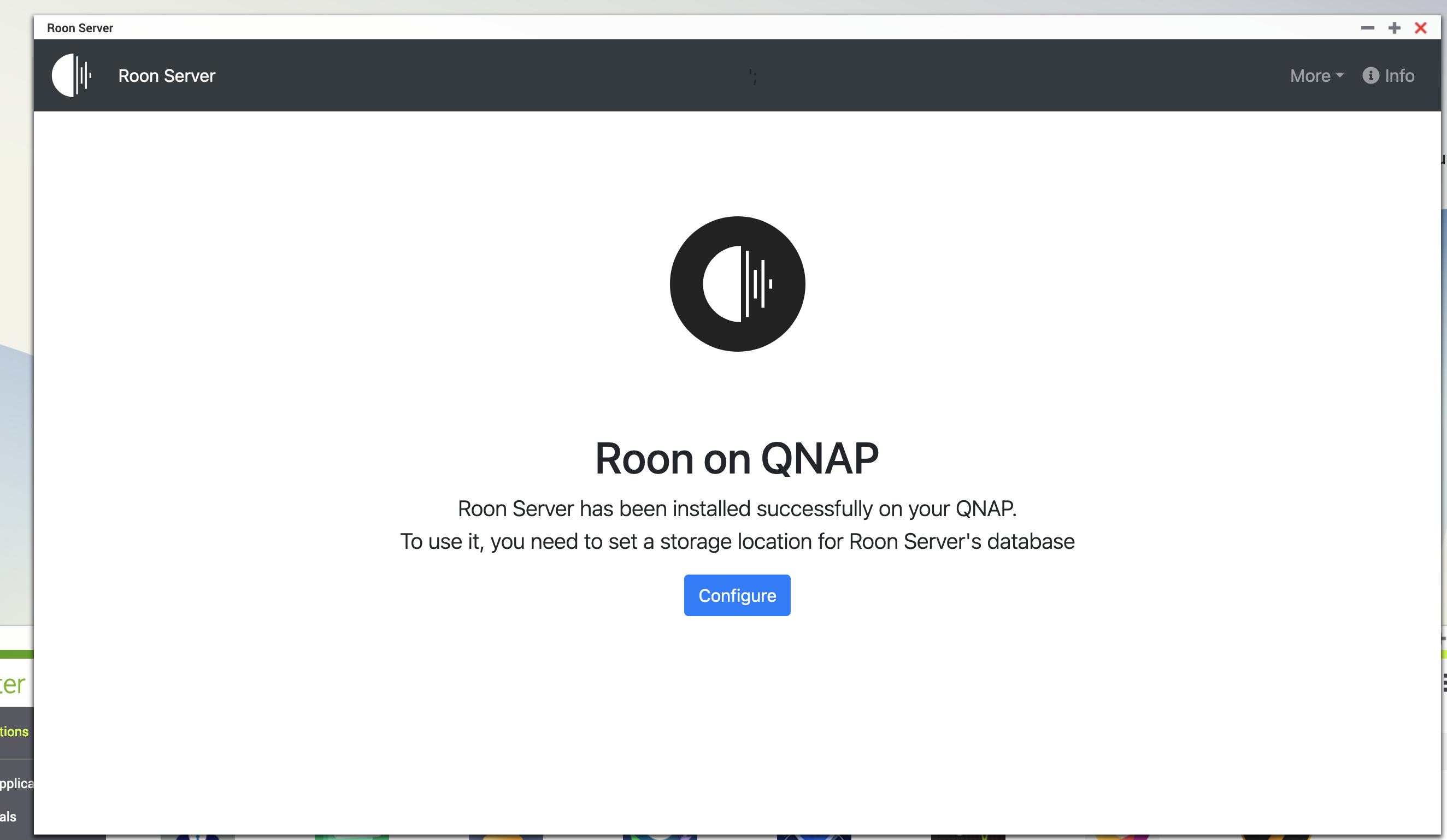

I’m in big trouble. I have to reinstall Roon server on my QNAP TS-251+ and it doesnt work. Downloading and install seems to be ok.
Then then I’m asked to indicate storage location, which I do and I have a msge all ok.

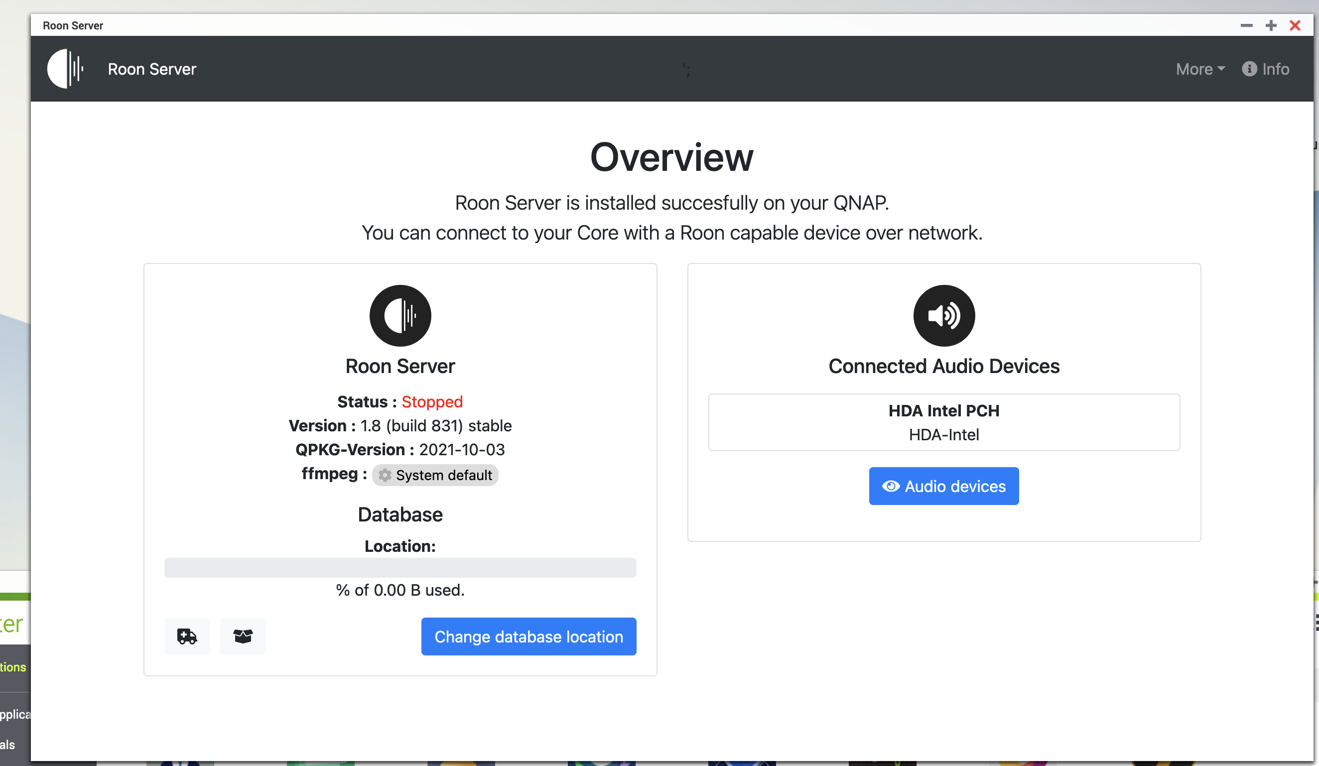

But it isnt, as Roon server has status: stopped and of course no device can find it over network.
I installed a few times Roon Server precedently and it always worked. What happens this time?
Would be great if anybody can help me.
Have you checked on your QNAP - My Apps to see that your “Roon Server” is running? It should have started during the install but may not be enabled.
Tks for quick answer. Well it’s all fixed now, I didnt choose the right folder, mixed up database and storage location. I’m restoring a backup right now and it seems to work perfectly.
I kind of wondered if that might have been the case. At least you found the issue.
