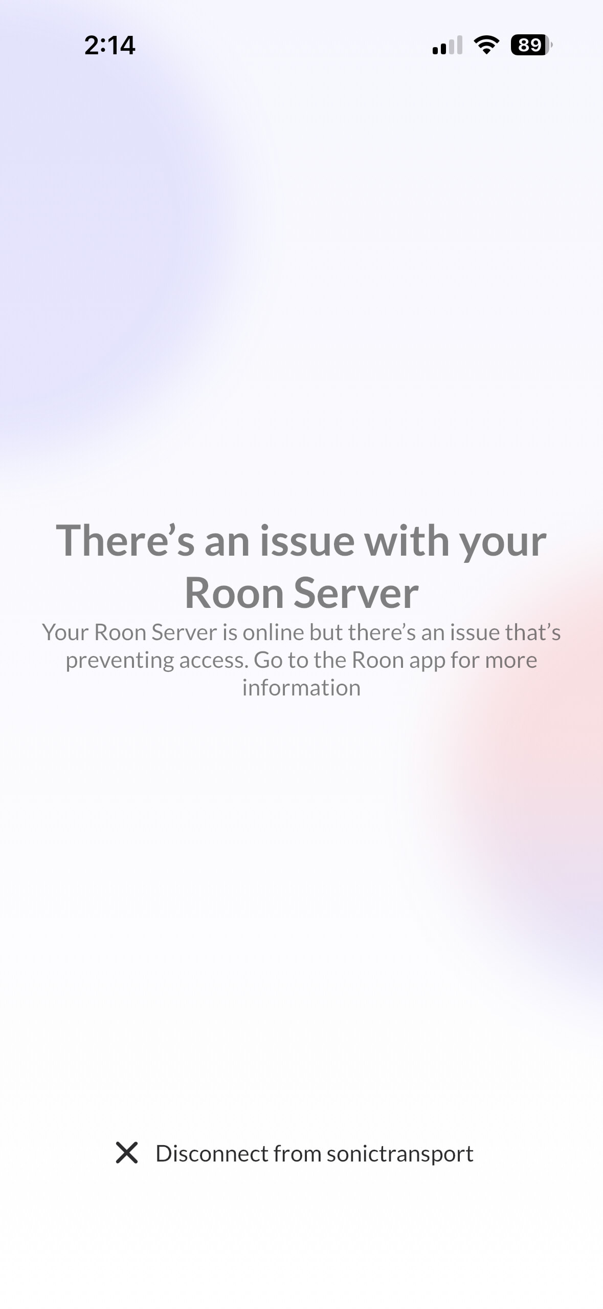

· I have never been able to use Roon ARC. I get "issue with Roon Server," I have enabled UPnP on my home router. One other detail: My Roon Server is hard wired into a TP-Link RE315 wifi extender. Could that be the problem? I'd really like to use ARC but have never been able to connect. Your help appreciated.

Thanks for reaching out. We’ve activated diagnostics for your account and what this does is upload a log set to our servers for review. Looking over the log file, I see an error with ARC connectivity, but nothing that would trigger an issue with Roon Server, that is typically due to corruption. Can you please share a screenshot of the exact error you are seeing? If you temporarily connect your Roon Server directly to the router, does the error persist?
I am attempting to use ARC with iPhone. My small green computer is my Roon Server; I use a TPLink network switch between the RE315 network extender and the small green computer running Roon. I have no problem with running Roon from my desktop or an iPad.

Can you temporarily simplify your network setup, and get a direct ethernet connection to your server via ethernet?
Then, reboot all your devices and see if you’re able to connect. Thank you! :raising_hands:

What do you see listed in Roon Settings → ARC? Is there a diagnostic message listed alongside a “Not Ready” status?
