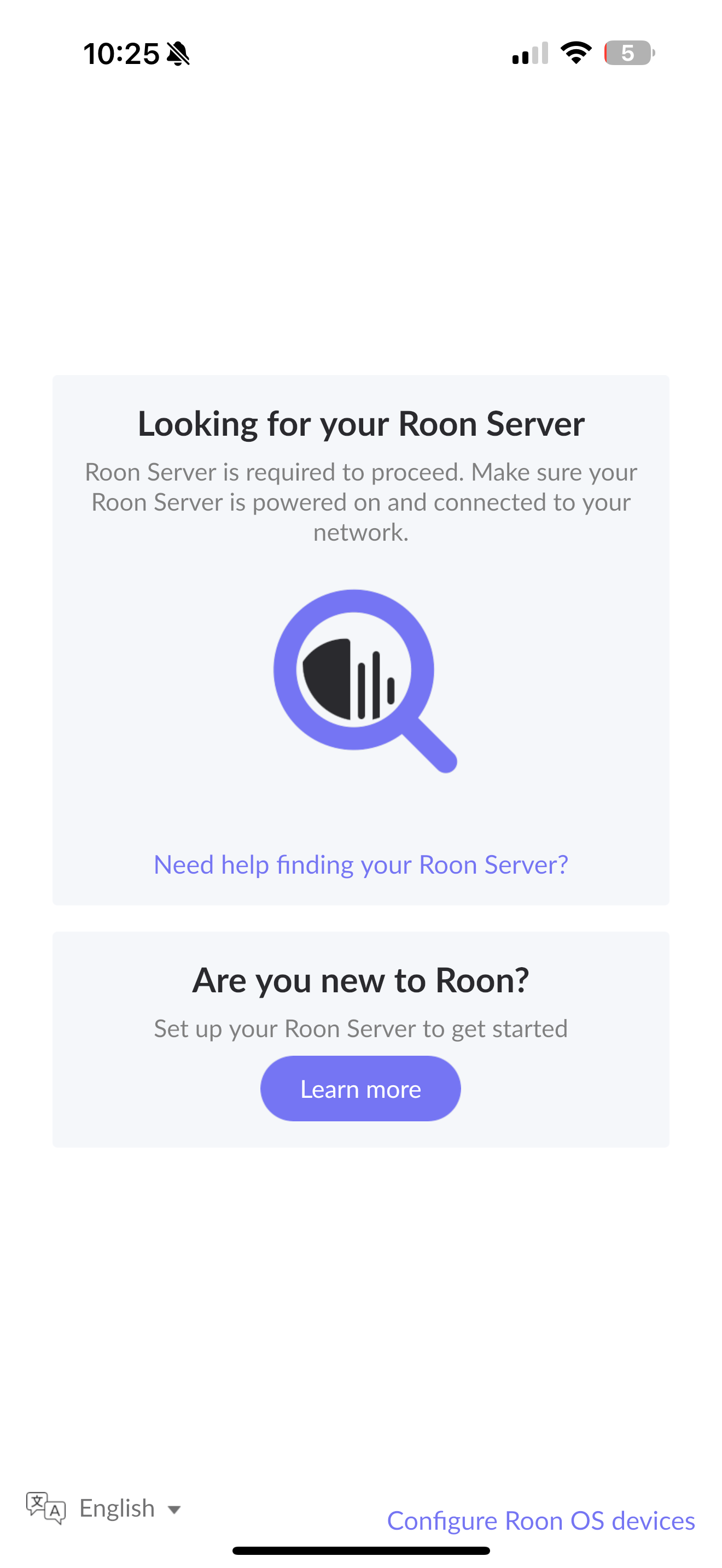

Is Roon Server running?
I run roon on nuprime evolution stream and dac. Everything worked just fine until now, I’ve might have clicked on a update window that appeared in roon app on mi iphone and since than I can’t connect to my streamer anymore.
5g router > switch > streamer > usb dac
Hello @awyrdyhazylp,
Thank you for reaching out to Roon Support.
From the diagnostic data enabled on your account, we can confirm that your Roon Server is up and running.

10/31 11:18:56 Trace: [1] [ipaddresses]    FOUND   z1br0 192.168.8.153
However, in the IP address section, we only see the network interface z1br0, which appears to originate from a virtualized or bridged network environment. Such configurations typically indicate that Roon Server is running within a virtual machine or containerized system (for example, Docker, QEMU, or a custom OS layer).
Please note that these environments are not officially supported by Roon. We recommend reaching out to NuPrime directly for further assistance with this specific setup, as they may have guidance tailored to their platform.
